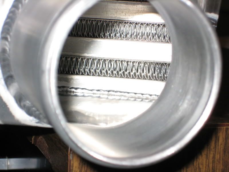

Most core manufacturers have gone to the staggered internal fin structure which has been proven to cool better and have better recovery times.
Garrett internal fin structure
Tradstone internal fin structure
China cores aka cx racing, godspeed, and many others
For shits and giggles i am including the japtek branded chinese intercoolers. On the left is the thinner core which is the same as godspeed, corsport, dpt, or your favorite ebay seller. On the right is the other china made intercooler which is the same Z1 BA.
If you look at both of the core internals you see which is better..
