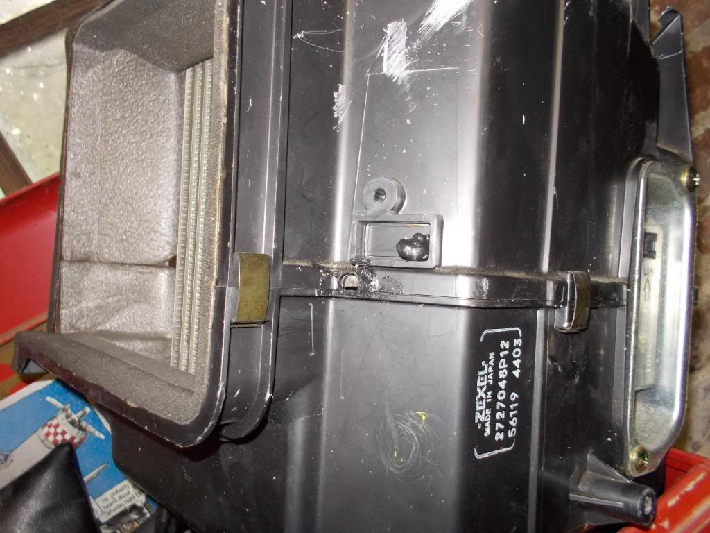

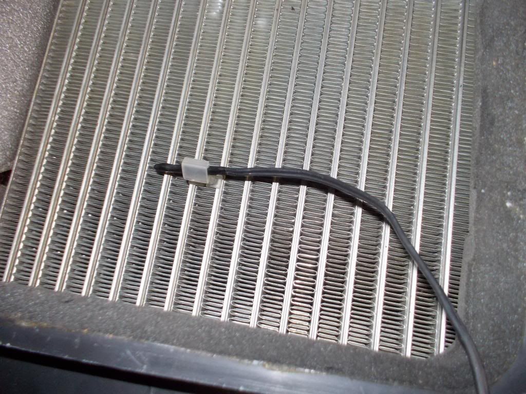

This pictures shows the hole in the parting line used to pass the lead of the OEM TCA in the Z32. The goo blob to the right is the seal. The TCA sensor tip is clipped by a plastic bracket inserted into the body of the coil.
