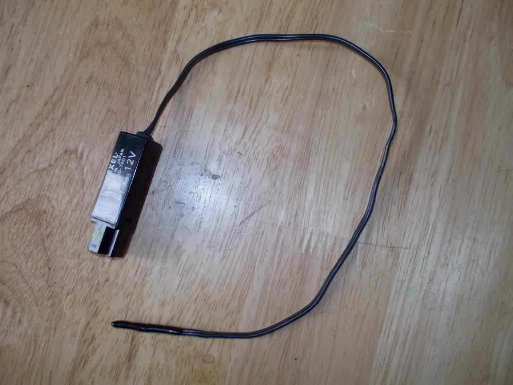

Left is one of the current thermo control amps used by Nissan. This little red one is used by the Xterra. Note that the sensor (thermistor) is short. The larger one on the right (photo taken with my camera) is the Z32 TCA. It uses a long lead and is clipped to the center of the evaporator discharge side. Look at the next post to see its location in the evaporator box.
