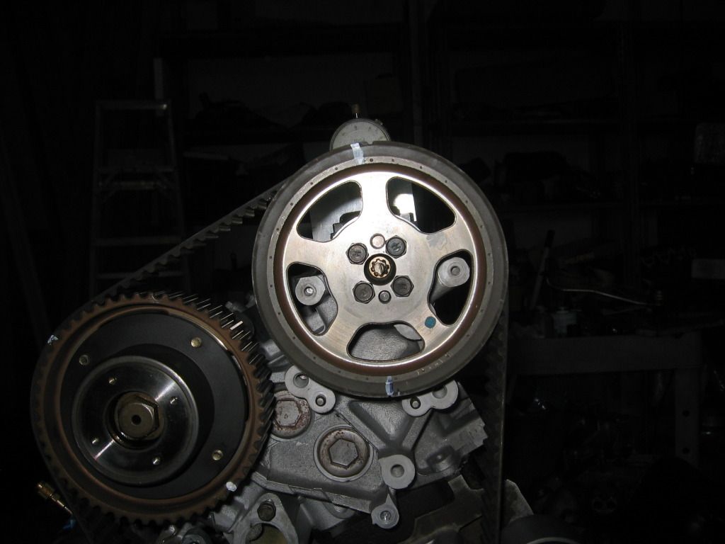

Message I ended up with Unknown heads on my NA re-haul.. the Drivers side was 1/2 tooth off, and the P/S was 1 tooth off.. the Pass Side was easy to fix.. just restamp the dot.. and move the Intake Cam on the Sprocket.. the Drivers Side I chose to Re-Drill the Alingment Pin 180* off, -the Needed Offset on the Exhaust Gear.. then just Adjusted the Intake Cam on the Cam Gear..
Drivers Side

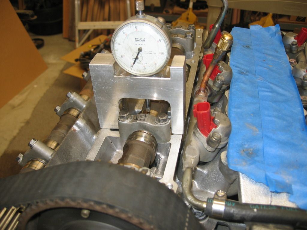

I was also lazy in setting up the Dial Indicator.. so I built a Fixture to make the job faster..
It reads the cam 180 out.. but that is a no brainer..
