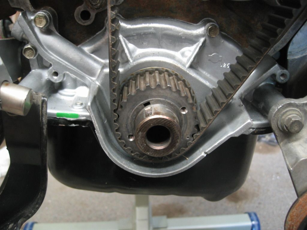

Message If this is on the Mark..
And the the cams are on the mark.. then your good to go..
EXCEPT.. when you set your ignition timing it'll be wrong.. Get a TDC finder ( Screw in the Spark Plug Hole ) and remark the Crank Pully.. Or get another one..
