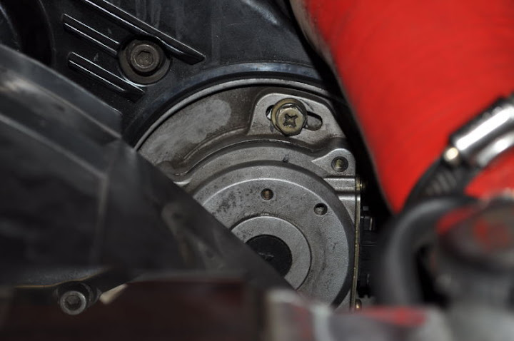

Message Just set my timing and I had to turn the cas a good amount counterclockwise to get 15°. FWWI I am using datascan to read commanded timing and two different timing guns confirm the timing. I keep reading that the cas should be nearly centered .... whats up?
