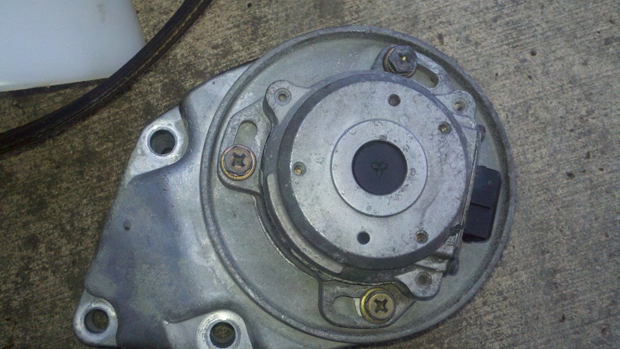

To verify I am not crazy, I referenced my old engine and the CAS position:
This was set right in the middle, right where it should be.

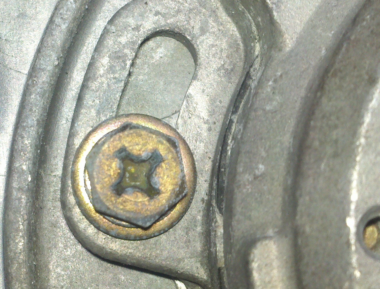

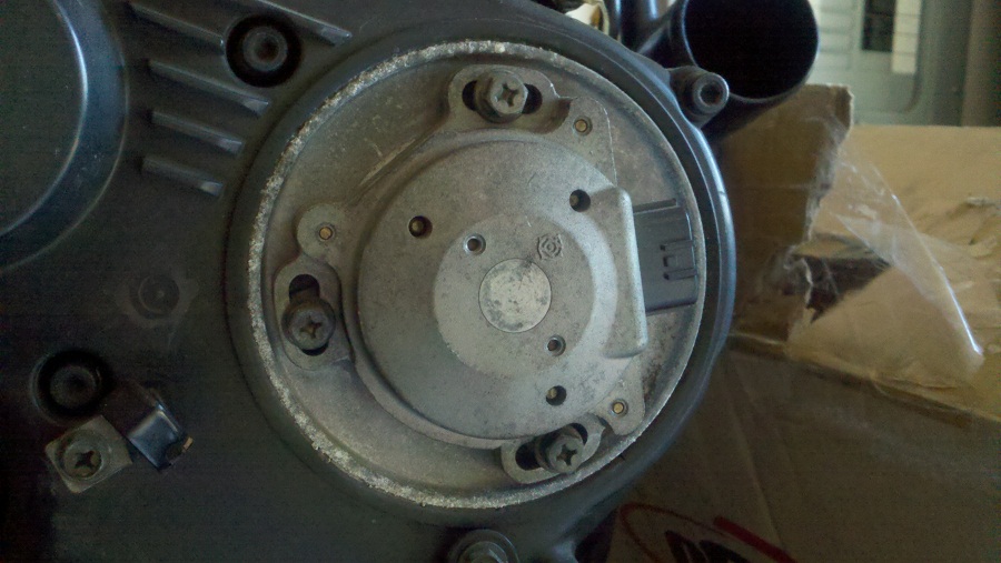

I took a closer look at the new CAS on the new engine. You can see where it was set before with the old timing belt. Look at the marks in the middle of the slot where is used to be set:
And where it is now:
What I keep telling myself is the timing is off a tooth.. yet every time I count I get the same exact numbers and they are correct. I am going out right after I post this to count them again. I am also going to have an assistant count the teeth for me.
