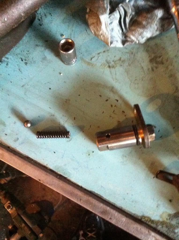

Start by removing the check ball plug, spring, and check ball. Then remove the interlock stopper. The plug is in red, the stopper is in yellow. If you remove the stopper first the ball will fall into the case and you'll be looking for it later. There are different size ball bearings for different years of transmission. Keep the assembly with the gear box it came from.

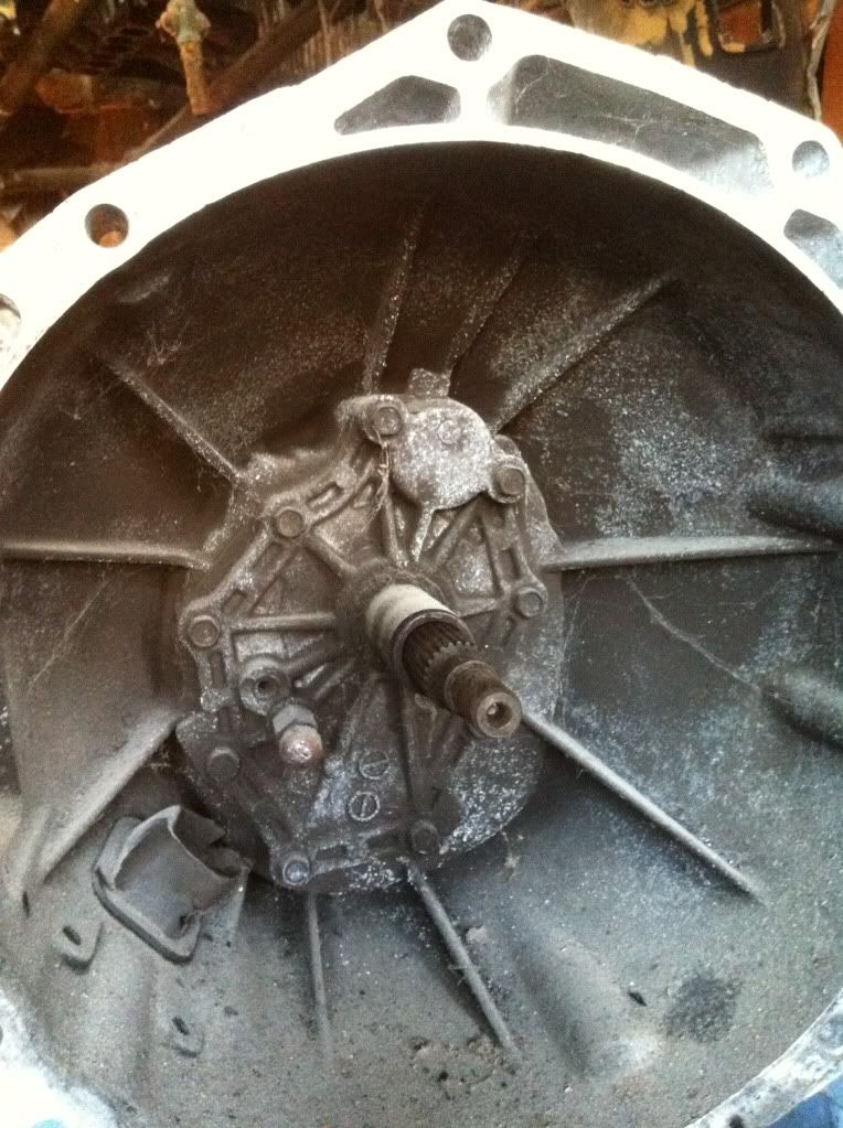

Remove the front cover and gasket via 9 12mm bolts. Use the chisel or a flat head screw driver to remove. Come in from the clutch fork opening to get a good angle for removal

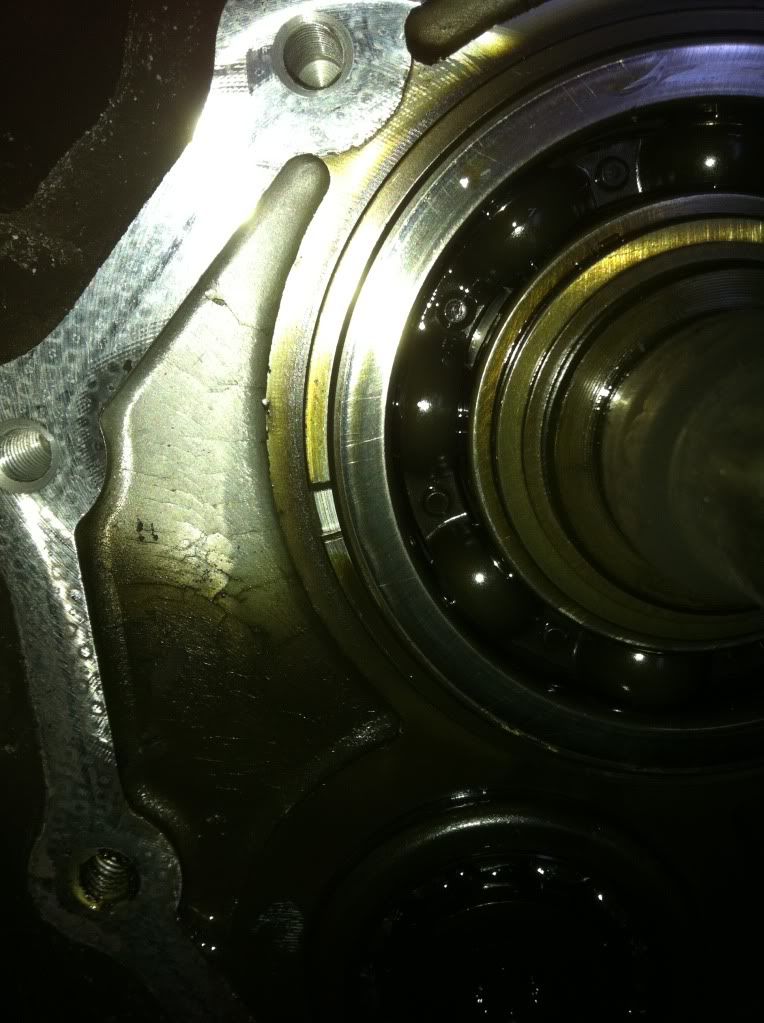

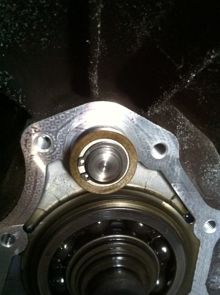

Remove the stopper snap ring and ring and the main drive bearing snap ring.
Stopper snap ring and ring
Main bearing snap ring

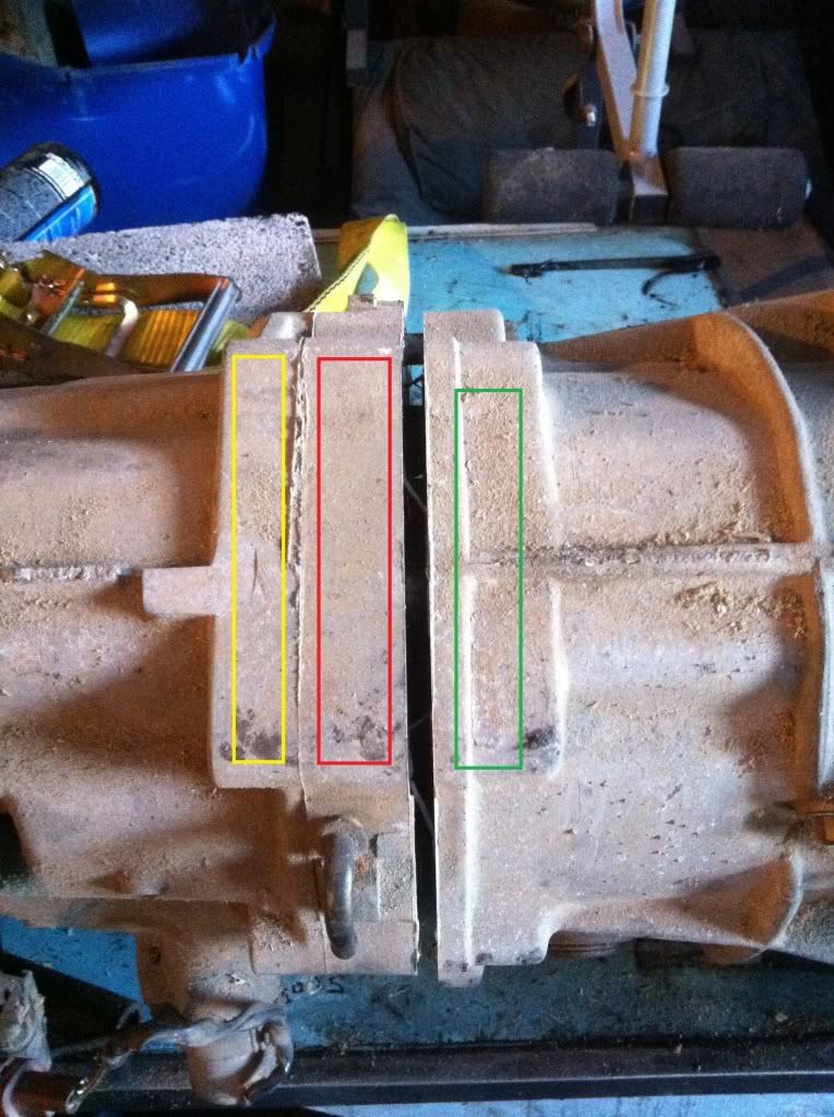

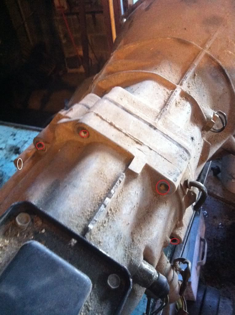

Then remove the 12 14mm bolts holding the bell housing to the adapter plate, and rear extension.
Rear extension yellow, adapter plate red, bell housing green
The bolts to be removed. There are more as you go around that seam.
Tap the bell housing with a dead blow hammer and pull it apart. You may need to get the chisel and lightly separate them. I say use the chisel because it is wider and less likely to mess up the mating surface.
