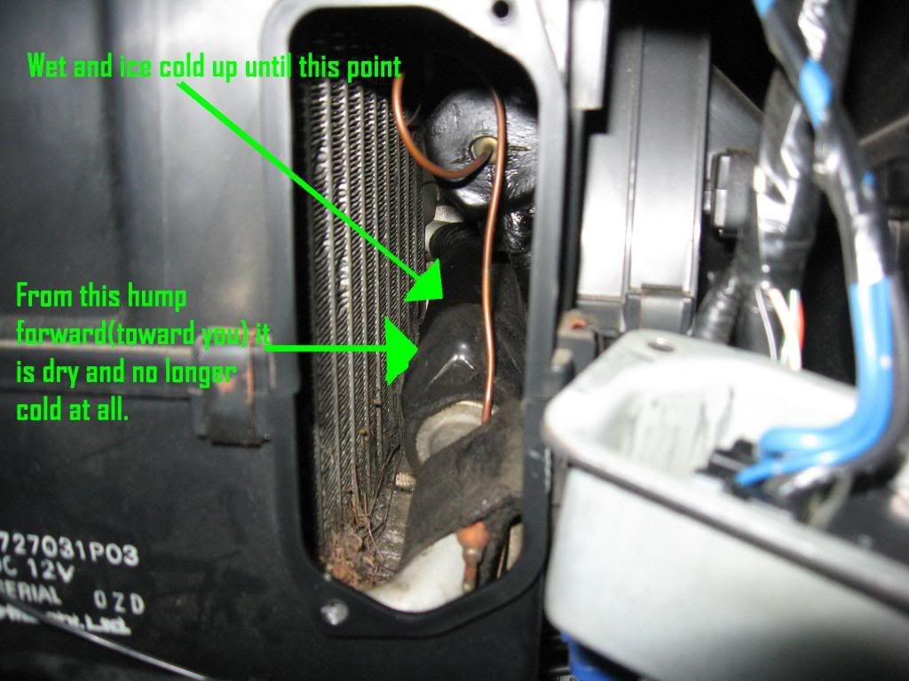

Next I removed the glove box as well as the blower resister pack and found that I had a clear view of the ac evaporator. First thing I did was reach in and touch the evaporator...room temp...dang. Next I look closer and notice that there is condensation building up inside around the large pipe to the right of the evaporator. I reached my hand in as far as possible to touch the pipe. It was ice cold!
Next I slowly pulled my hand out while running my finger along the line and found that at the hump in this line(not sure what this is) it went from ice cold to room temp just like the evaporator. Whatever this thing is it seems to be what is stopping the freon from passing through the evaporator.
Now I am at a loss on what to do. I could convert to 134a but considering what I have found I don't believe it would make a difference.

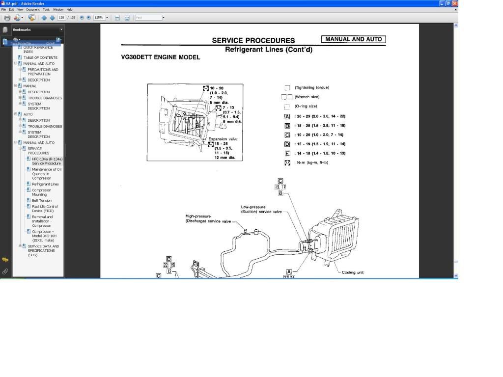

Found this picture in my 95 fsm. It doesnt exactly match what my evap box has but my z is a 91...perhaps it is slightly different.
