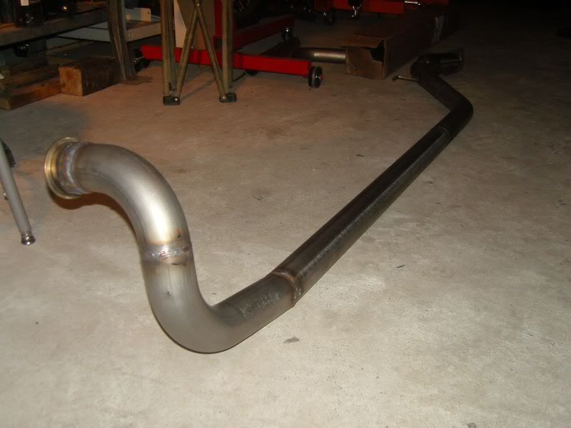

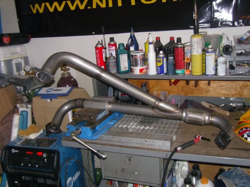

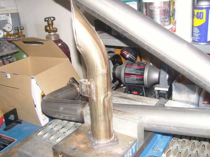

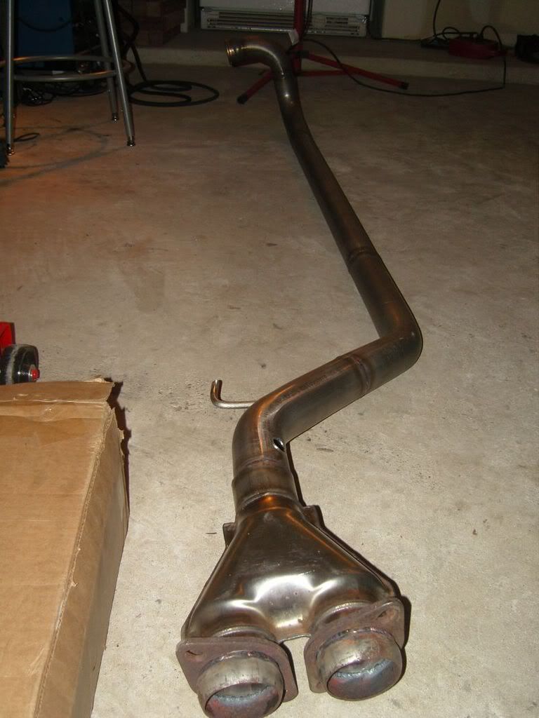

Message Just a quick update.

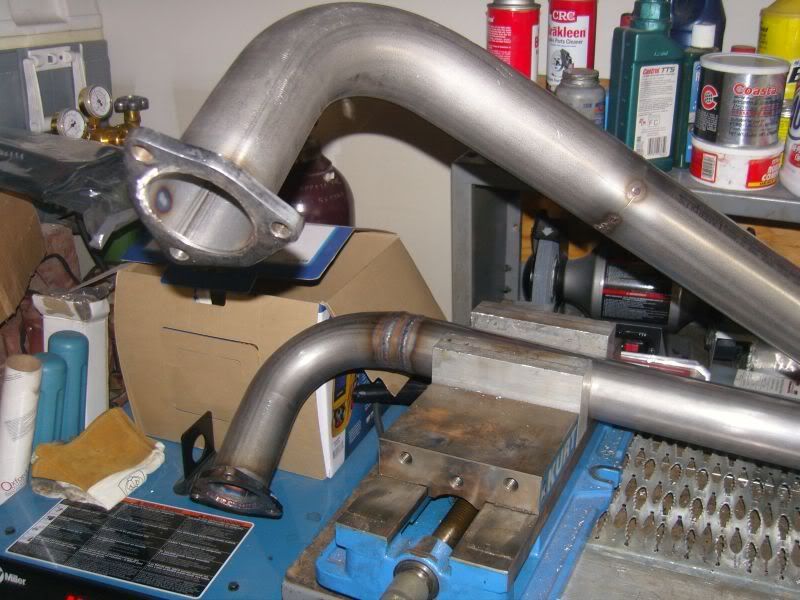

All the hardpipes are complete....damn that was harder than i thought..

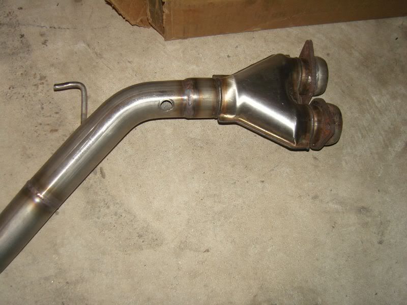

In one pic you can see a hole in the pipe this is the position i welded the wide band bung.

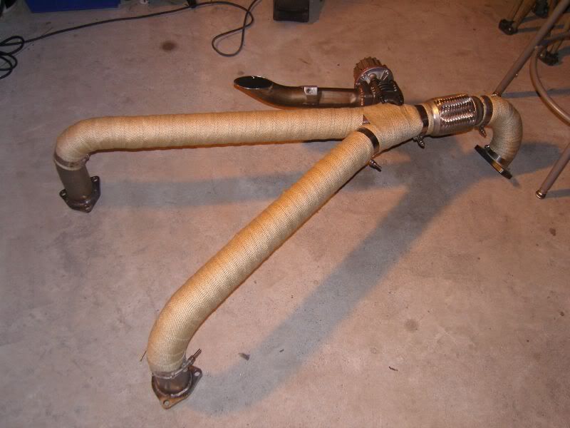

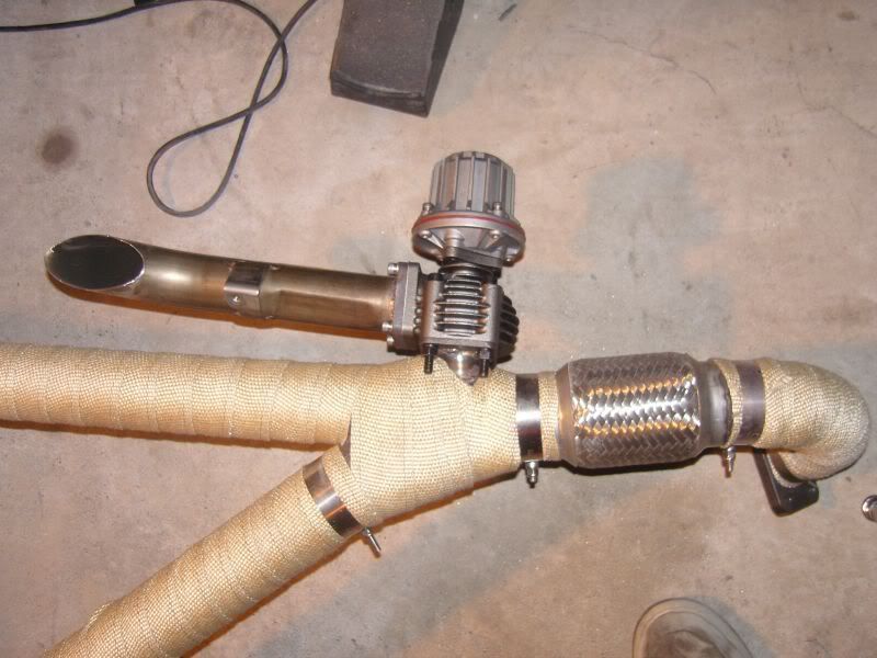

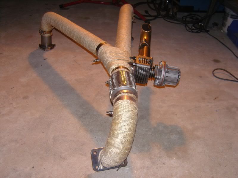

Also the long return pipe is completely wraped.
I have to make some heat shields to deflect the hot air from the radiator, this i have some 20g stainless sheet with some high temp insulation to help.
