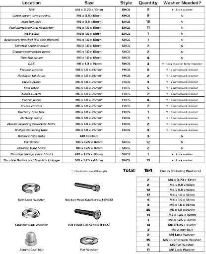

Here are all the significant nuts and bolts which you may want to replace with stainless steel. For under the coil packs and balance tube nuts and bolts, I use a 3/8" fiber washer from Home Depot to protect the paint and powder coating. If you use a thicker flat stainless washer, you'll need to add 2mm to the length of those bolts.
Hope you find the list useful! But be careful installing, remember, stainless steel isn't magnetic :-O
