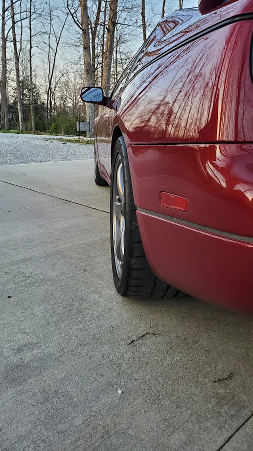

Message you can see where they sit in relation to the fenders.
The above pictures are just after I dropped the car off jack-stands, so the suspension is sitting just a little high.
Also, I was wrong about the wheel sizes, here's the correct info:
Front: 18x8.5 38 offset 225x40 R18 tires
Rear: 18x9 38 offset 275x35 R18 tires
I think the front tires look a little stretched, and might go with 235x40s next time.
I also think the rear tires rub a little on high speed dips, so I might try 265x35s next time to see if it eliminates the rubbing.
