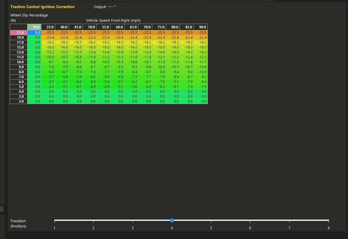

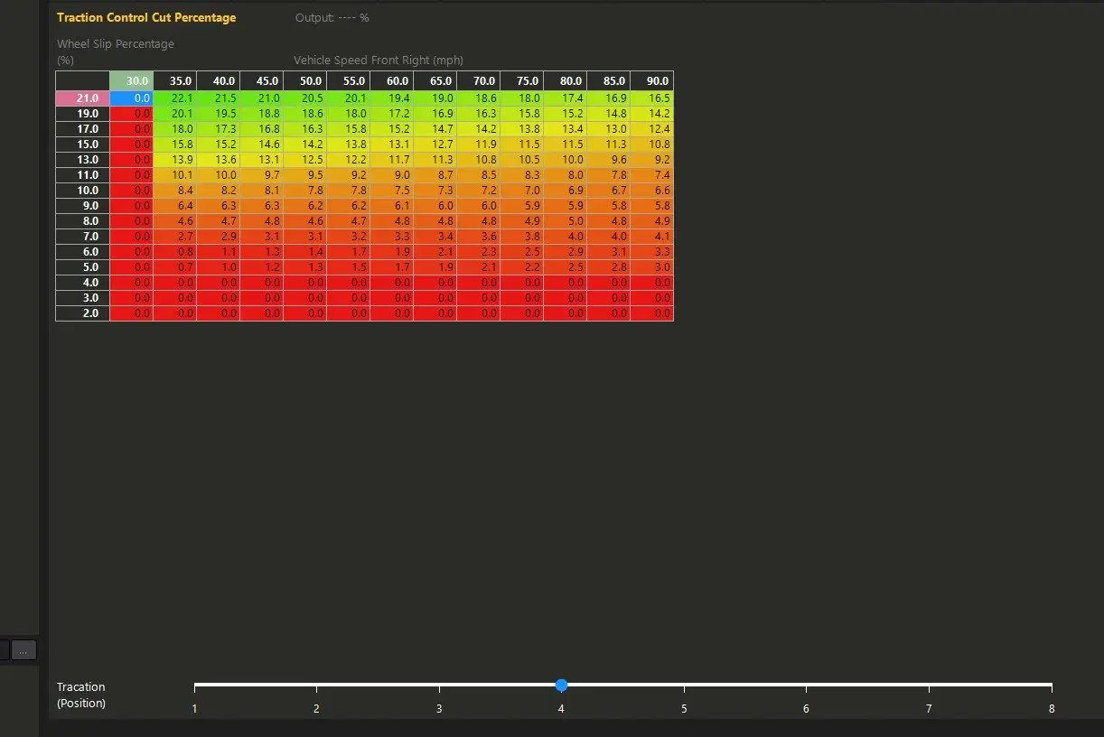

Here’s an example using just cylinder kill and ignition retard based on slip, with adjustments by MPH so I can make it more or less sensitive at different speeds.

The logic is speed vs slip percentage and then the data in the table is the amount of intervention at any given point. Super simple.
I also like that I can specify slip based on MPH—20% slip at 30 MPH, no biggie... 20% at 100 MPH, terrifying.
