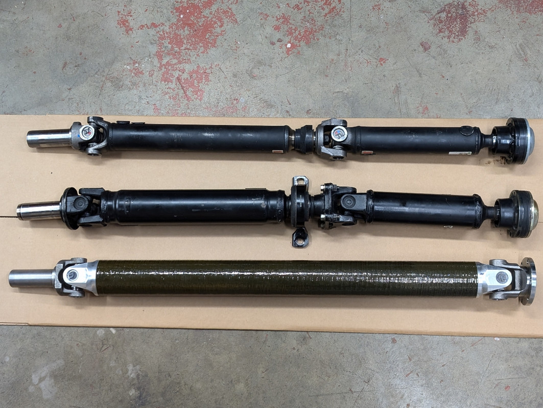

I had always dismissed the carbon fiber drive shaft as being too expensive and only for extreme builds. I've scrolled by it tons of times on CZP's site thinking "Who's buying that?" But after all the time and money already spent trying to resolve this issue, it was me who was buying that! $1,600 later and over a month of build time, the carbon fiber driveshaft arrived and finally resolved the issue.
After a month+ of driving which included a 6 hour road trip and total of 800ish miles, I've been really impressed with the results. The 40mph vibration is finally gone, and accelerating from 80 to 100mph now feels nearly identical in terms of NVH to accelerating at lower speeds (20-40mph). Highway cruising 80+ is noticeably smoother and more comfortable too. I’m really happy with the carbon fiber driveshaft.

Newly received CF DS Goodness
New CF DS vs OEM 2pc vs Aftermarket 2pc w/ shaved CSB

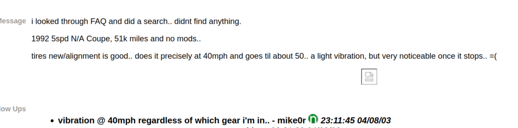

Here are some interesting posts from around the web, all sharing similar experiences. Tons more posts about z32s and 40mph vibrations too, below is just a small sample.
