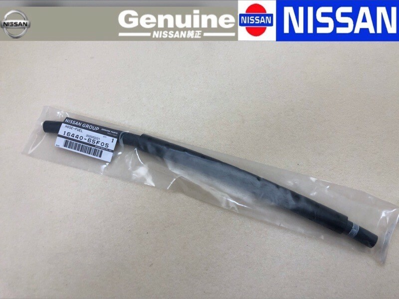

Message Nissan uses that type of hose protector on other models, Infiniti J30, R32 GTR etc. You can try and find something that is long enough or can by trimmed to fit.
For example confirm w. CZP if long enough:
https://conceptzperformance.com/nissan-infiniti-nissan-oem-fuel-hose-rb26dett-16440nb-nissan-skyline-r32-gt-r-16440-05u04_p_55584.php
or
You can use bulk hose and use a wire loom or protector over it, my go to is this solution:
