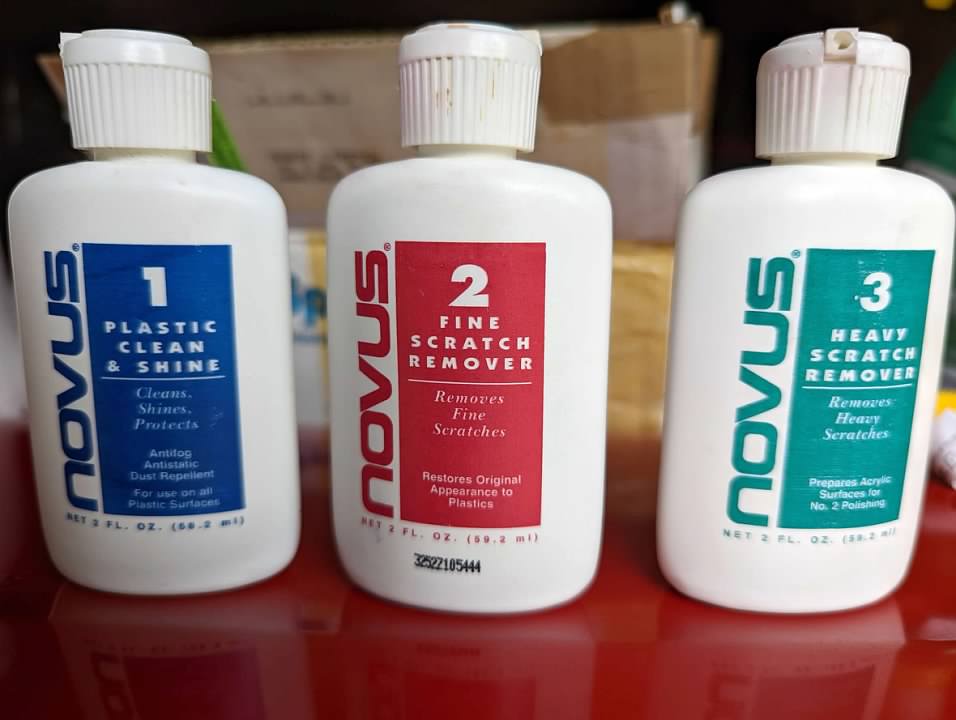

Message I found my Novus plastic polish. Number 1 is liquid like water, Number 2 a soft cream, and Number 3 a paste.
I was getting good results with the Number 1 which is the least abrasive, but for that last ten percent of improvement I moved up to the Number 2 and then 3. In retrospect, that created a lot more work. After the Number 3, the bumper was hazy after buffing. Black300zx also warned me about that haze when buffing a red and not a white bumper.

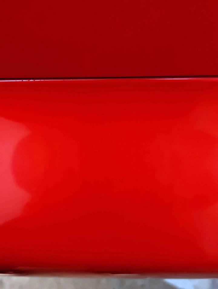

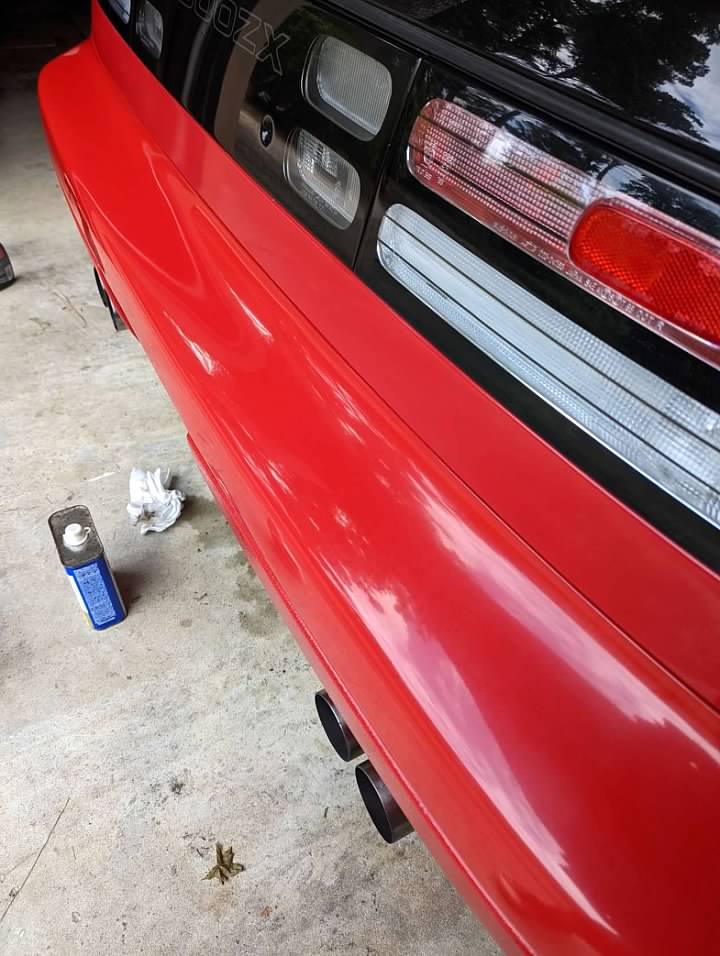

After a lot of elbow grease, and working my way back down to Number One, the bumper is nice and shiny again. Then, as I also mentioned before, the Turtle Wax Express Shine Spray Car Wax added further improvement. I will definitely be buying more of that product.
The close up foto of the bumper is in the same spot as the foto in the original post.
The bumper never looks great for long because the soot from the exhaust gets on the bumper almost instantly. Check out the foto of the inside of my garage door which was closed for about 5 seconds on a cold start. That is the exhaust “fingerprint” of quad tips, jajajaa.
