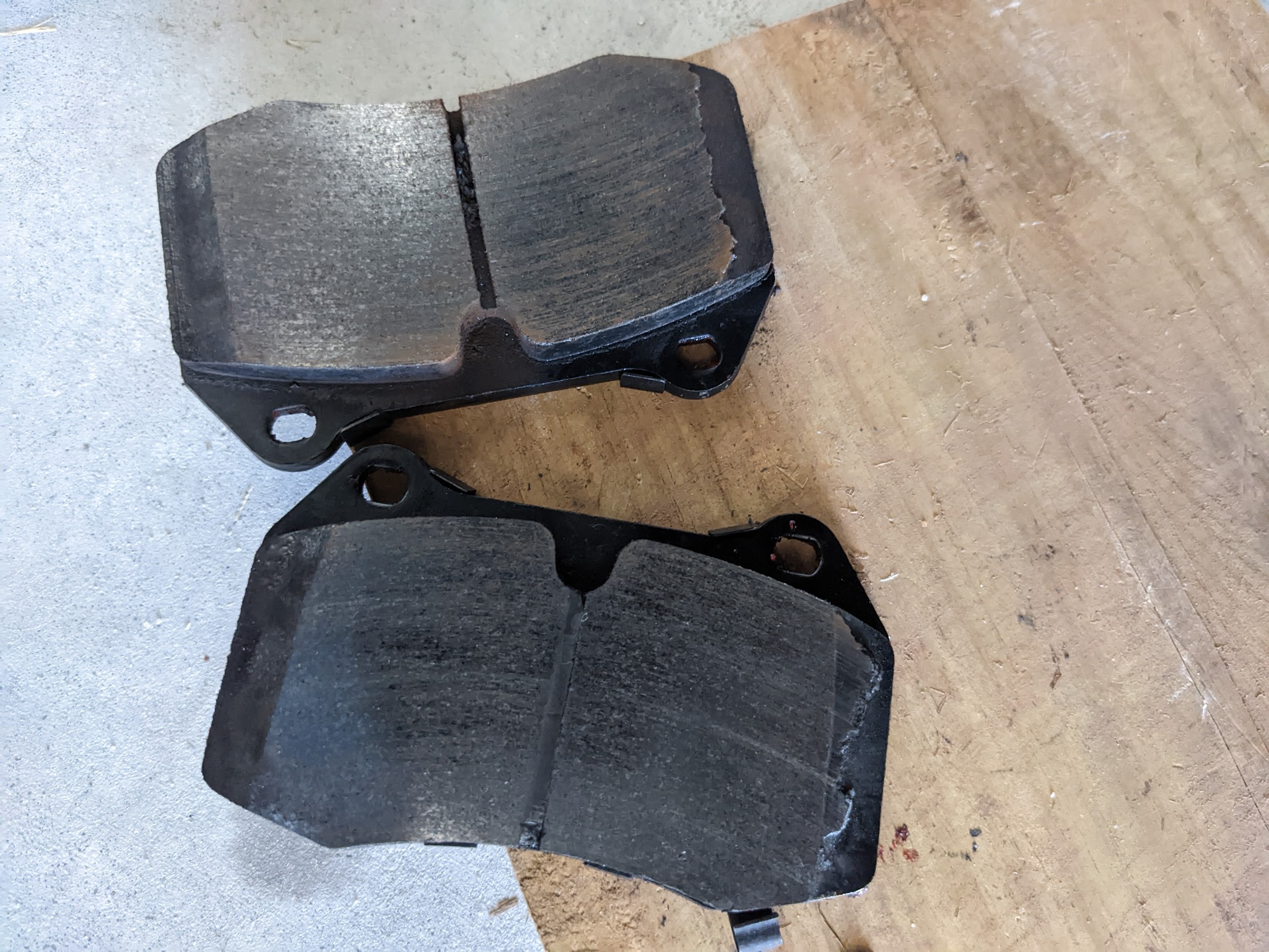

See pics below, I think I see what the problem is.

Scrap everything. Start over. All new brakes and rotors. (n/m)

Your rotors need to be turned. (n/m)
09:19:51 08/30/22
I always thought slotted/cross drilled couldn't be turned.

What do you think about the piston contact on the shim/pad?

I believe your calipers and pistons to be beyond repair

I see one layer of black powder coat, nothing else.

Those are 350Z Brembo calipers. Are you guys all smoking it? (n/m)
21:25:49 08/30/22
Calipers and pad position looks fine.

More info., this whole setup has maybe 50 miles on it.

The big fat rust spatc on the rotor needs to be cleaned off.
08:09:27 08/31/22
Also clean all that red grease off of the pads - its likely
08:11:30 08/31/22
I thought the red stuff was Disc Brake Quiet goop (n/m)
