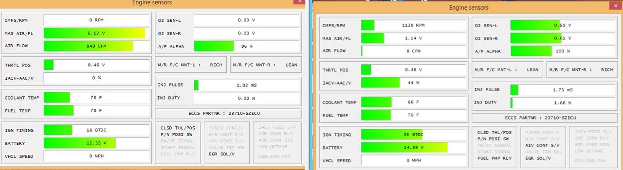

Today I managed to capture the MAF voltage on ConZult when it was acting up and then running smoothly - This was within a few minutes and without any actions aside from re-starting the car.
conzult

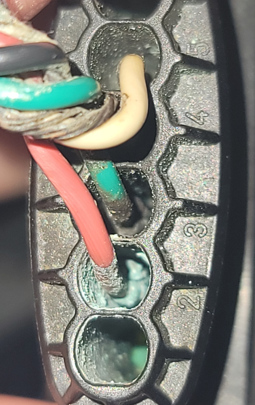

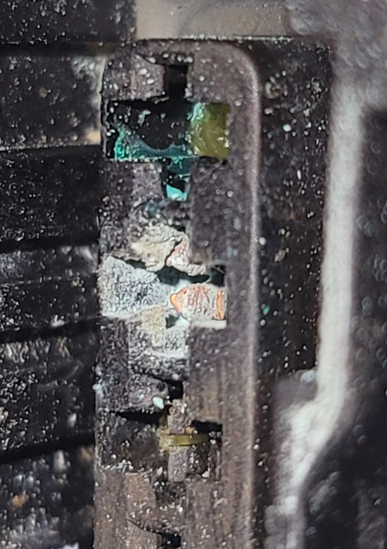

So with a hunting idle, the MAF voltage read 5.12v! Once I restarted the car, the MAF read 1.14v and everything settled out. It appears that moisture is getting captured under one of the MAF boots and causing a short between the red and bare wire - though I would not be surprised if it was shorting across multiple points.
back
front
I've tried to contact Jim at jims@selindesign.net regarding issues with his product, but it appears that he has moved on or is too busy...
While I have certainly gotten my use out of this device, running it since 2010, I'm not going to continue to depend on a product that is no longer available- Never mind not being supported. I can attempt to repair the connector, but that doesn't solve the issue of running a non-replaceable, single point of failure configuration.
