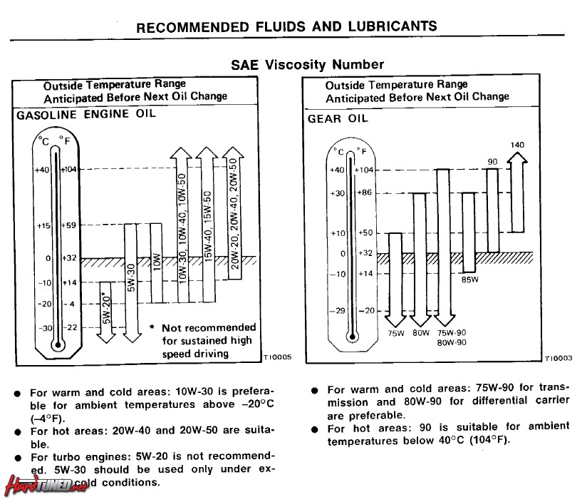

Subject FWIW MT-90 is the correct weight as spec'd by Nissan.

Message We would blend MT-90 and MTL (75w80) to basically make MT85 in cars with 3-4 shift issues before it was released. MT-85 hit the market in the mid 2000's when Nissan started to use 75w85 weight trans fluid in the 350Z and beyond.
Nissan's 75w85 is 999MP-MTF00NP (old PN 999MP-MTF00P)
