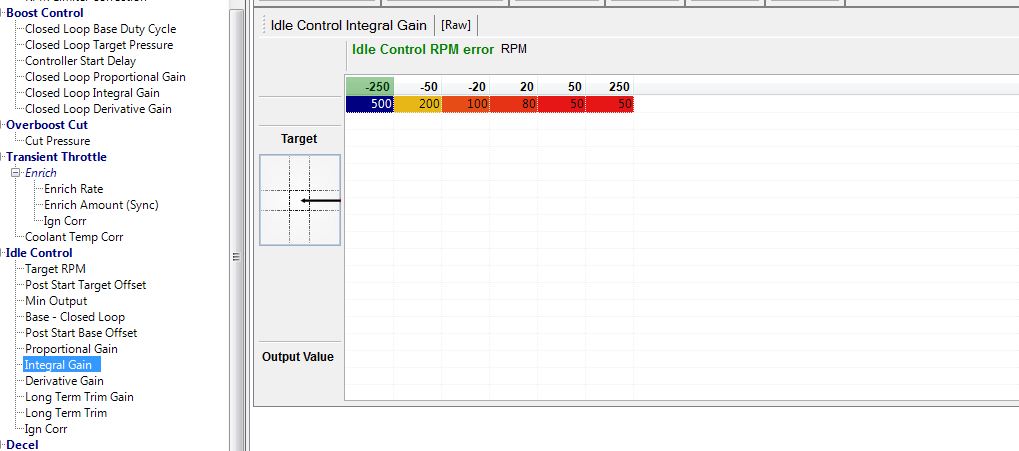

idle control example:

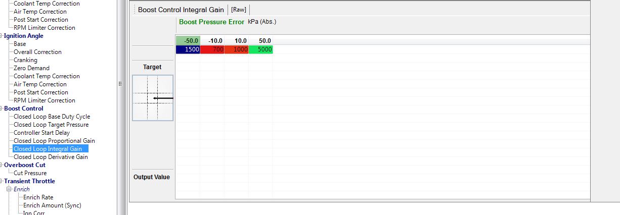

boost control example:

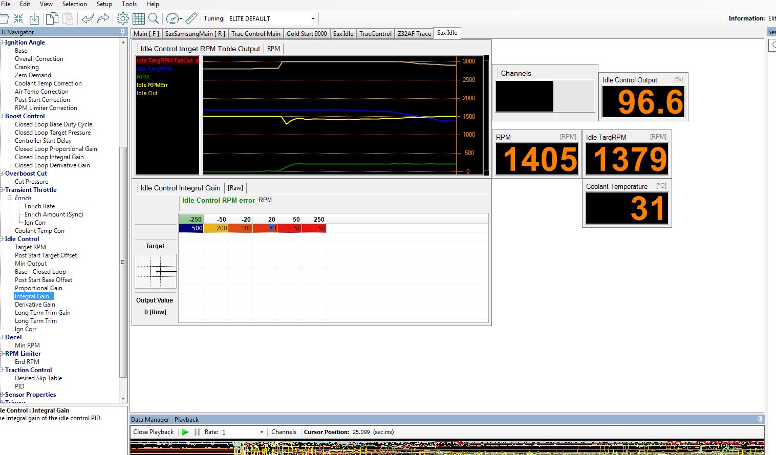

So when I am setting anything on the car I just have a pre built page that shows all of the relevant data including the gain for each channel of PID
Here is a rough sketch for when I am setting up idle. I can hit the throttle really quickly and then look at the out puts for each channel and the reaction time and make changes to sensitivity as needed. So I am not doing it blind. This system allows me to get to the correct answer....maybe just not the right way :)
