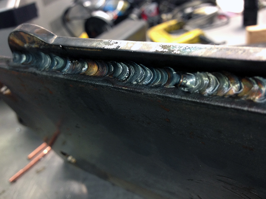

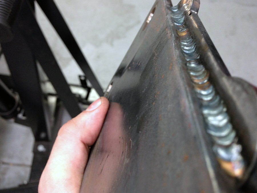

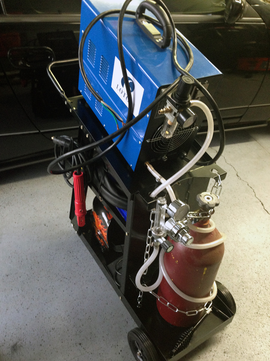

Since then we have been making progress as time allows. One of the biggest bottlenecks in the process has been fabrication. Prior to this project I had never welded. So after some research on the interwebs I picked up a 3 in 1 watched a couple of hours of you tube videos and got started. I still have a lot to learn but am functional at this point.
Also, some items in the pics are mocks up only and I will be going to back to properly reinforce / clean up
Welding rig:

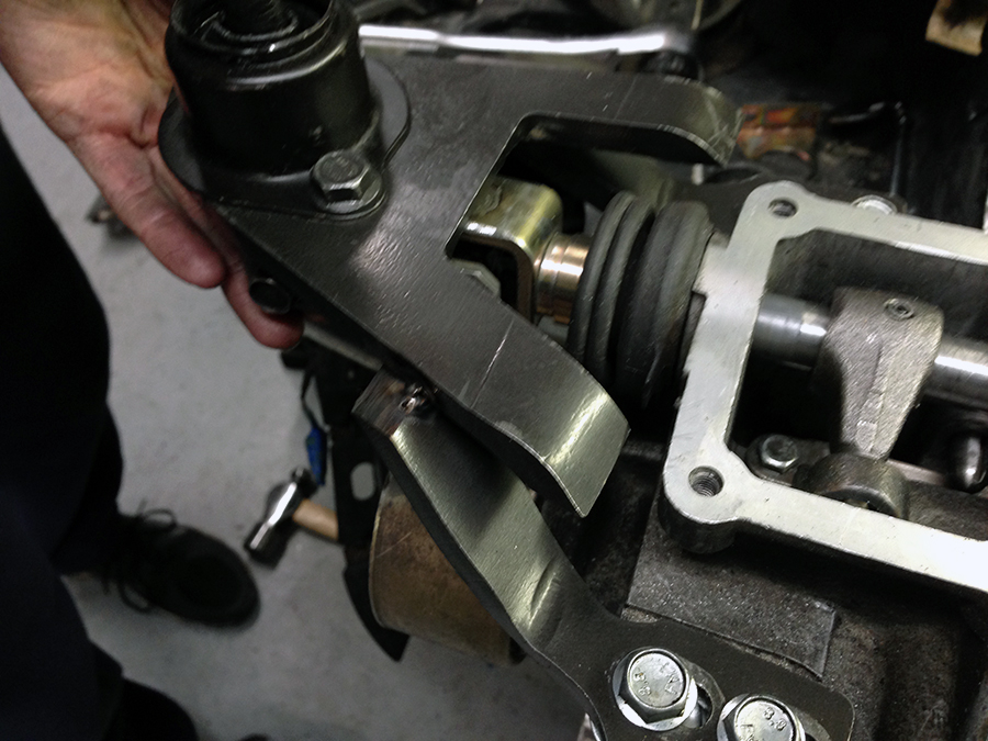

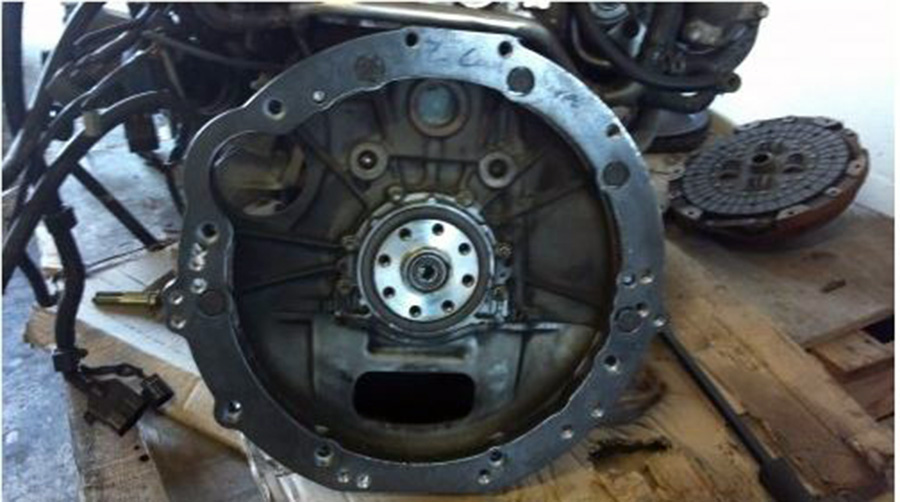

The collins adapter so we could keep the Z trans

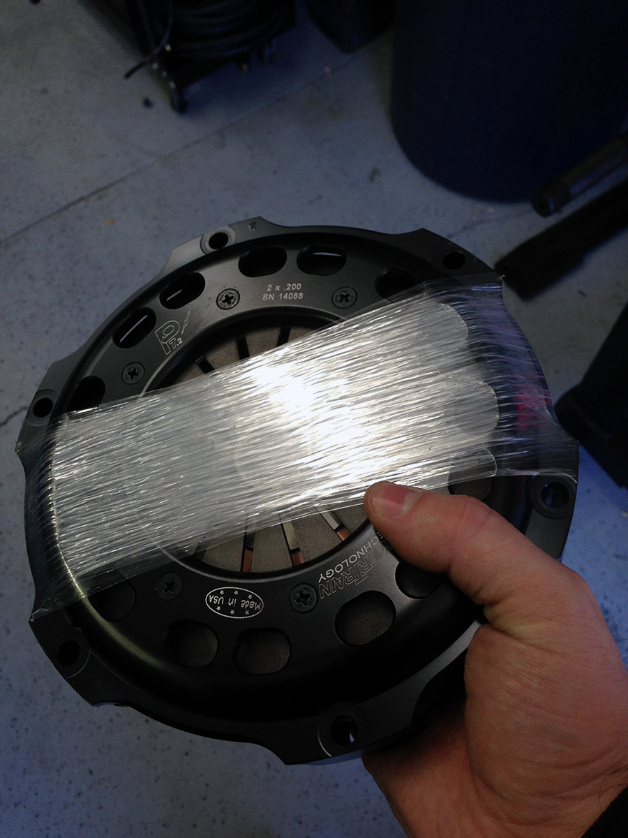

Clutch that came with the trans kit. Amazing how small it is.

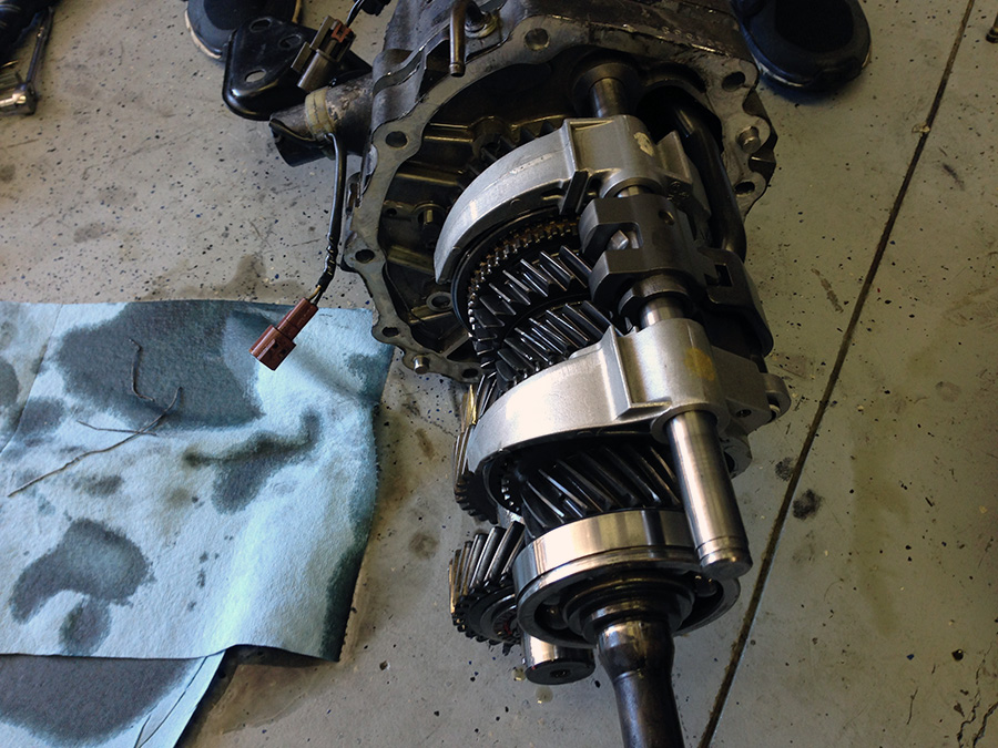

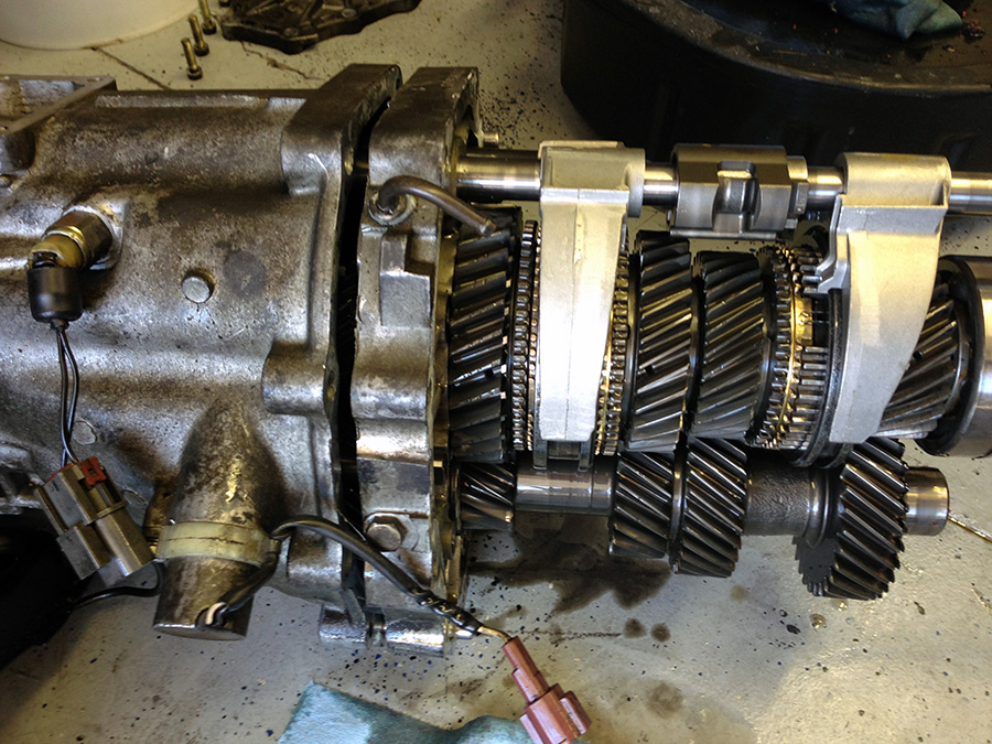

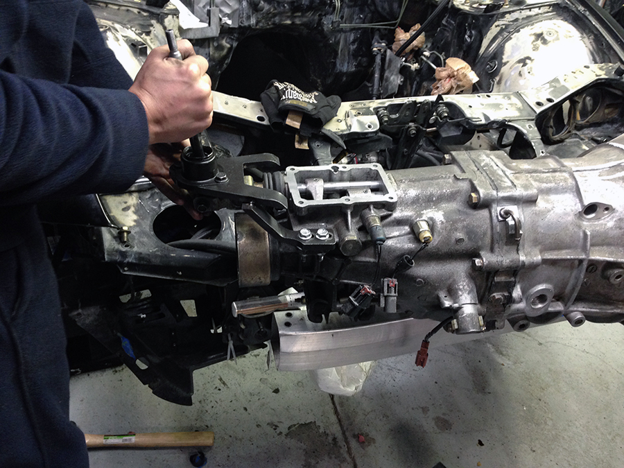

Trans had to come apart for some minor machine work

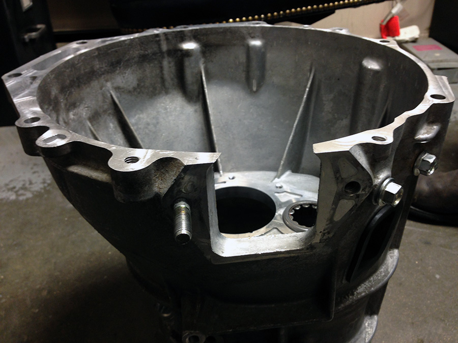

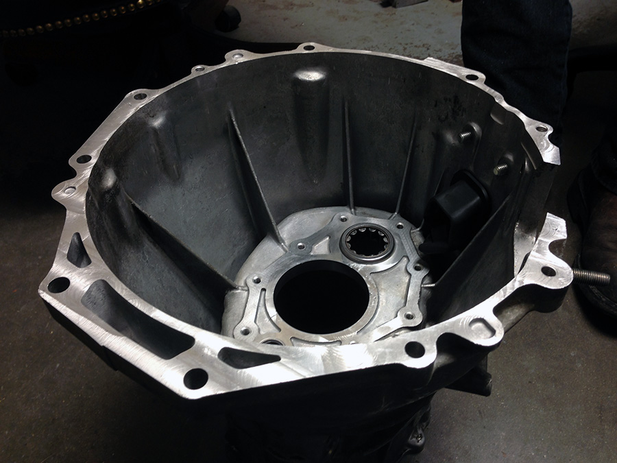

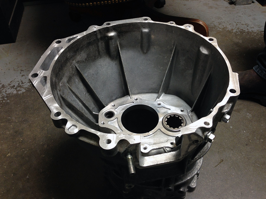

Had the bell housing machined to work properly with the adapter

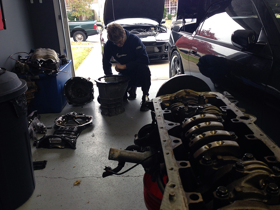

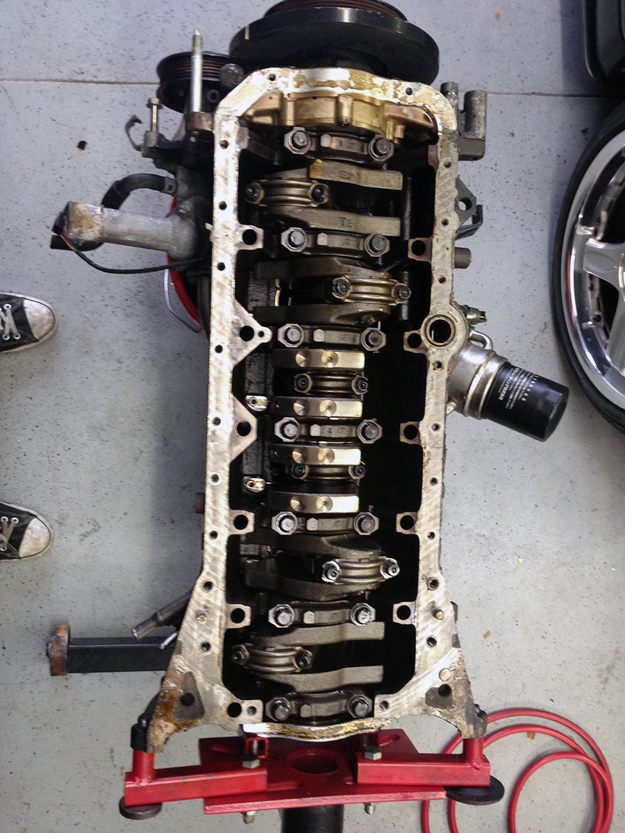

Started prep on the 2J

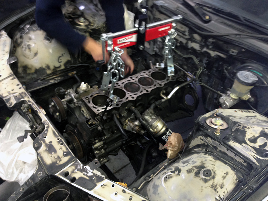

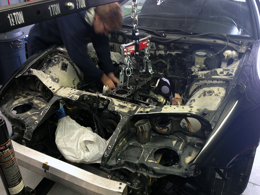

More test fitting

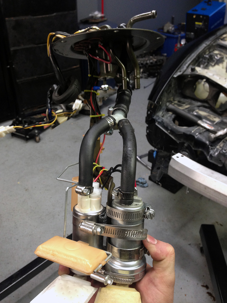

Dual fuel pumps internally bridged
To give you a proper idea of how wide the Z engine bay is :)

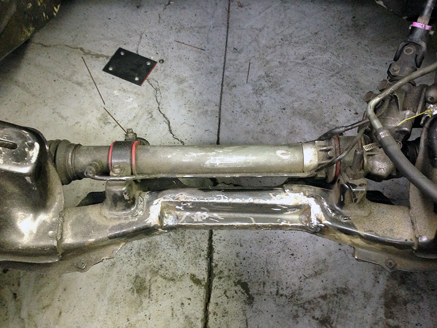

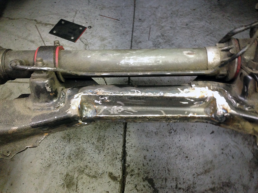

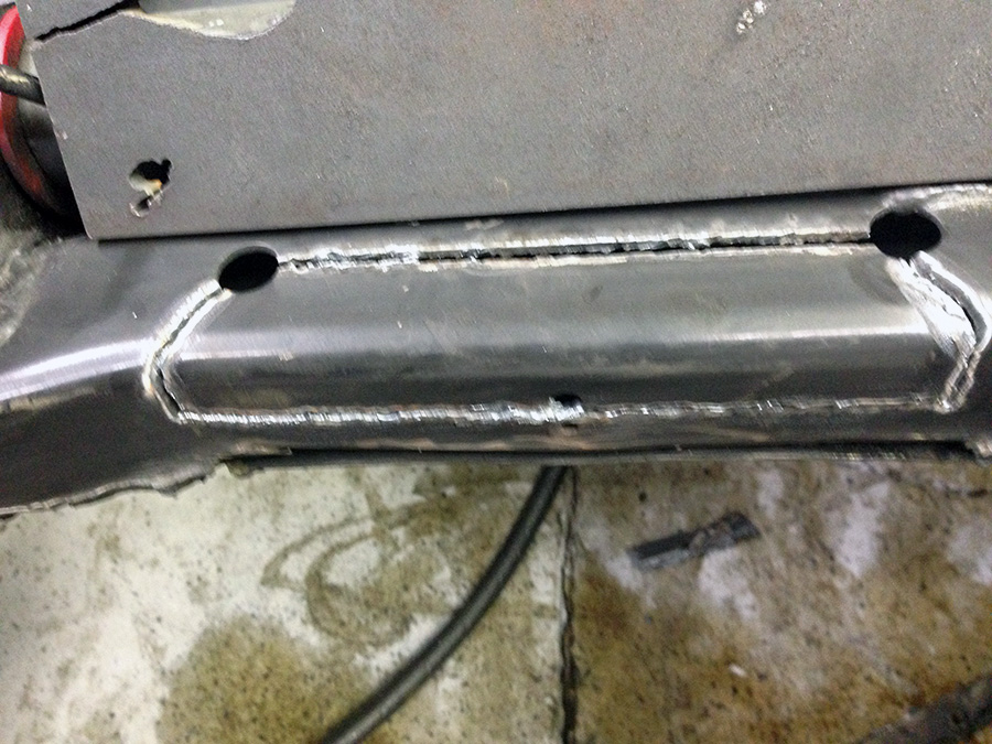

Cross member work

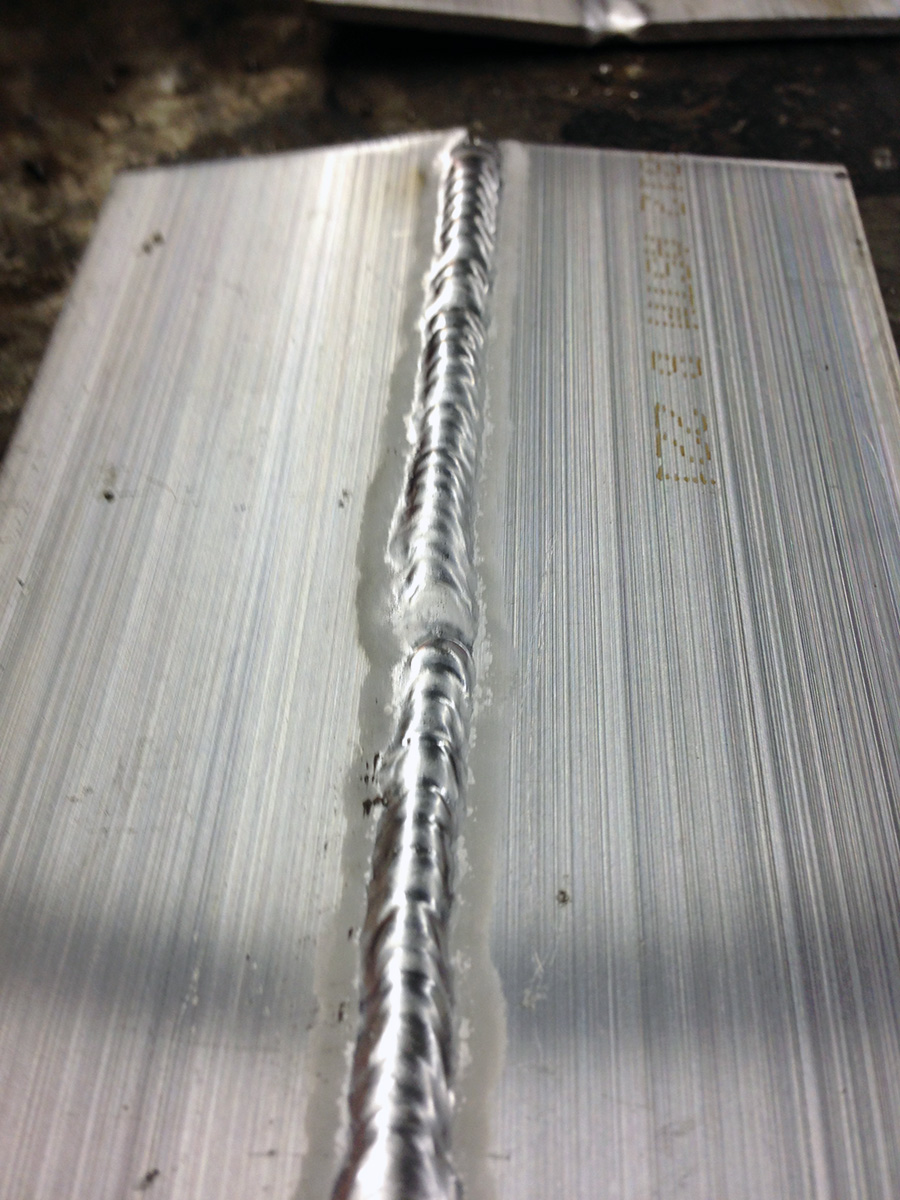

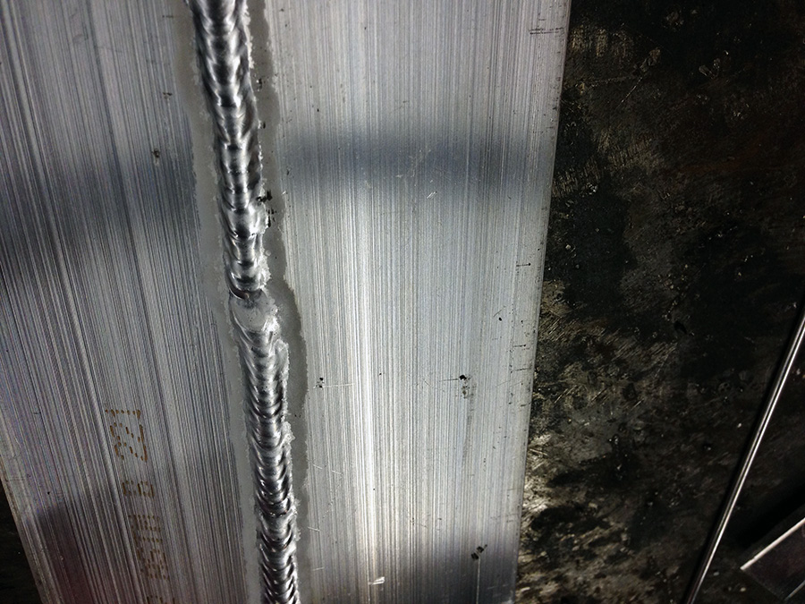

practicing my weld skills on aluminum

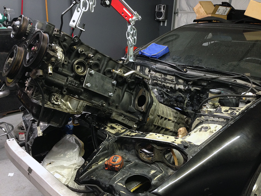

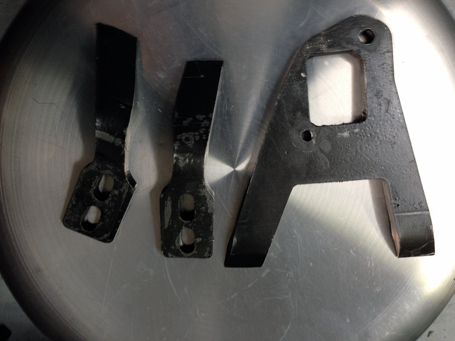

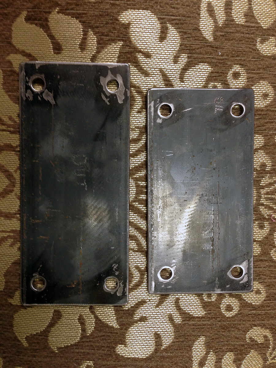

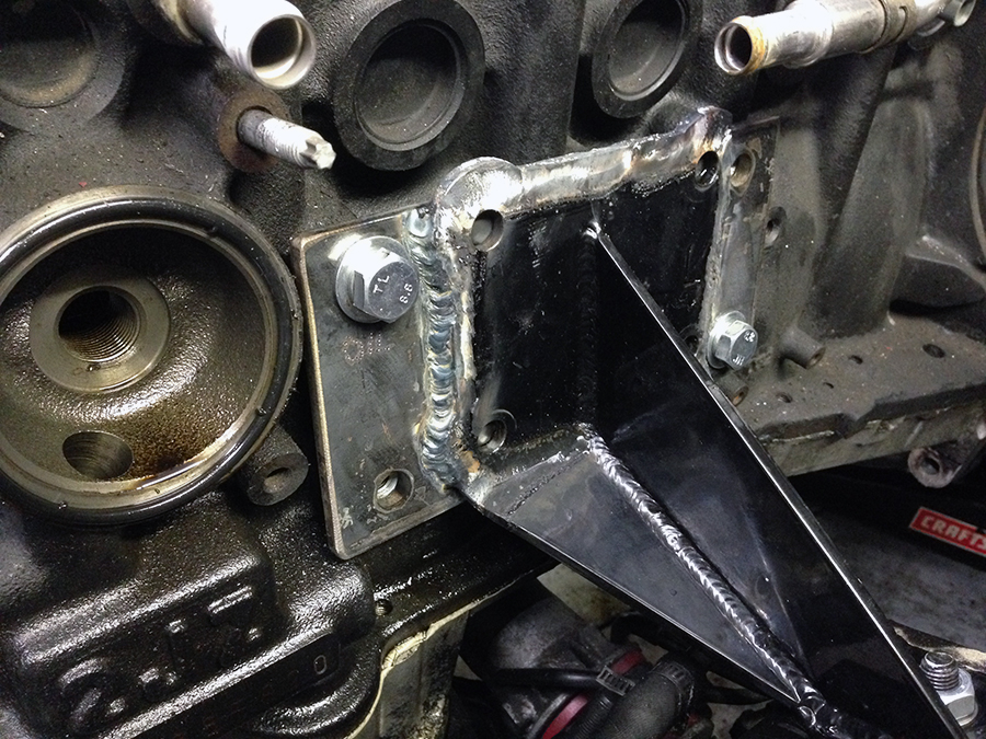

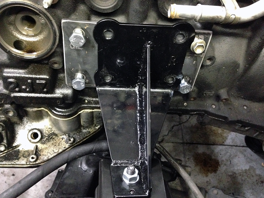

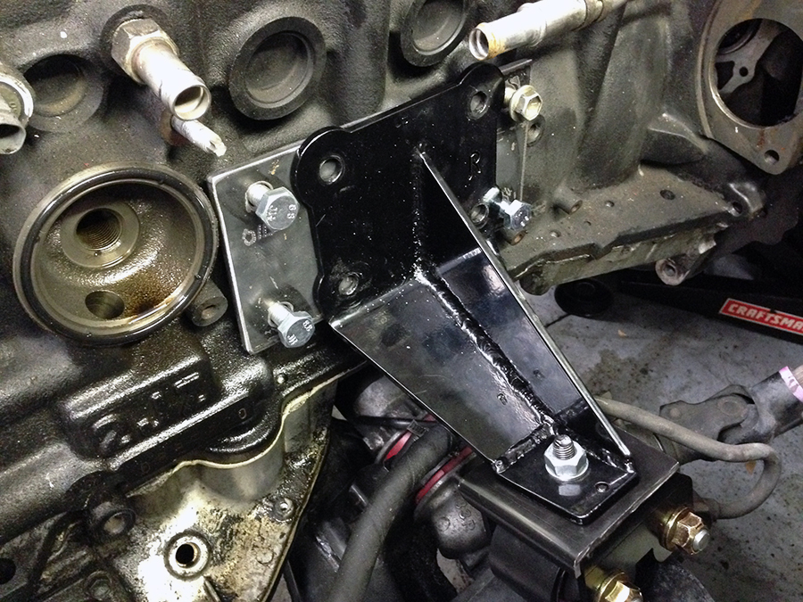

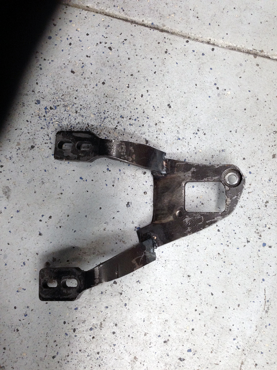

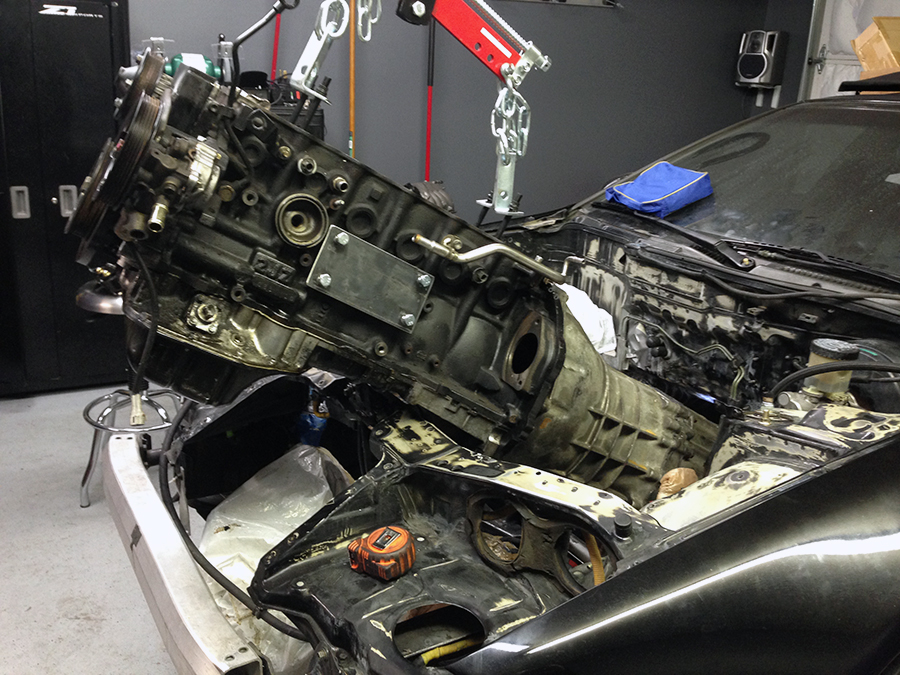

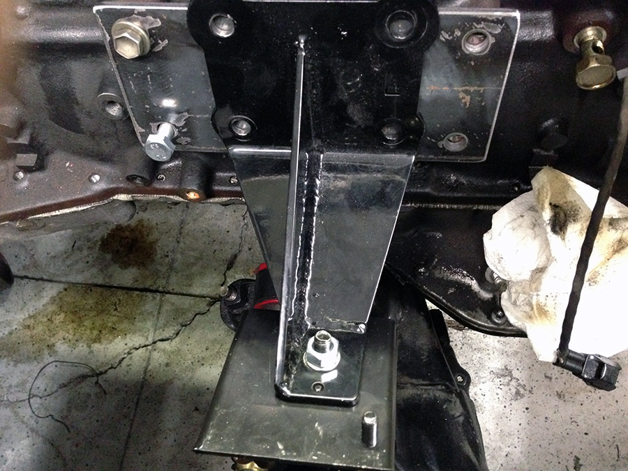

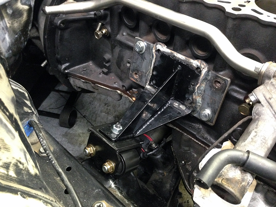

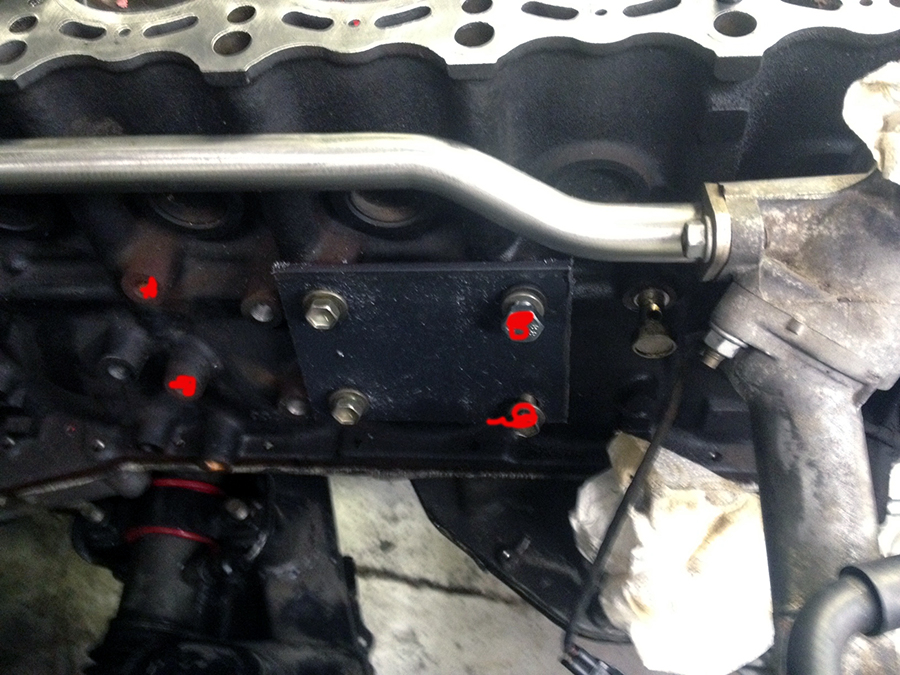

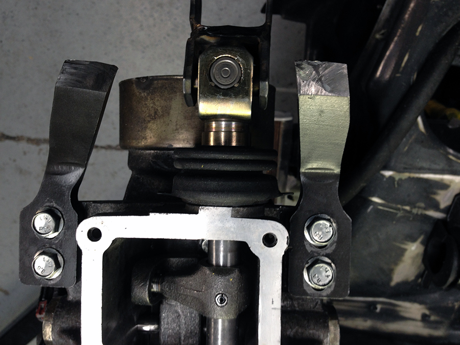

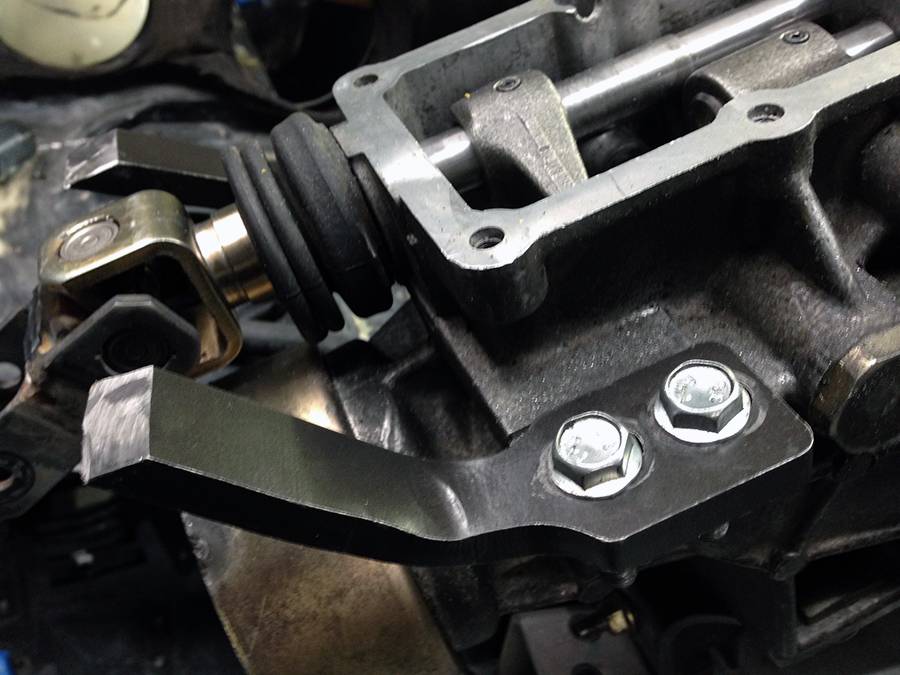

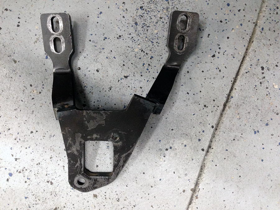

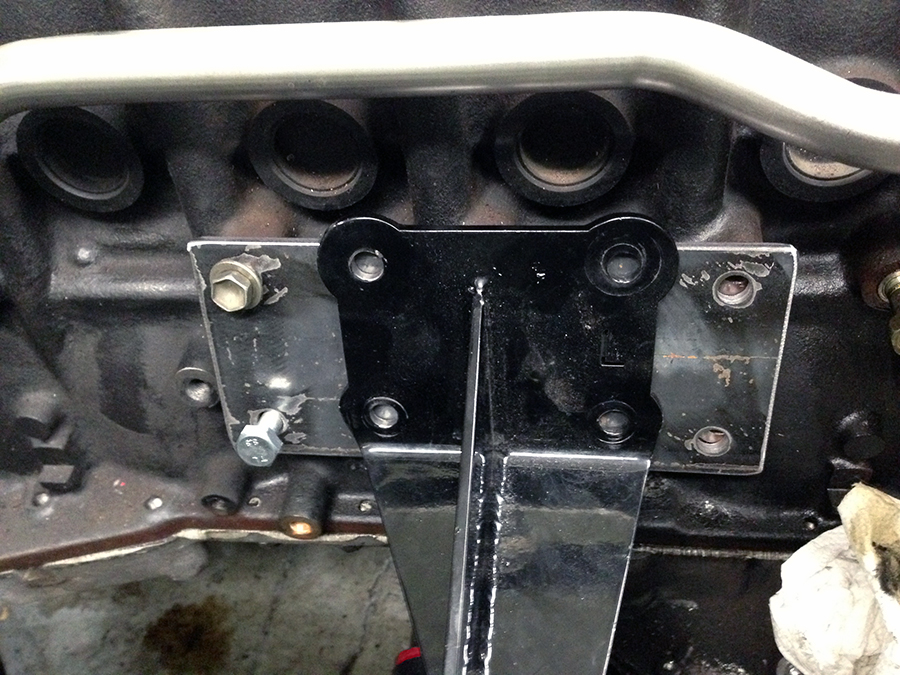

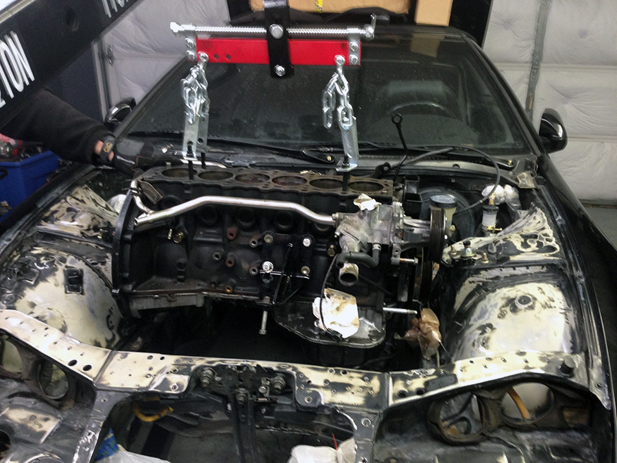

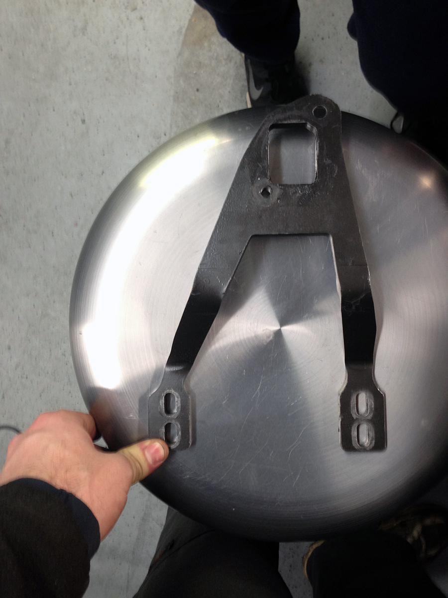

The motor mounts that we bought were designed to work with the R154 so we ended up having to make new brackets to allow the engine to sit in the bay properly.

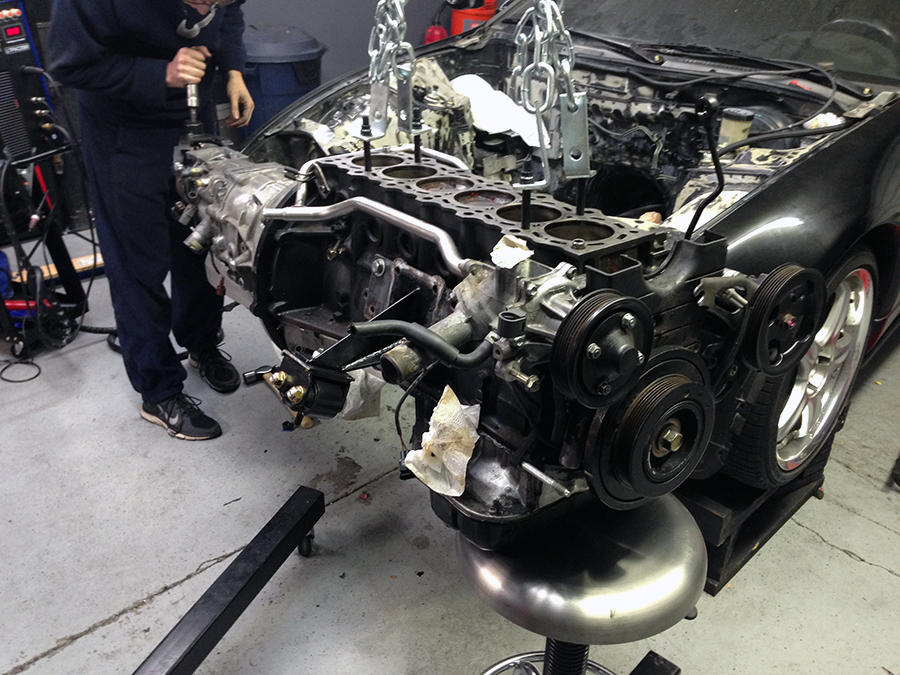

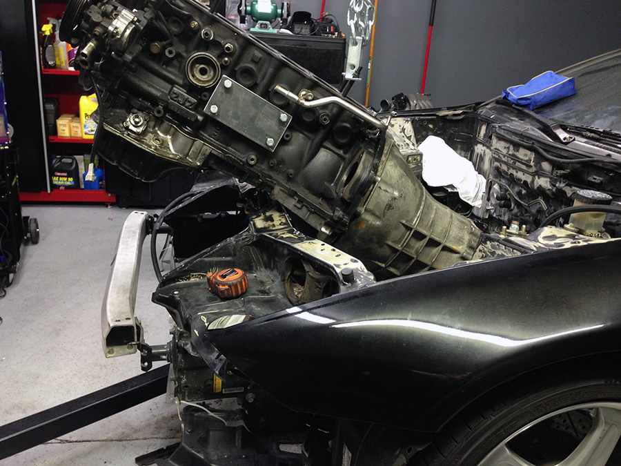

Mock up done and getting everything attached
These next images are disturbing..... I am sorry Joe it had to be done

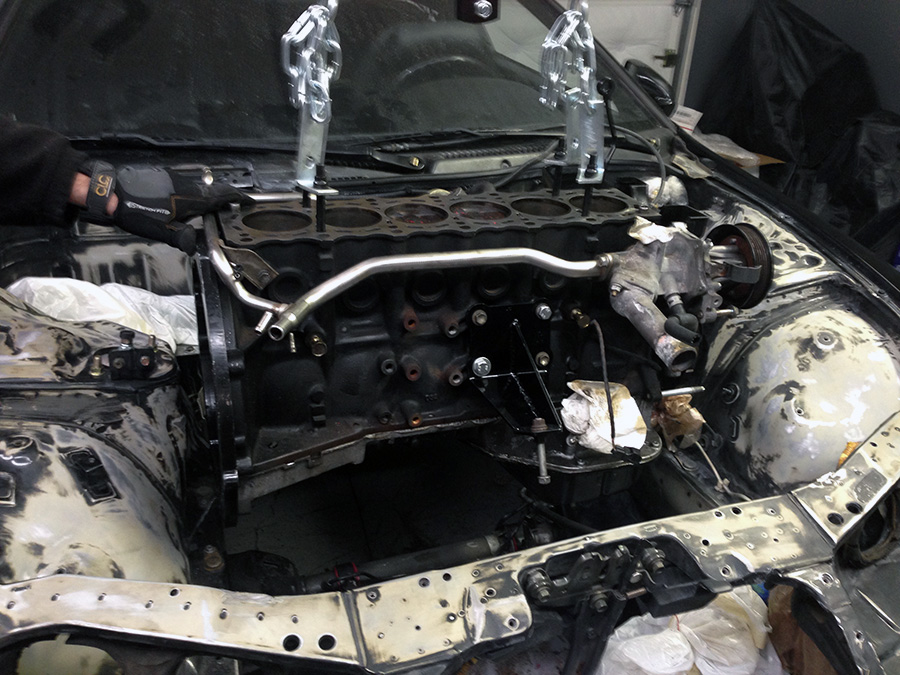

So with moving the engine around everything had to be shortened to work.

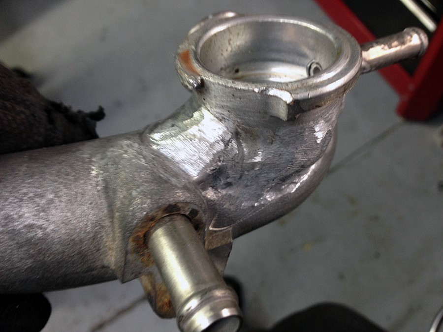

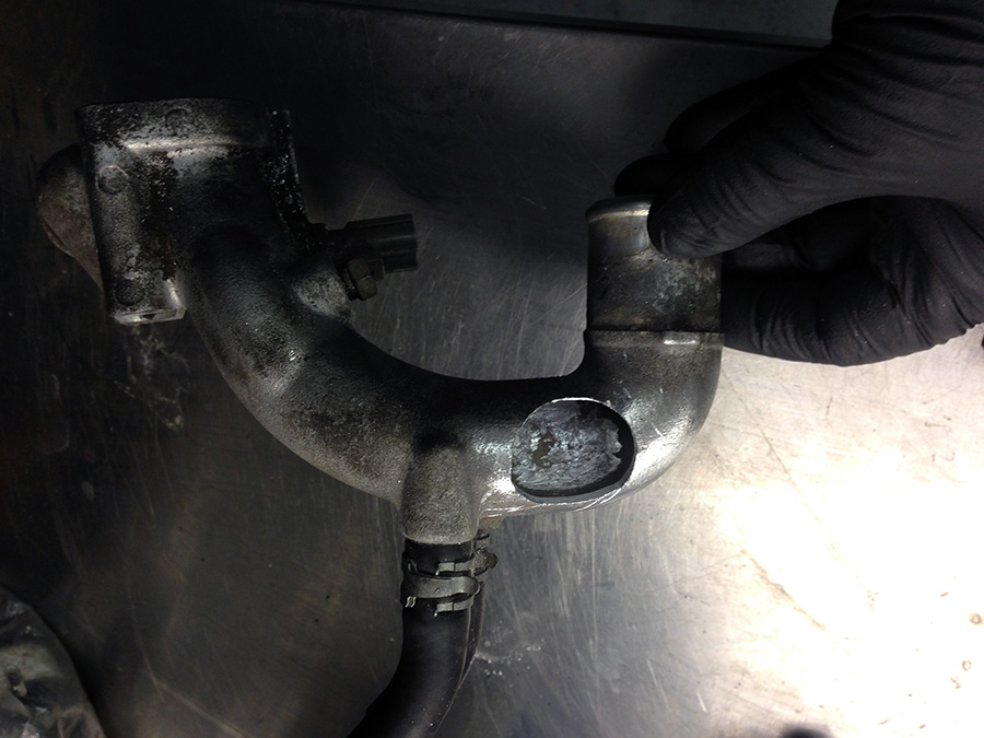

Modifying the water neck to take the radiator cap

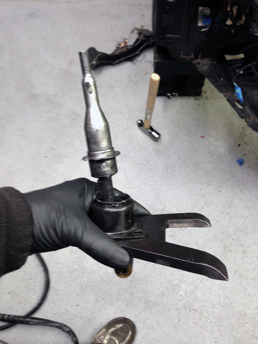

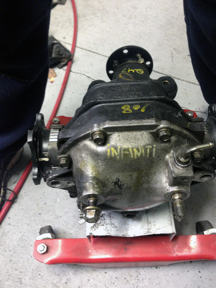

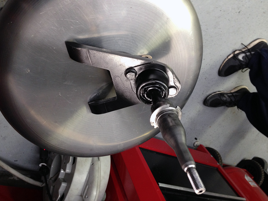

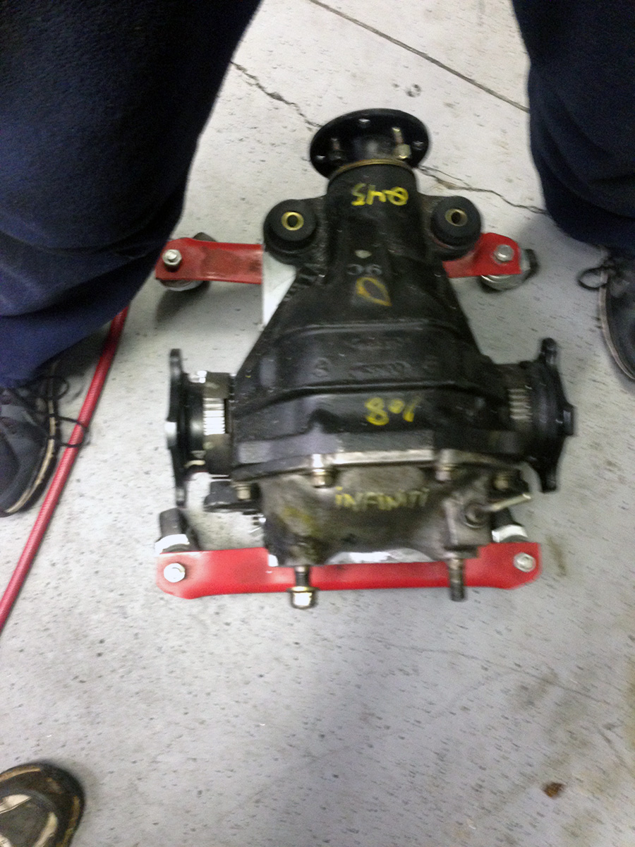

Switched the 410 diff out for taller gearing. This is from an Infiniti but is the same ratio as a TT Z and bolts right in.
Only thing we had to mod was the flange to accept the Z DS

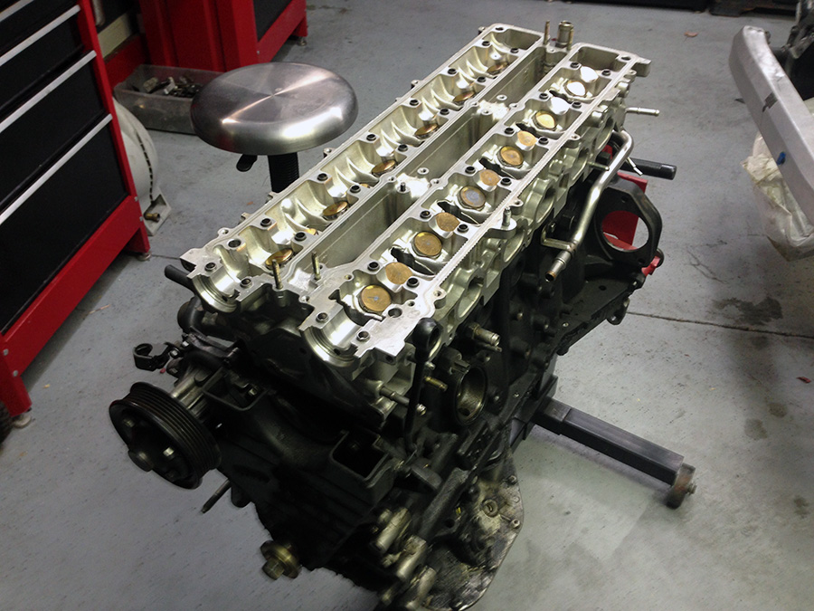

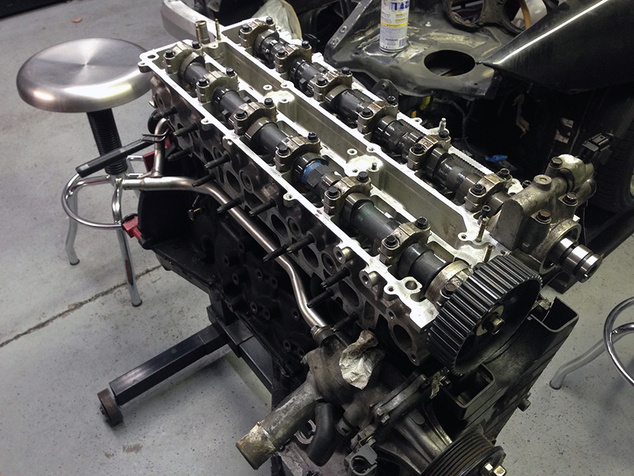

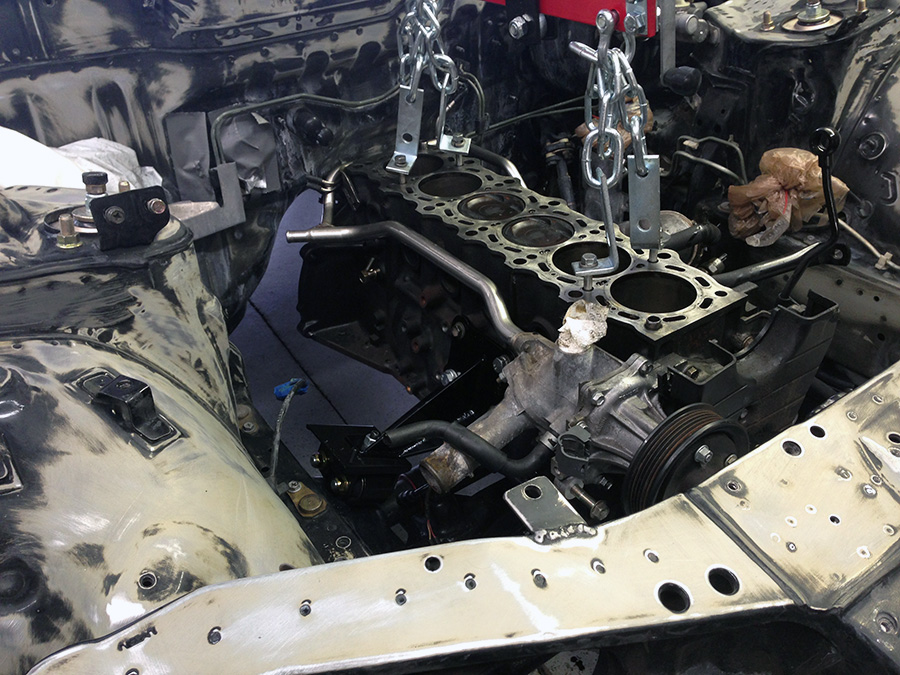

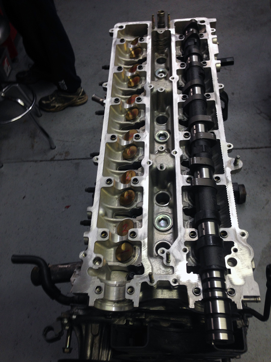

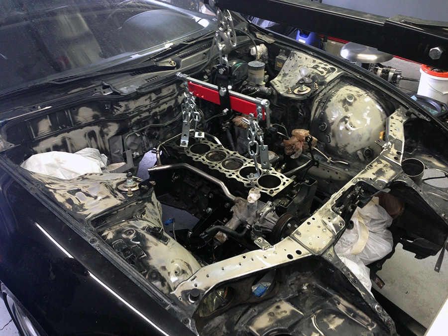

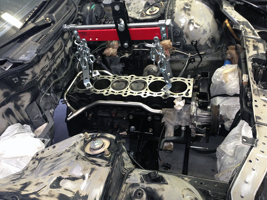

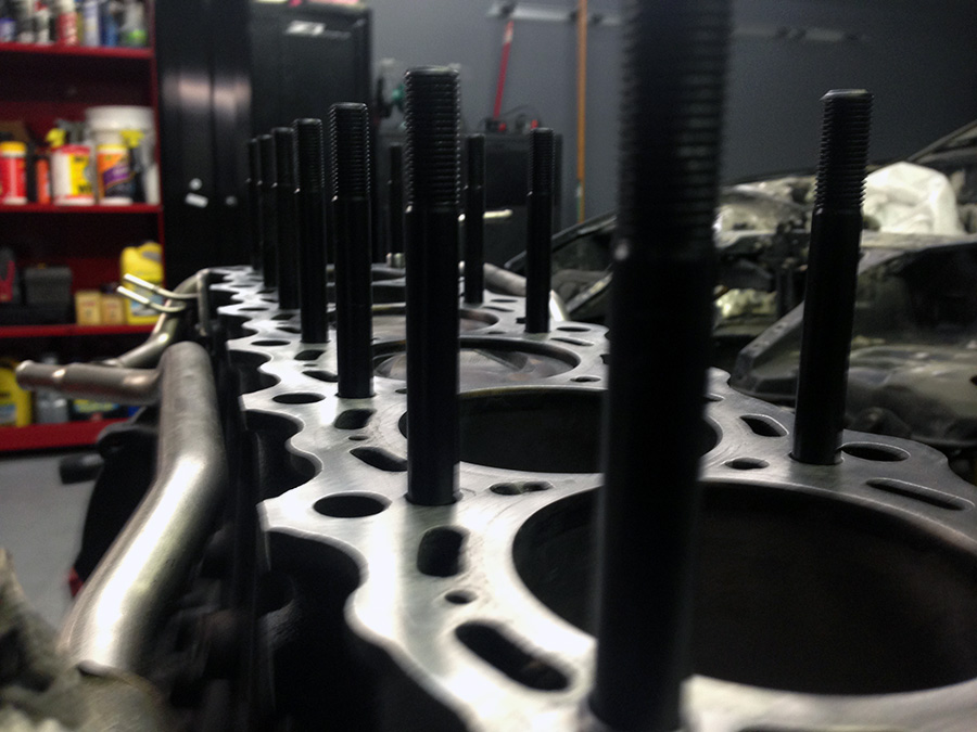

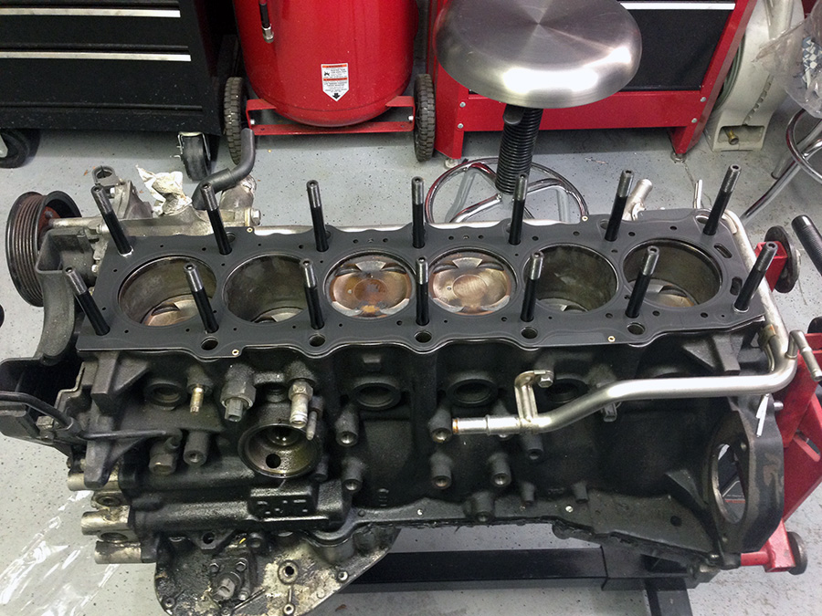

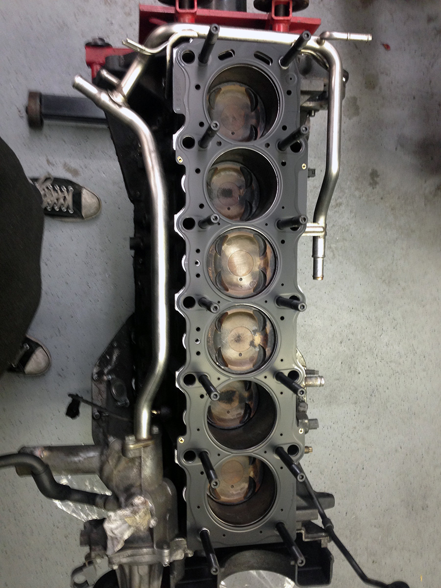

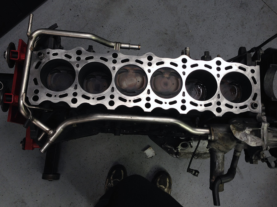

Giving the block a final once over before getting the head back on

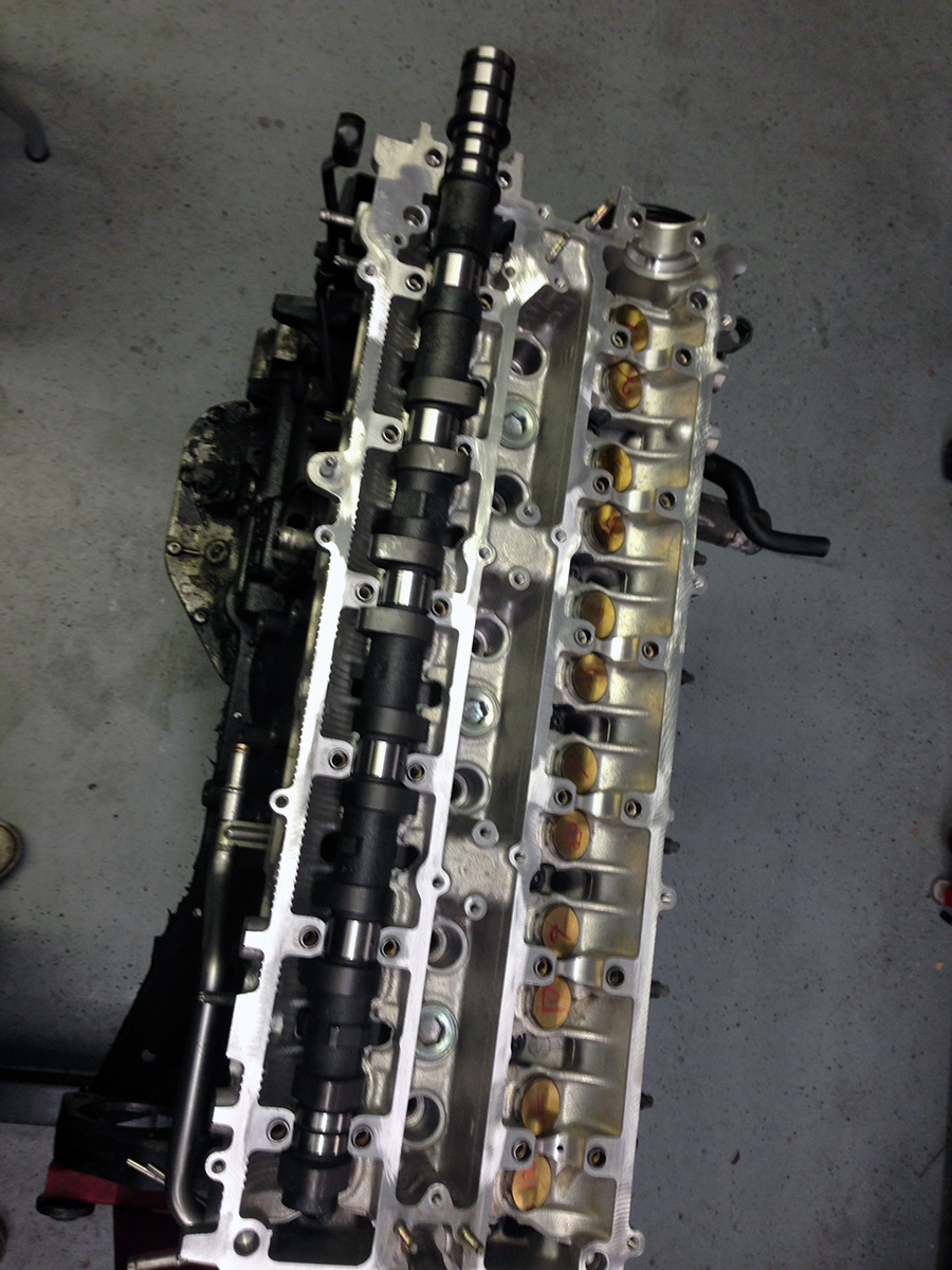

BC 264 VVTI Cams

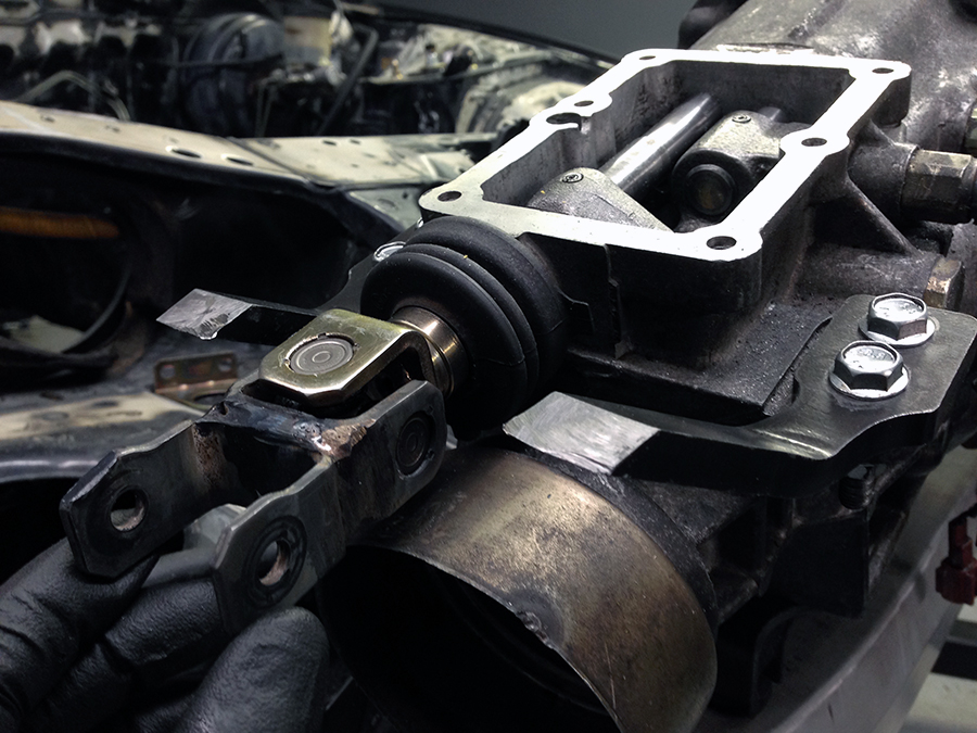

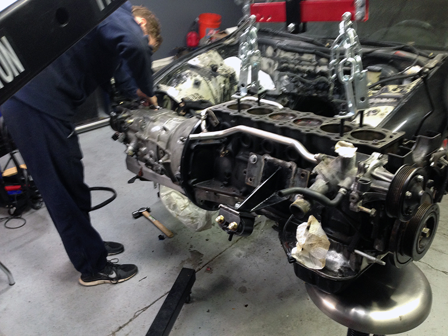

So at this point the engine and trans fit and we are able shift gears, which is a pretty big mile stone.
