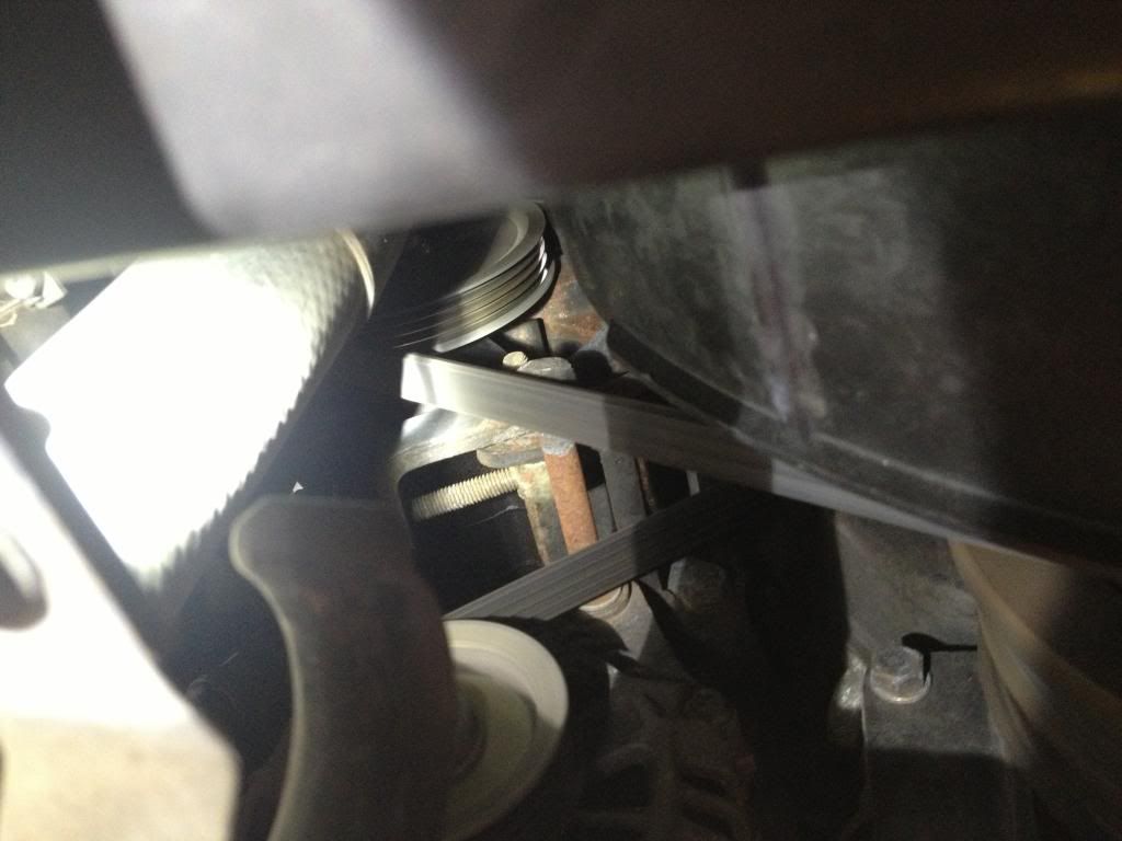

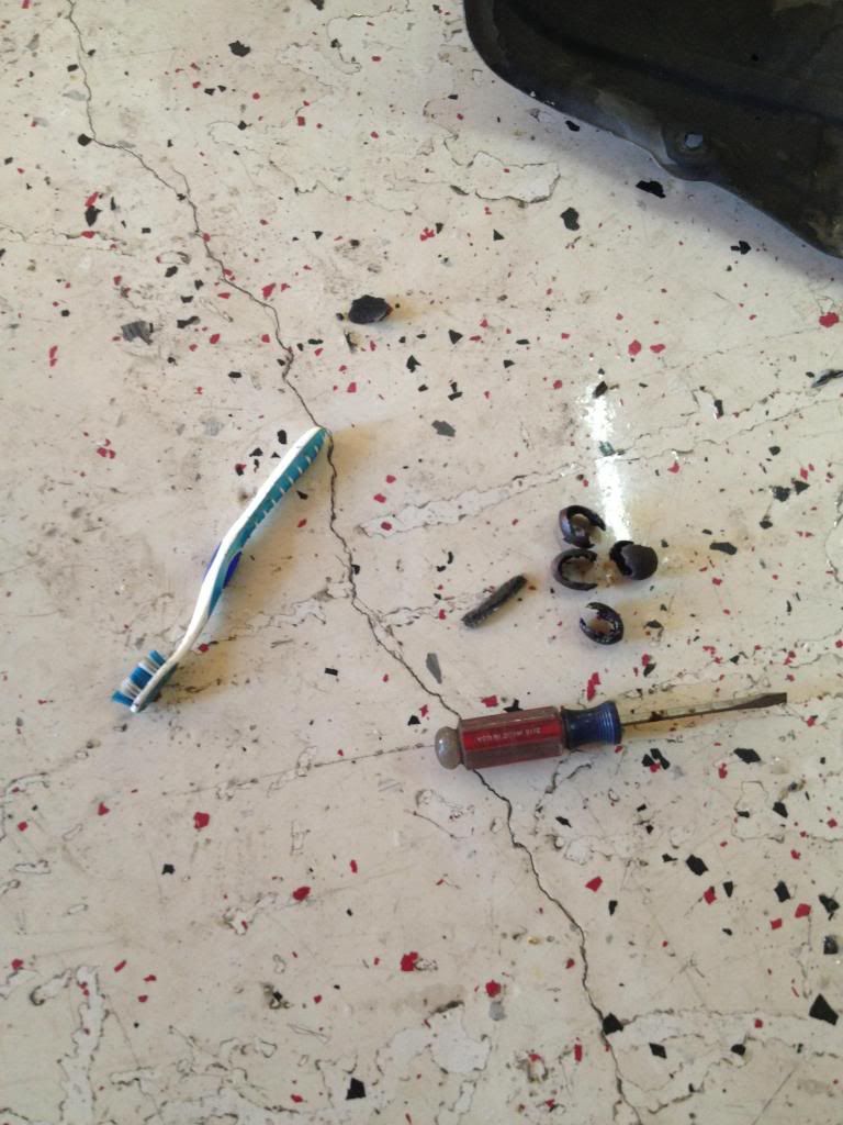

This is what came out when I removed the engine under cover.

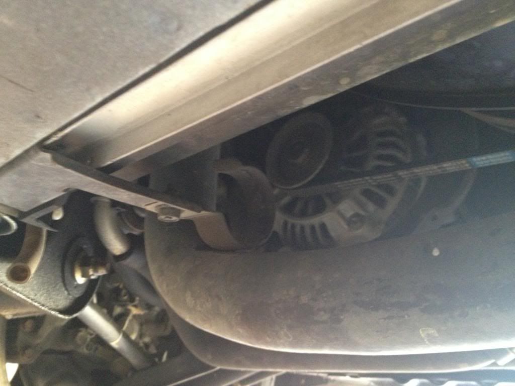

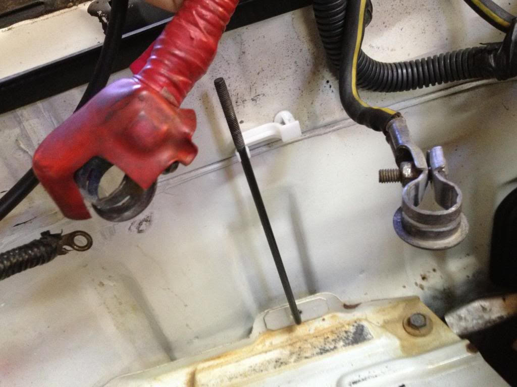

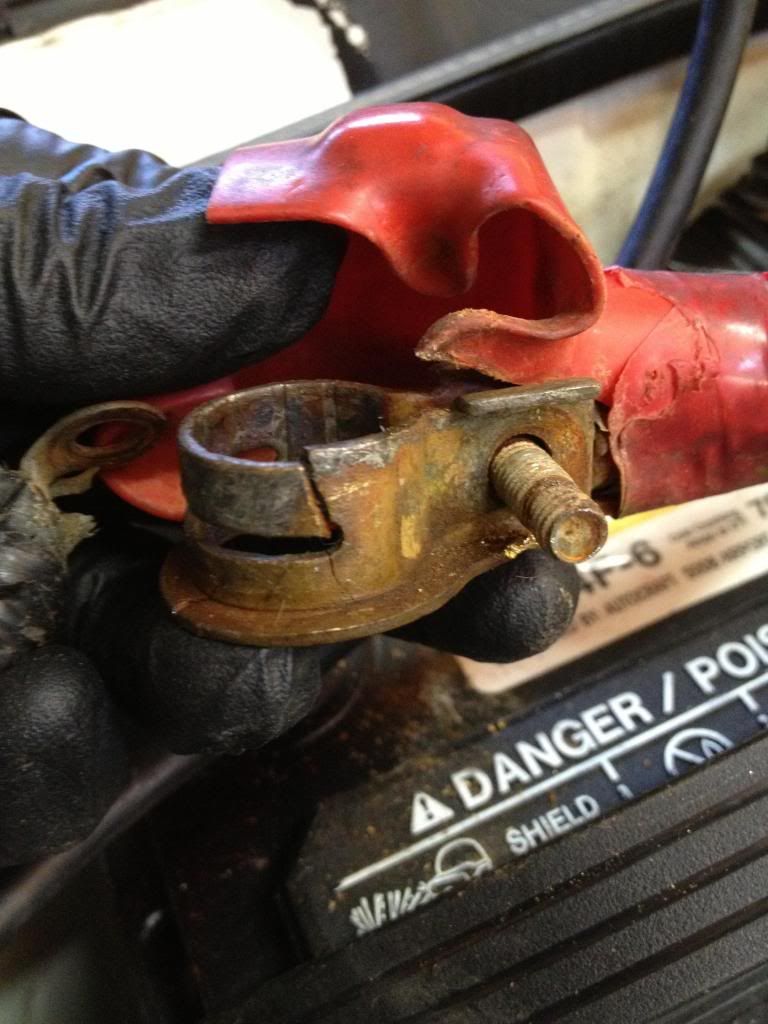

This was the Alt Bolt!! Glad I didn't try to drive this car home.

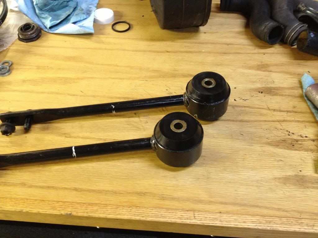

T rod bushings were busted.
Replace here with ES

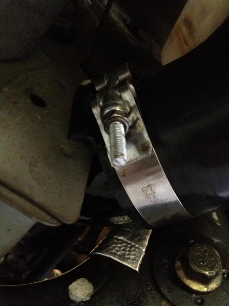

Lower Rad hose was out of clamp

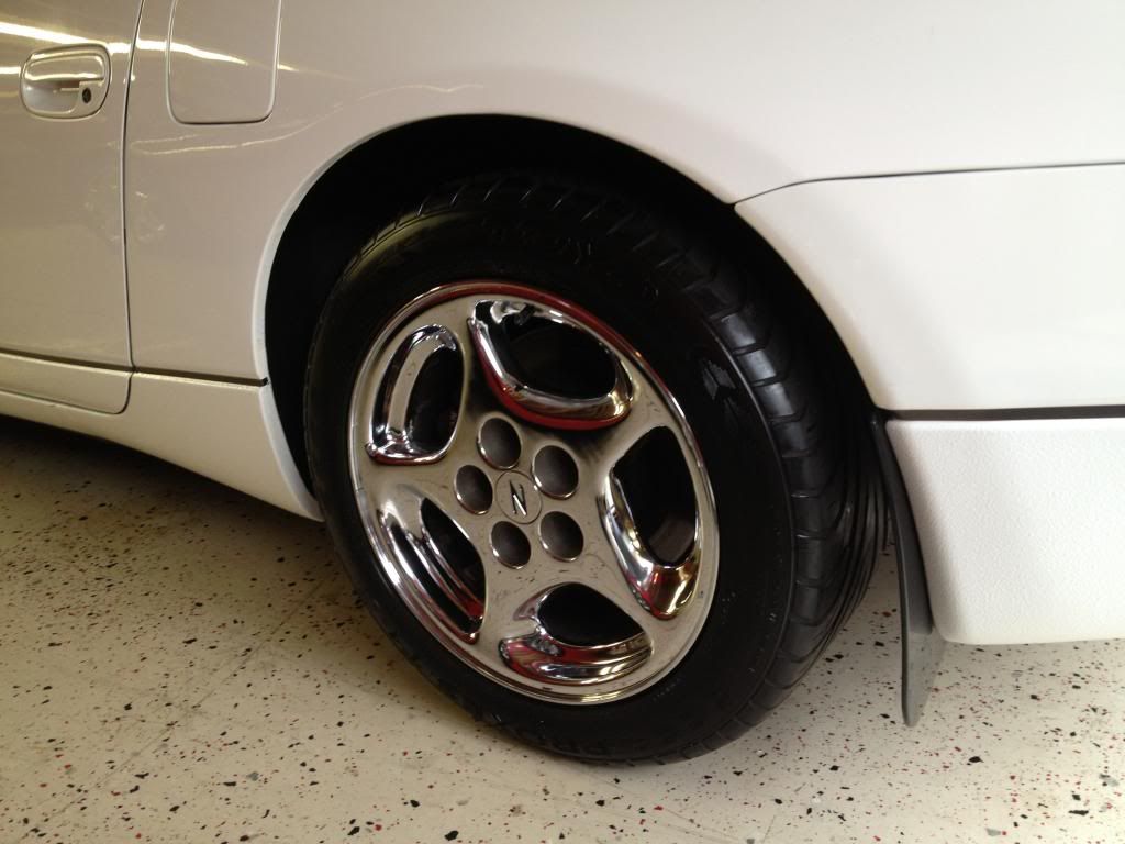

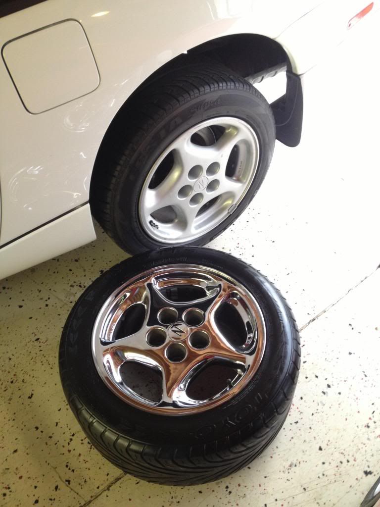

So since the '90TT came with 225mm tires on the rear, I swapped them out. Used some chrome stockers I already had.

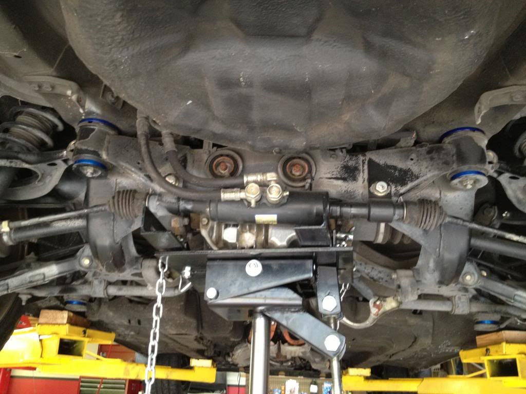

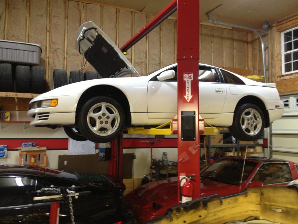

'90 White Z getting subframe spacers

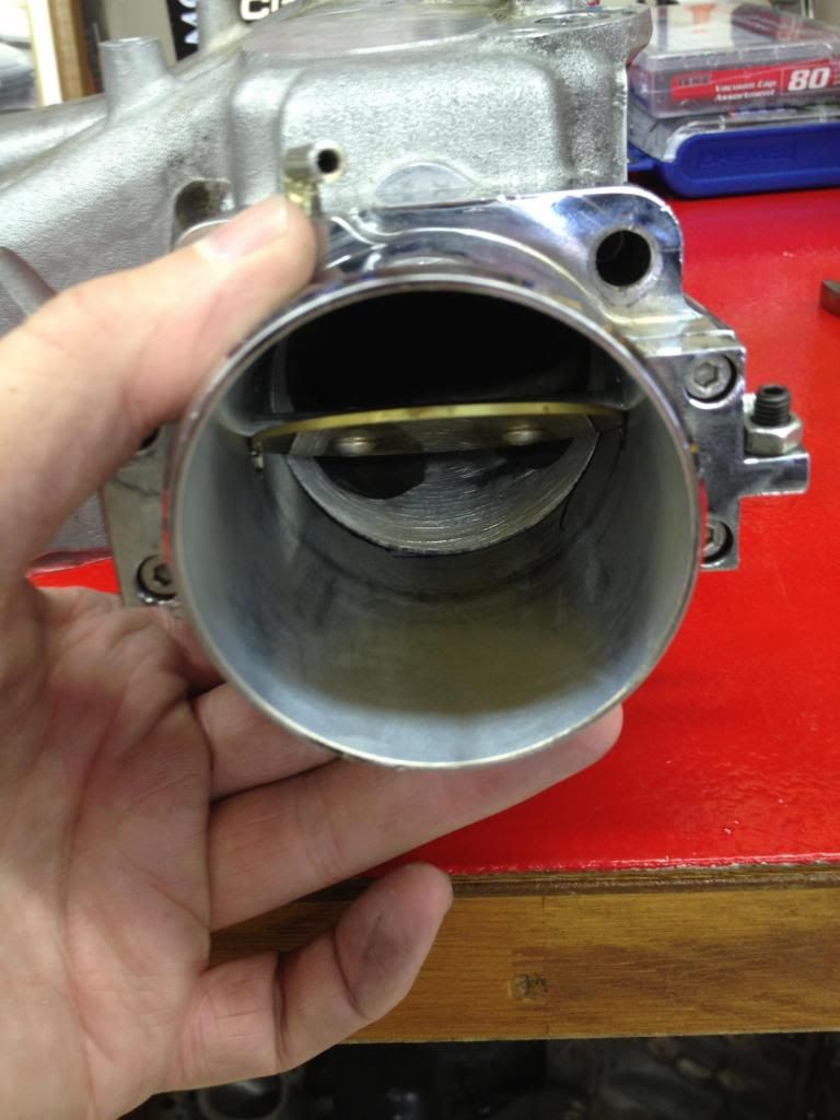

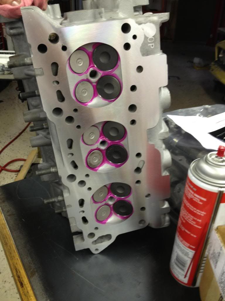

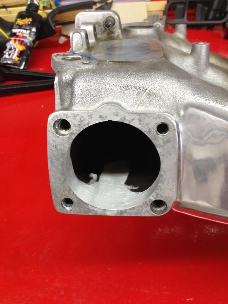

Track Z Intake porting to match 61mm T/Bs.
Props to Robert Bastian. He does nice work porting the T/Bs

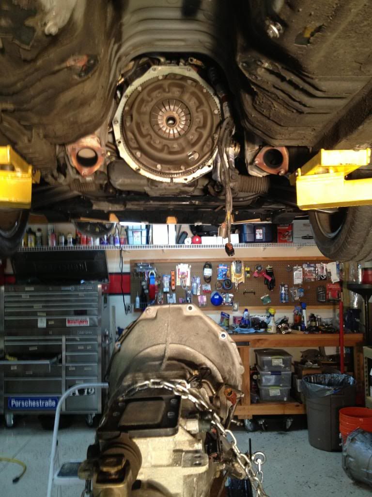

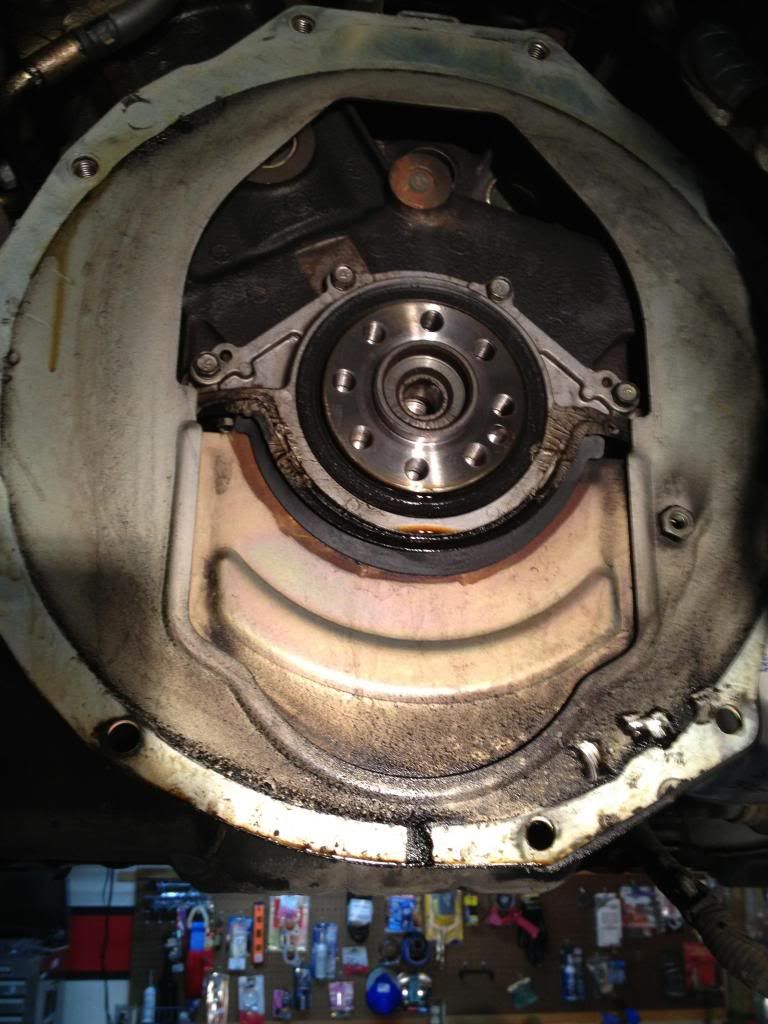

White '90 TT Rear main was leaking so...

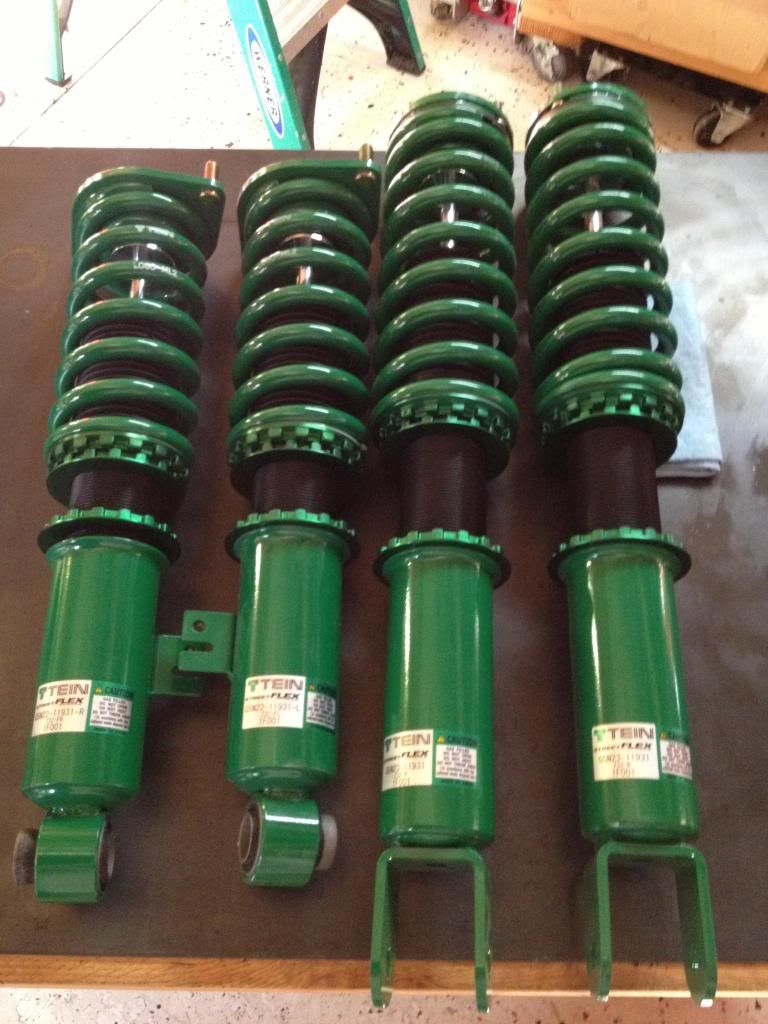

Both RH coilovers had bent shafts from the wrecked track car, so got these from Kyle due to tight timelines.
I have contacted TEIN and plan to use their rebuild services to salvage the ones from the wreck.

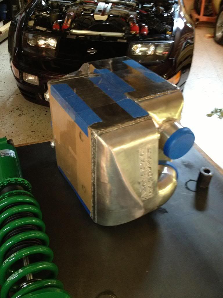

Had one Intercooler damaged too and since price for one through Bell / CZP was $500, I bought this set from SZ just for principle. Have since had local welder repair the Bell set and have ready for another project.

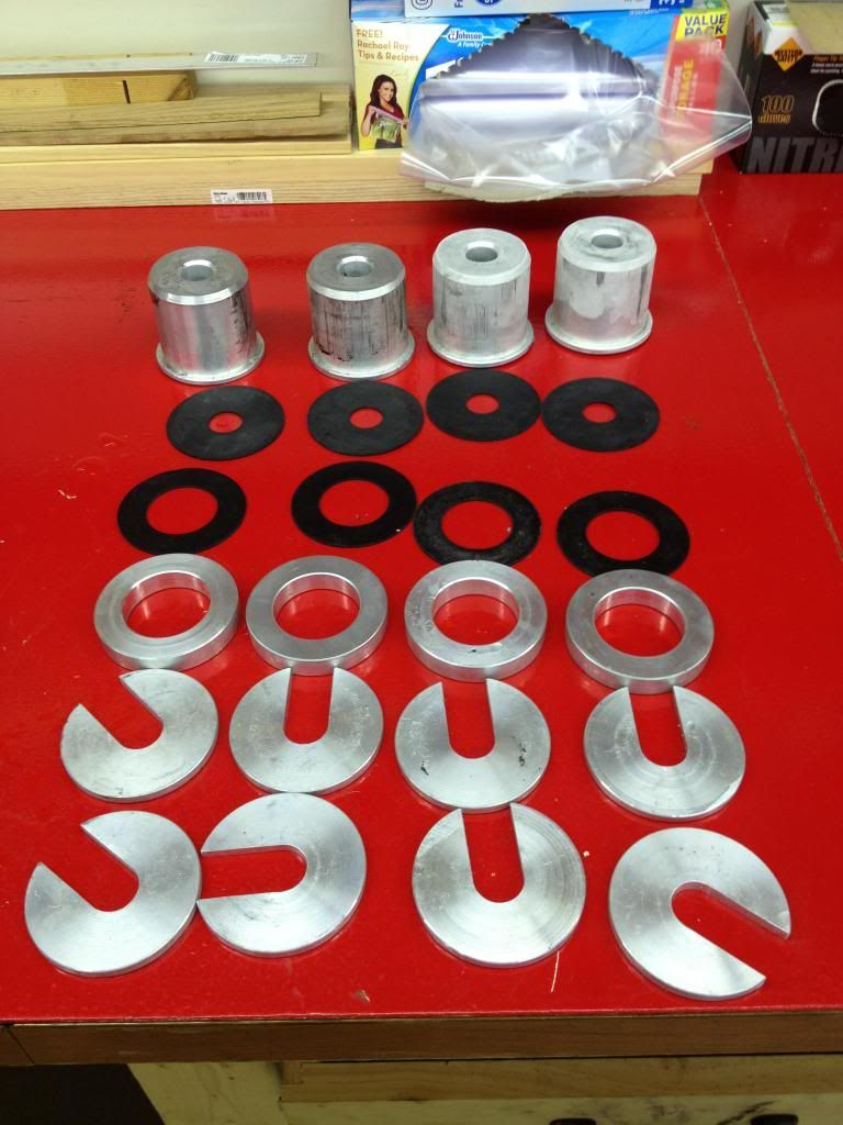

Also used Whiteline RR diff bushing from Joe.

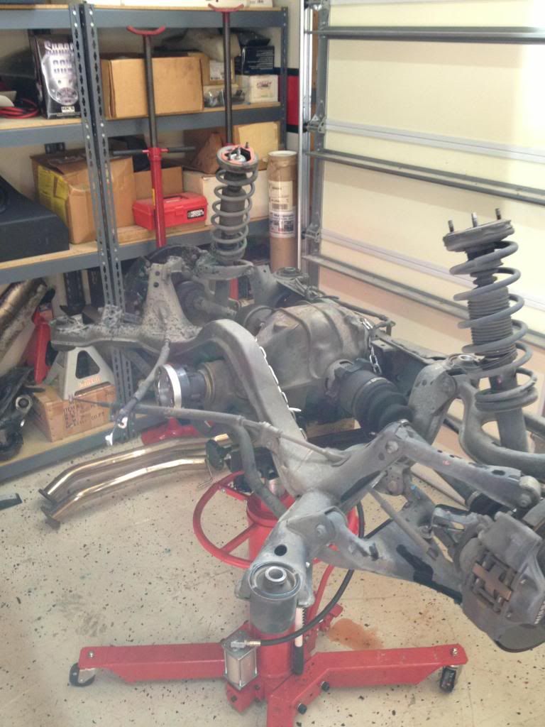

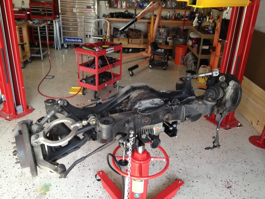

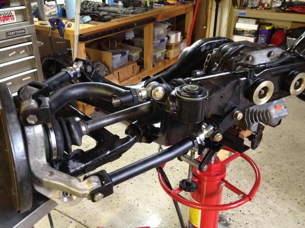

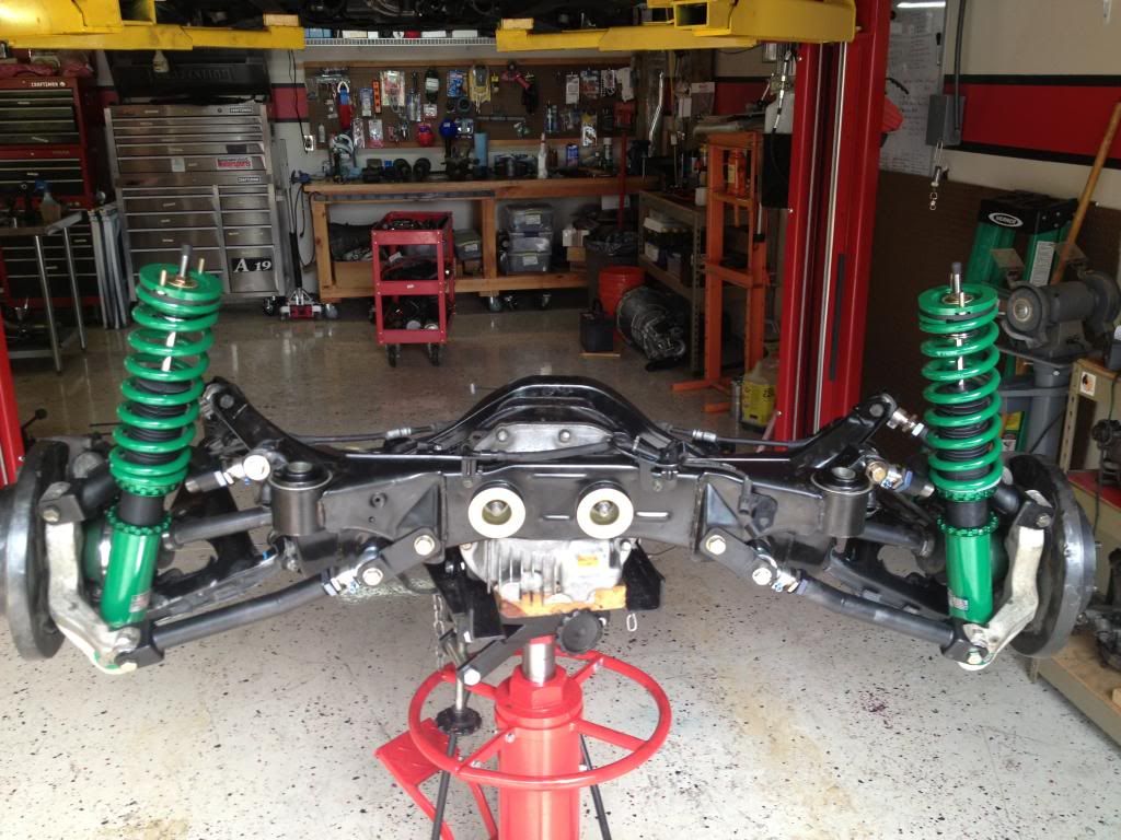

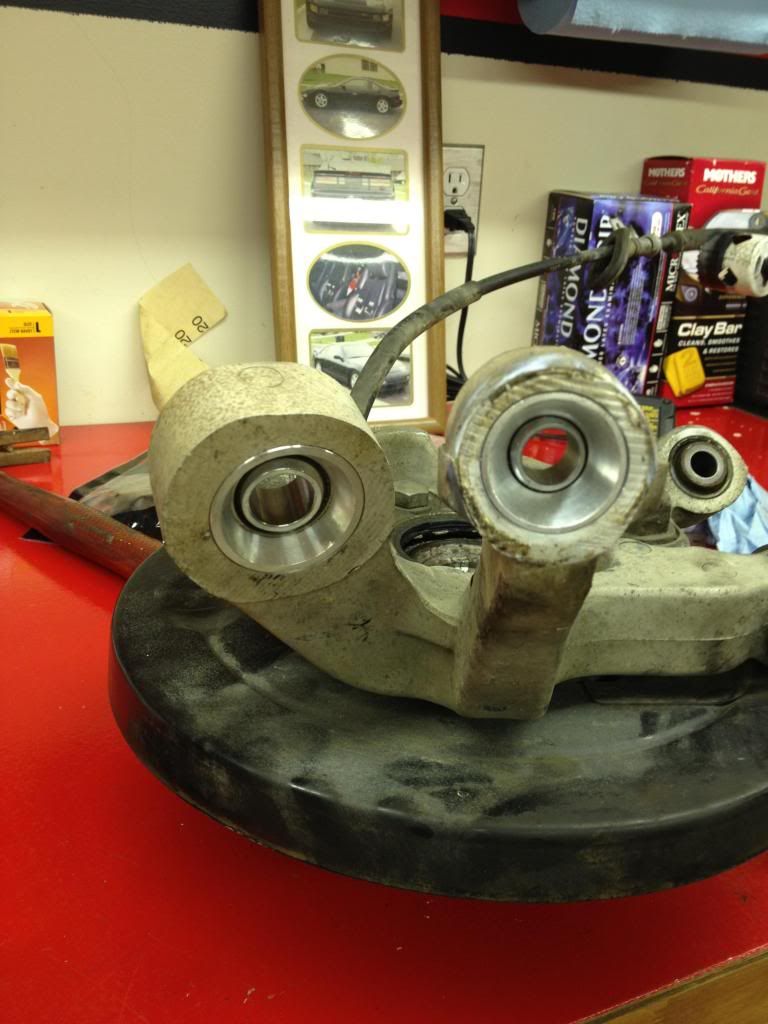

This is the third time I've done RR subframe bushings.
So this time I decided to do the knuckle bushings also with SPL and Nismo (old stock I had).
Many new parts from Sean at SPL :)

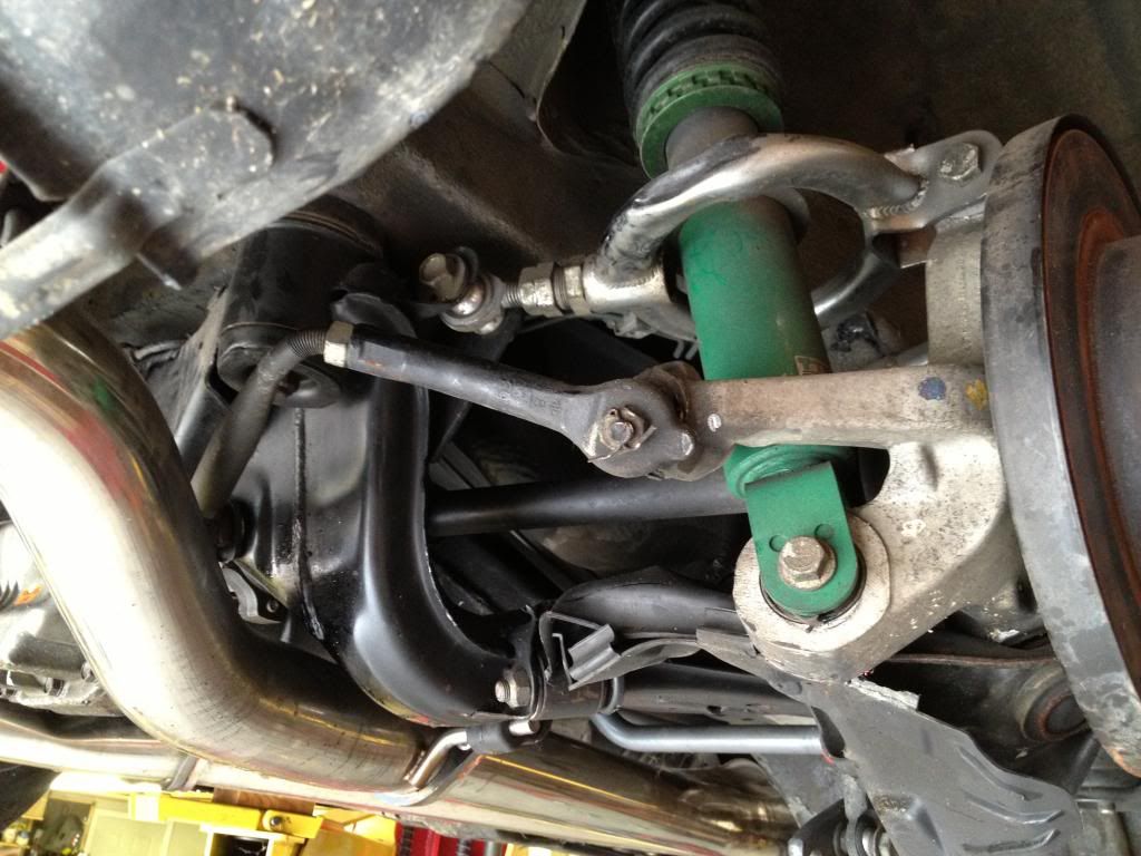

Powertrix front upper arms :)

Back to '90 white TT for more service. There was a chipmunk nest behind that stock filter like you wouldn't believe. Not sure how the car ran.

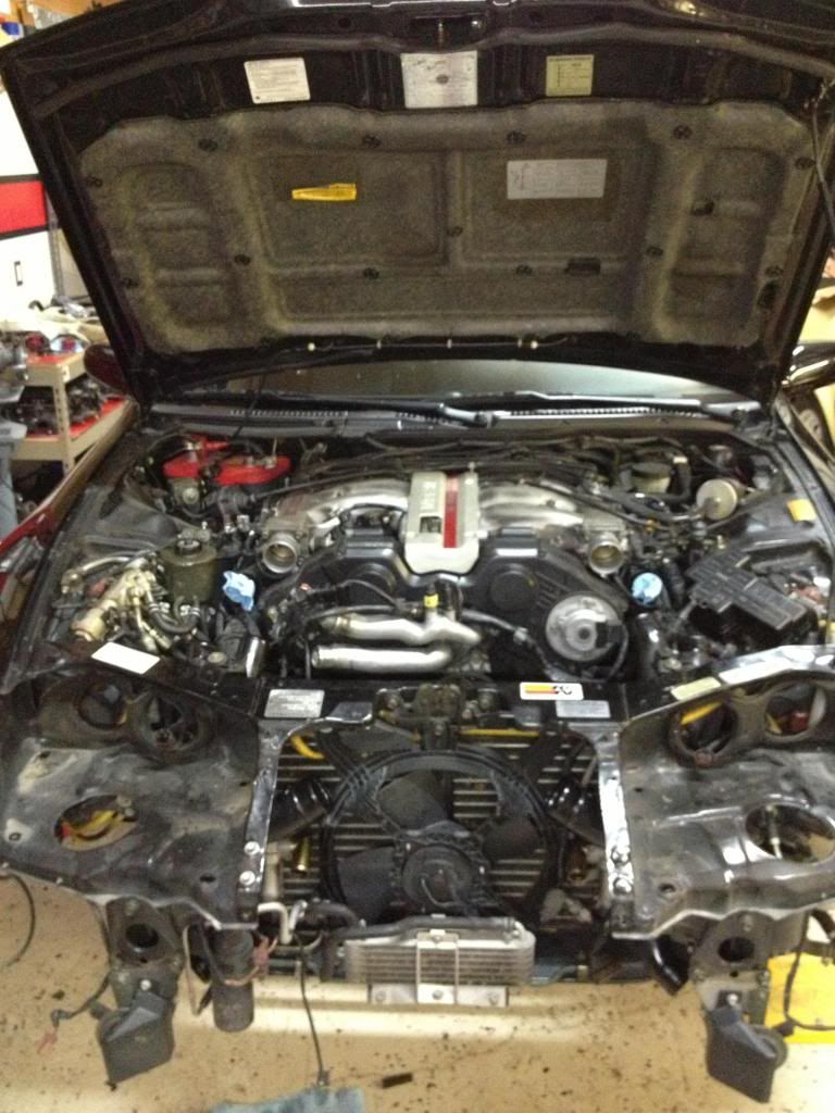

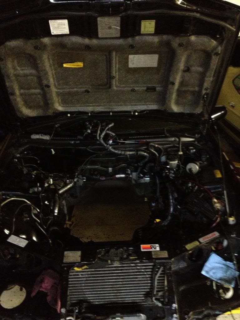

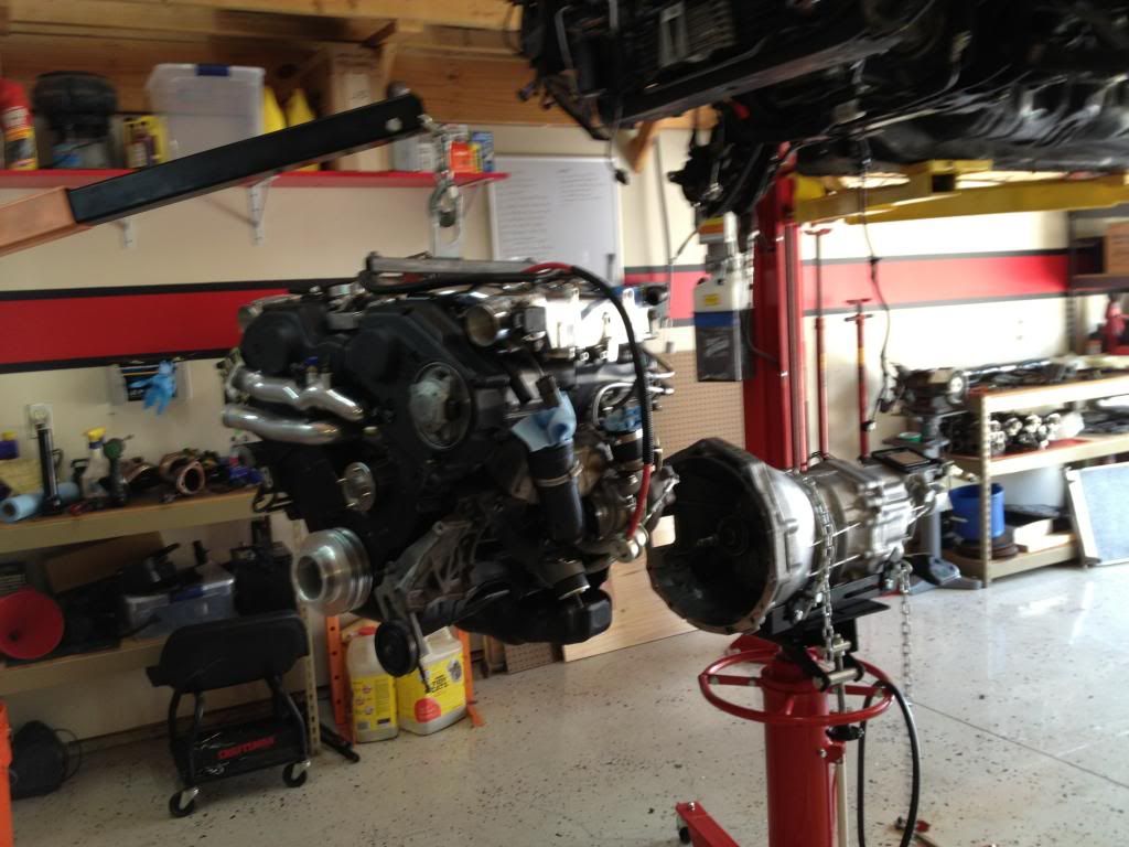

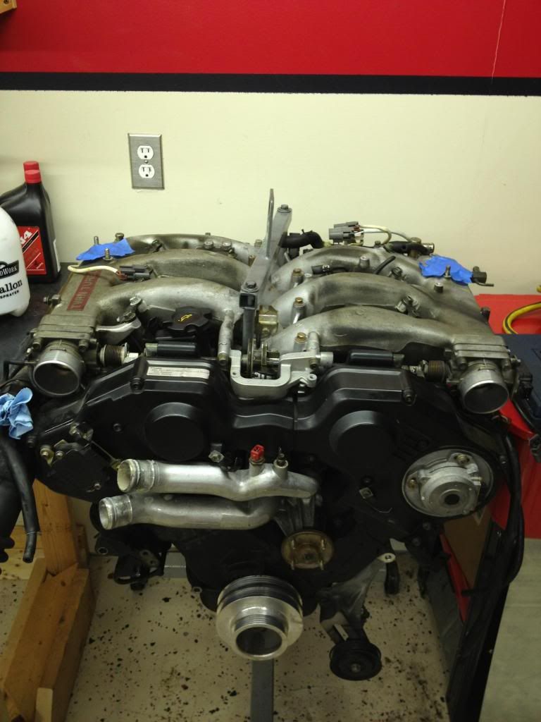

'91TT ready for track motor
47,000mile stock motor mothballed for now.

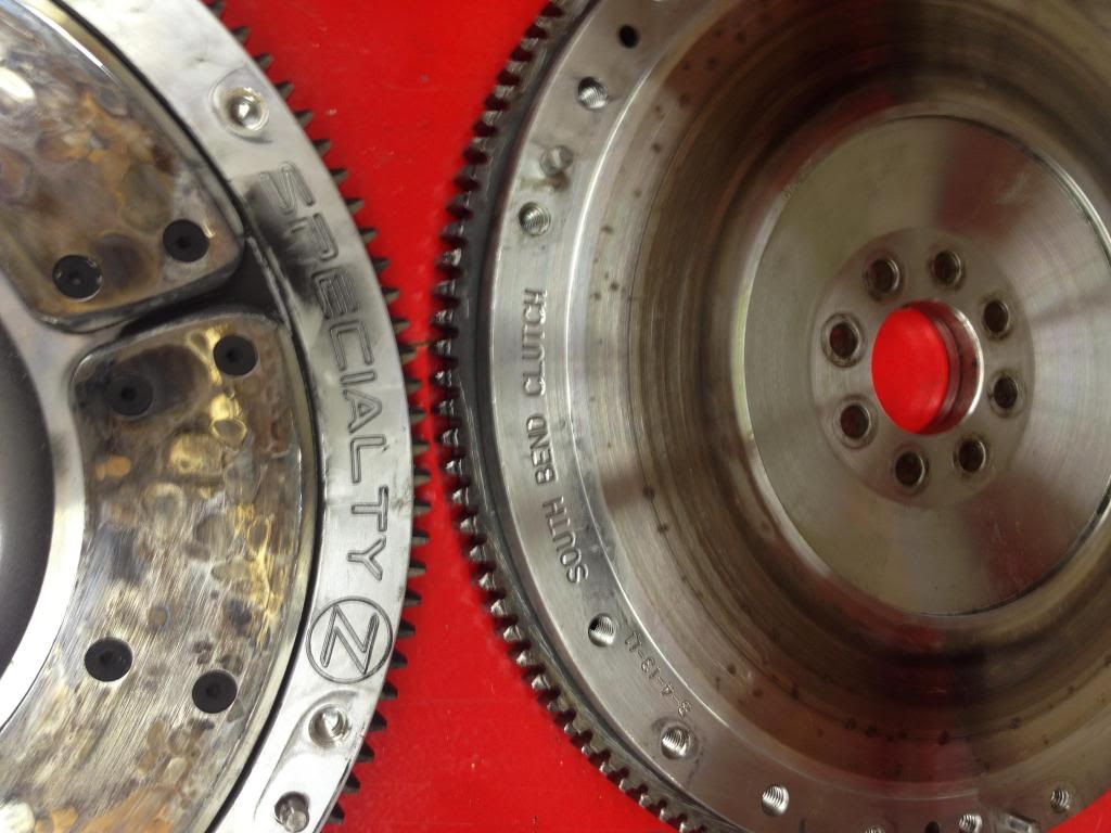

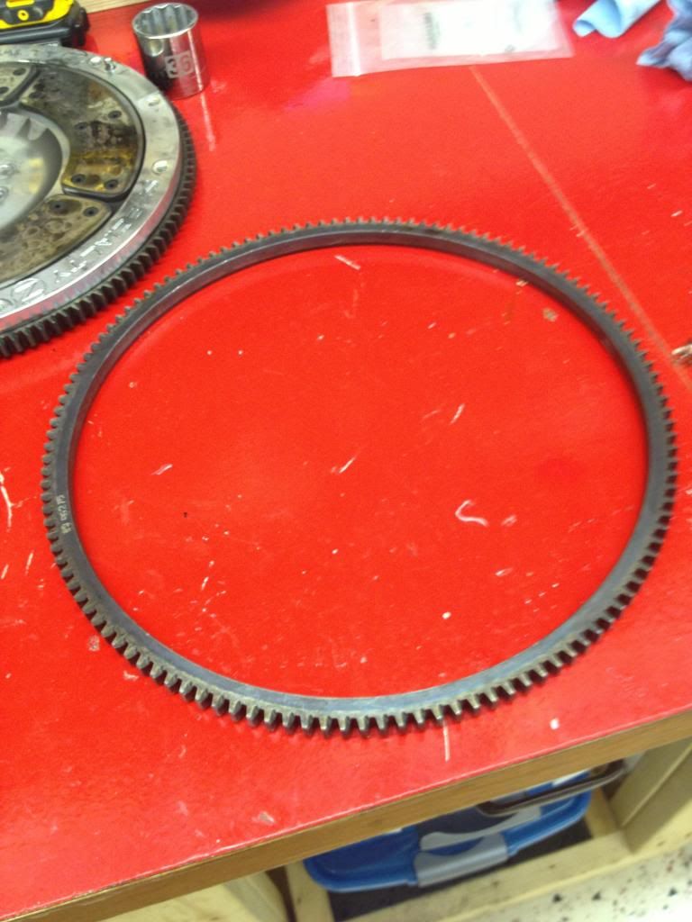

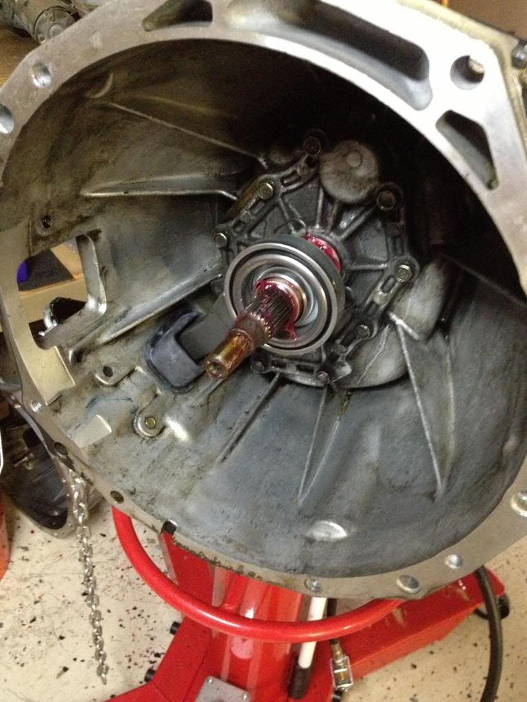

I had starter grinding problems occasionally since installing a South Bend flywheel a couple years back. Got to comparing to other flywheel and found the starter ring was on backwards. So there was no lead in on the teeth engaging to starter.
Some heat, a BFH and whalla!

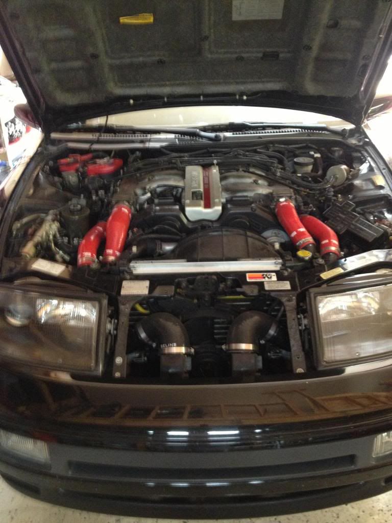

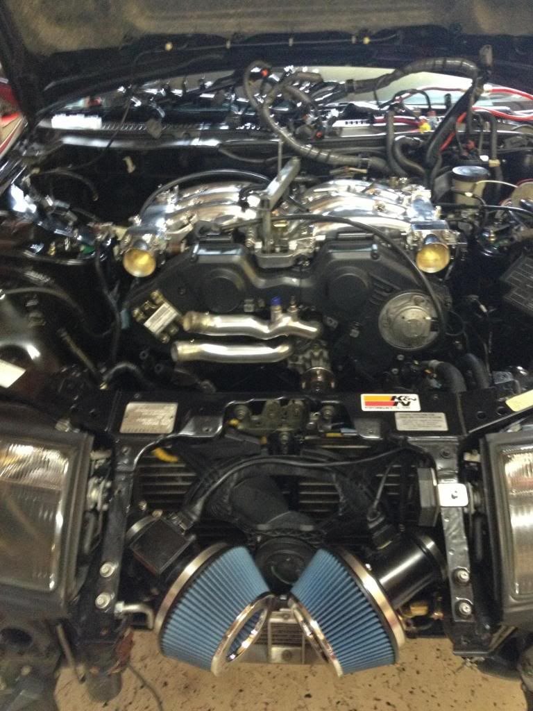

Ash Massives in
Ducts on
Had to grind / clearance for the 2.5" piping.
Then added fuel hose on one side and butyl patch on the other for protection.
Pipe in. Fits like a glove.

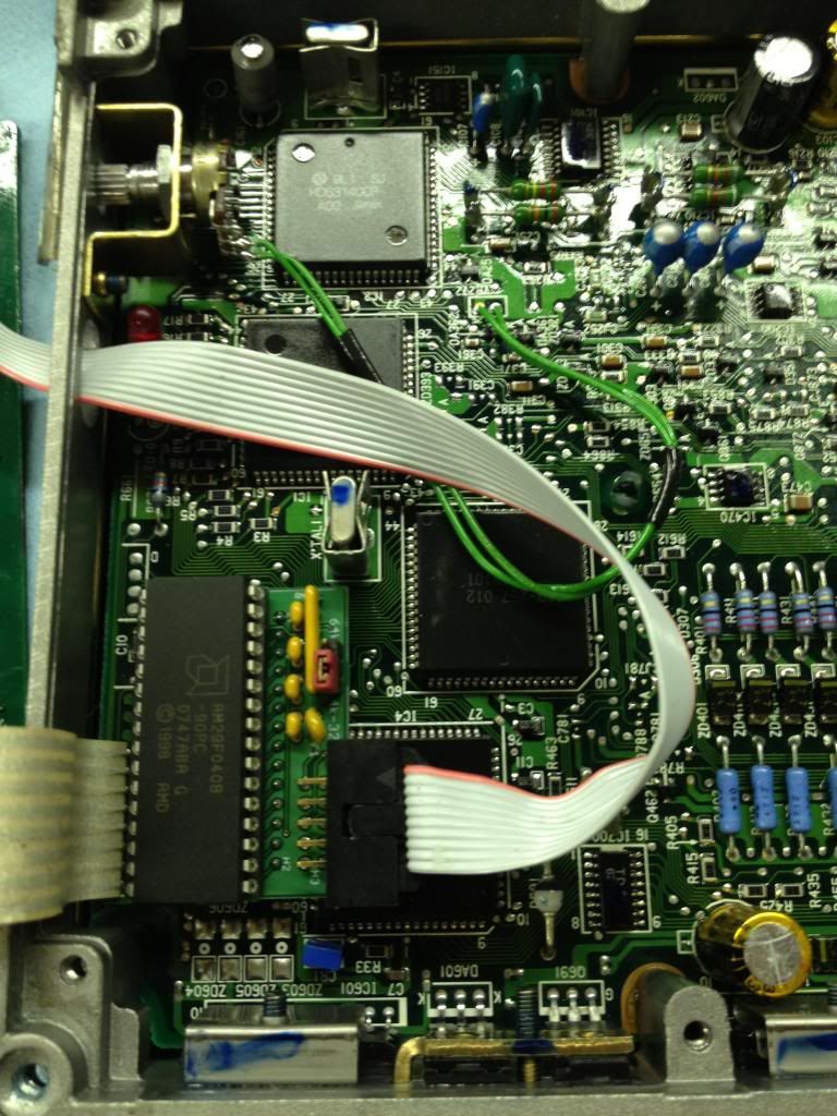

Then I couldn't get the car to run. Fuel pump wouldn't turn on. Traced to bad ECU. So off it was to Seb at SZ.

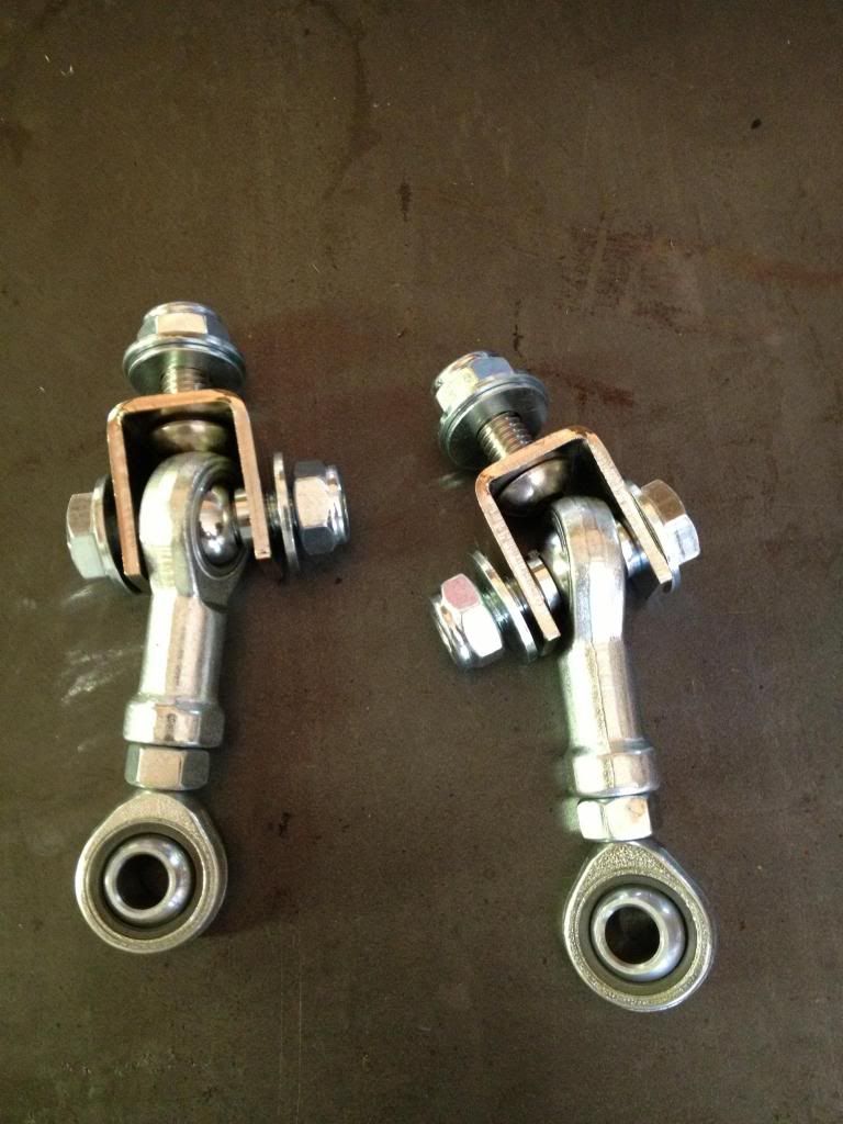

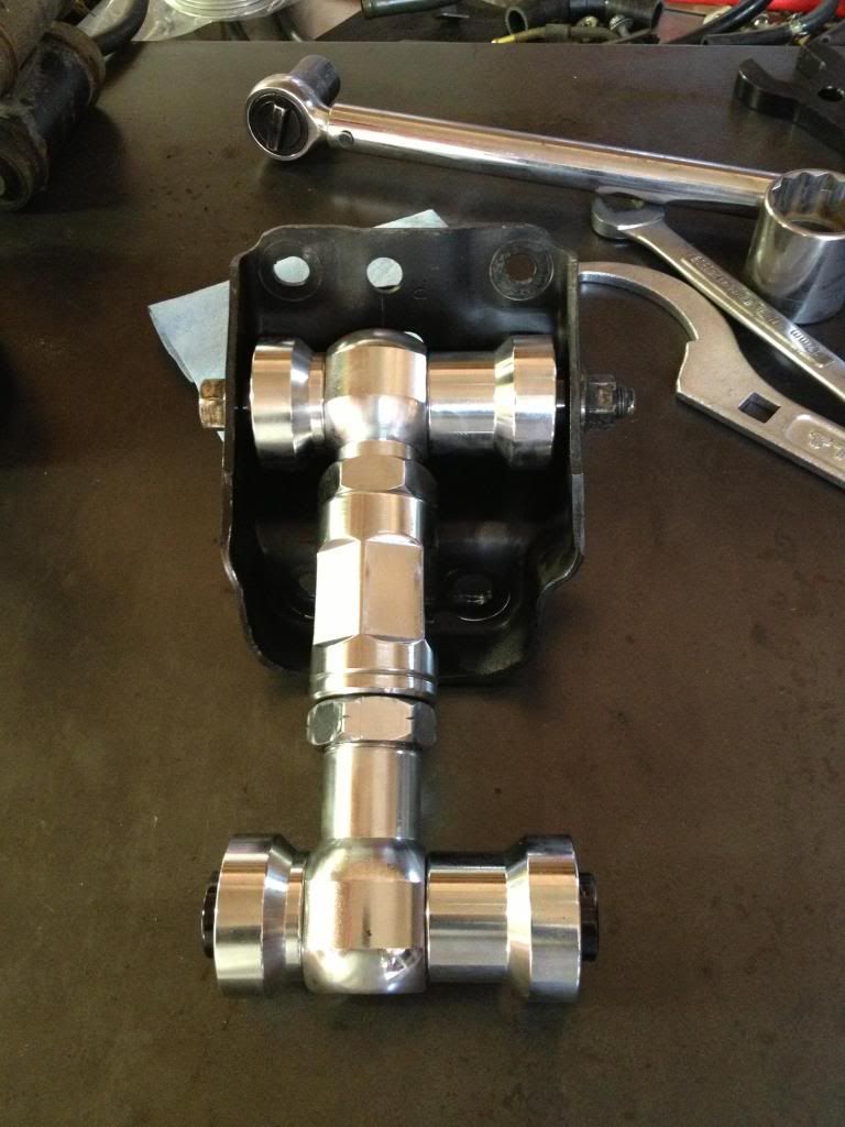

Back home to the important stuff. Powertrix RR sway links.
Thanks Charles

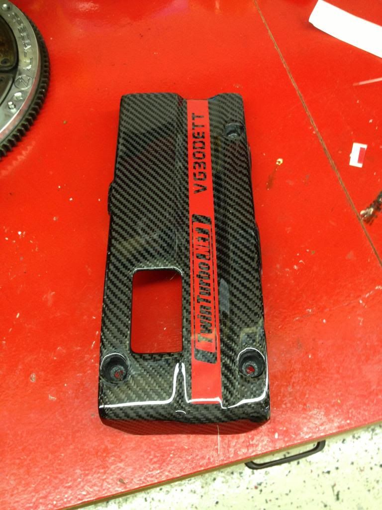

Powertrix T/B cover.

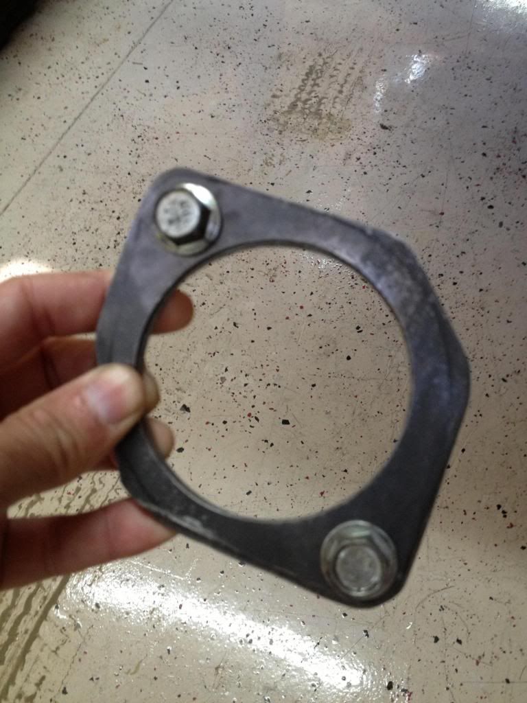

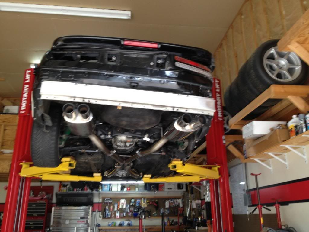

I had problems getting my 3" exhaust to align at the X-pipe to Test pipe junction. One test pipe always had a larger gap than the other. So I fabbed up simple space for a cleaner fix.

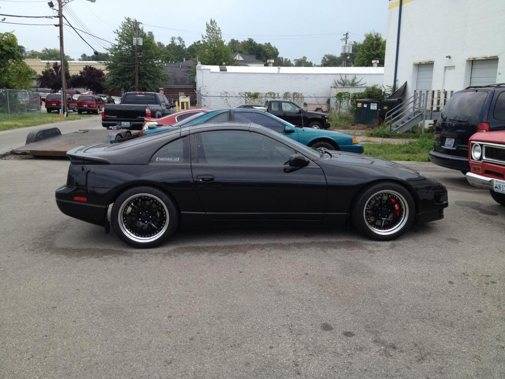

'91TT almost ready for Track Day 2013.

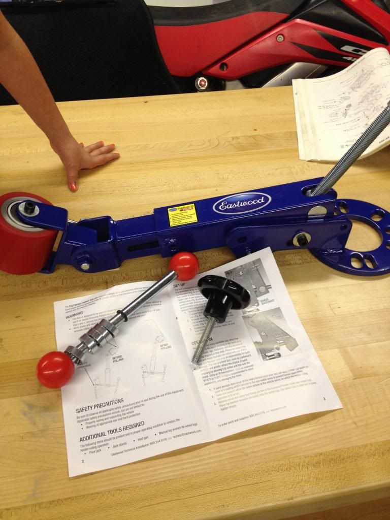

Time to roll the fenders

Fender roll

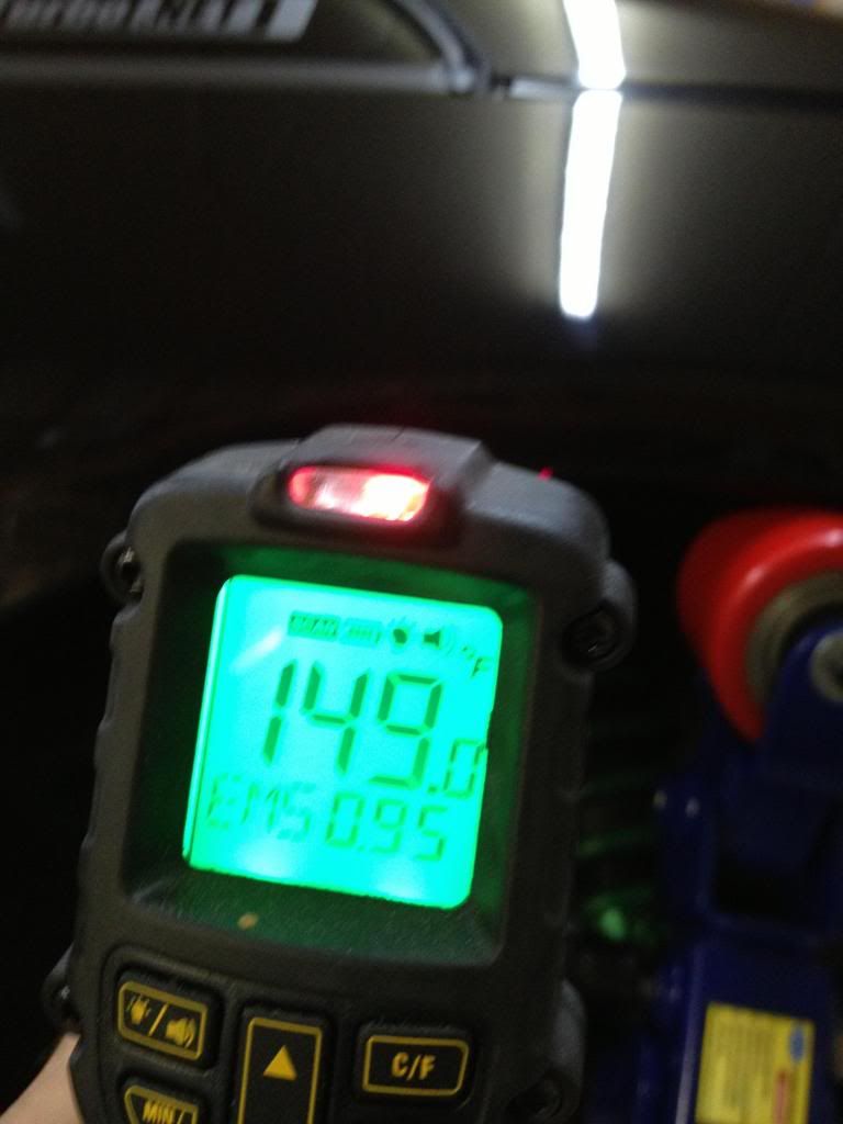

Making sure paint is warm and soft.

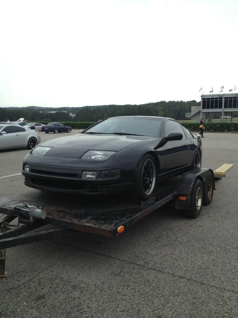

Track Day concluded without incident, loaded after 3 runs & rain just starting. A very good day:)
