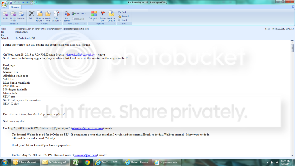

Here were his thoughts on my set-up(profile not updated)
Nismo 740's Injector duty cycle at 22psi on stockers and E85

Oops, I think that's actually 3.9 volts not percent. So that
Evan_Wright (Ca)
10:41:53 08/29/13
Makes sense. You're fine at 90ish%. When they go static
12:21:54 08/29/13
Wow that's up there. (n/m)

We did not discuss the duty cycle but in my opinion its safe (n/m)

I ran 90-95% on my 1000cc/E85 setup for several years

sounds about right. I am getting lightly lower numbers
ztunerz
14:45:05 08/29/13
It was 84% on the dyno, the street loads the turbos harder
