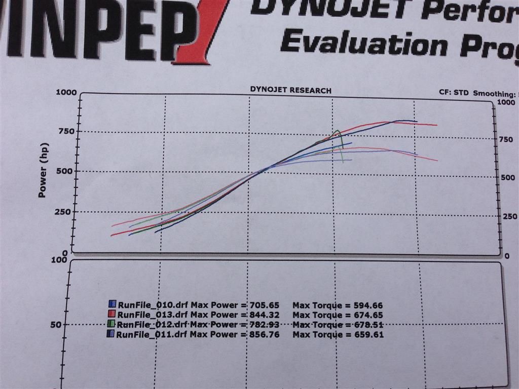

Message Had a good time in Omaha while visiting to work on Rays Z before Znationals... after a few days of maintenance we put it on the dyno for some test runs... not too bad for a Z with a fully functioning air conditioner lol Some may recongnize this as Chin Vongs Z back in the day :) We still need to put the Quaife rear end in and retune on e100. I must say the Haltec is legit as this Z runs awesome! We are hoping for some good 5 speed 1320s this fall in North Carolina. Anyway here are few vids and pics from this weekend...

Dyno Run
[ http://www.youtube.com/watch?v=2GEqy1pswjQ ]
