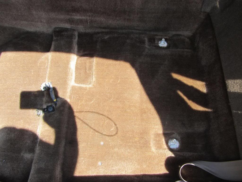

And this is the first time I have removed my seat so I got a chance to clean up under the seat. I found some glass, money, trash, dirt, but surprisingly no french fries.

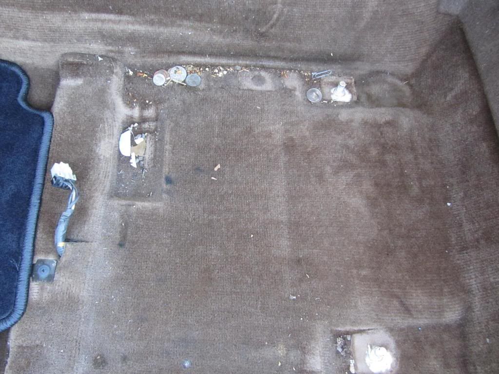

After cleaning:
