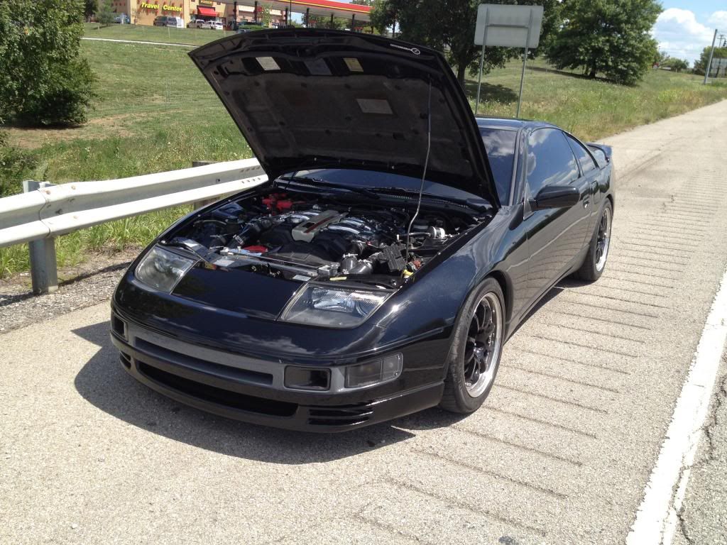

Message Earlier this year, just a couple weeks before Z nationals, my Z overboosted and resulted in a side of the road breakdown. Notice the oil line on ground behind the car?
Breakdown
Here is a clue that this was not going to be a simple fix.

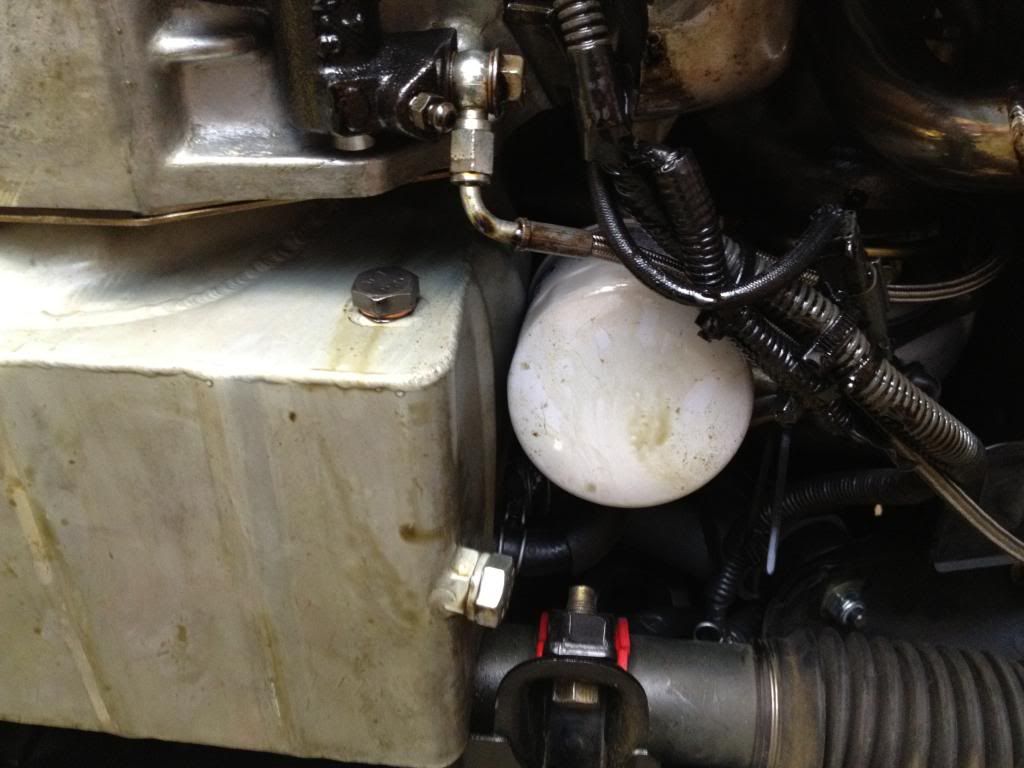

Along with fact that the Z puked out most of the oil through the holes in the pan.
OilPanDamage

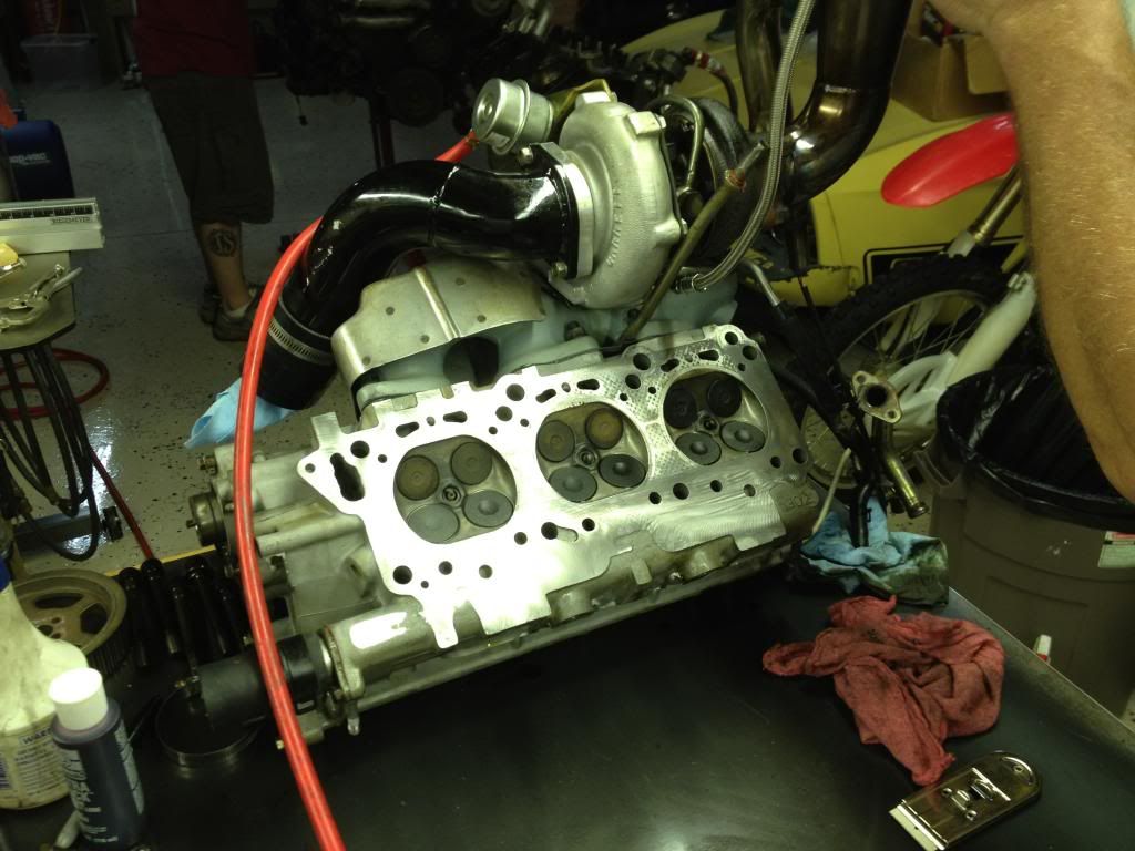

Fortunately the heads were not damaged and I was able to remove them with turbos still attached saving some time.

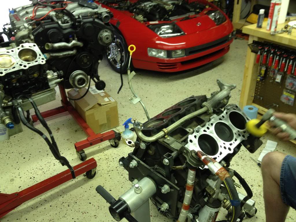

and I still had the original 42,000 mile engine on a stand.
So I pulled the heads off of it and put the original short block back into service.
