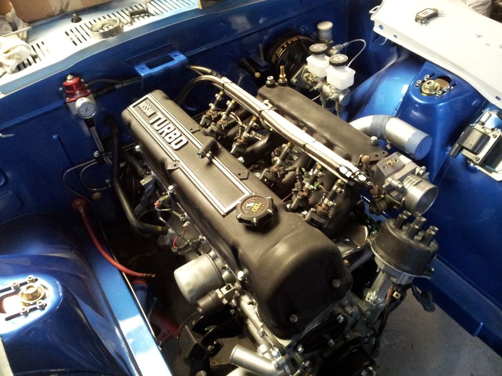

Message I set the parts in the oven before spraying them, did it in a few coats, and put them back in the oven. They came out pretty good, the engine hoist chain kinda rubbed some of the finish though when I was installing the engine. Any pictures of your end result? Mine looked like normal slick paint as well before I did it this way.
