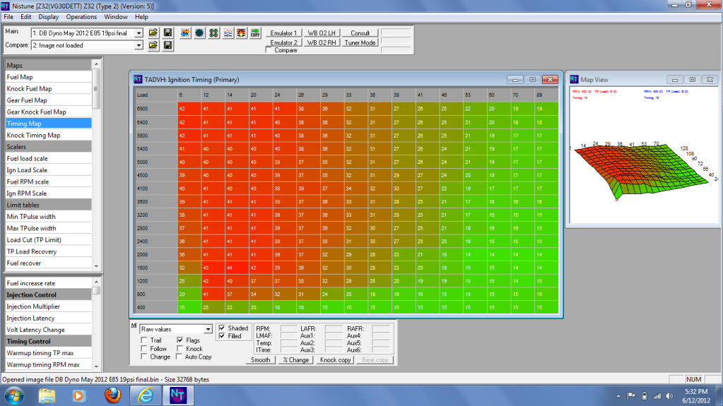

Here is my timing map for my recent tune since some of you asked for it.
Timing Map for stock turbos with e85 -

nice thanks. (n/m)
nemo1080 (Iowa)
22:50:08 06/12/12
that was from your pump gas tune ? Seems to low for E85 (n/m)

2nd, looks a lot like a pump gas tune. (n/m)

Re: that was from your pump gas tune ? Seems to low for E85

Here is my pump gas timing map

Uh, 98% of it is the same map...

have a hard time believing the power numbers with that map (n/m)

2nd...looks like a 93 octane map to me (n/m)

need at least 7 more degrees to really start using E85..

hum...

yup yup (n/m)

ramp rate... (n/m)

runnling lean alot? What is your fuel pump?
