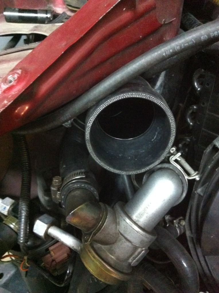

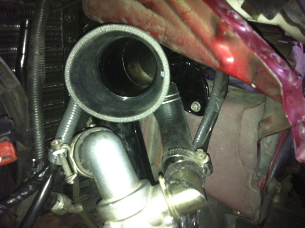

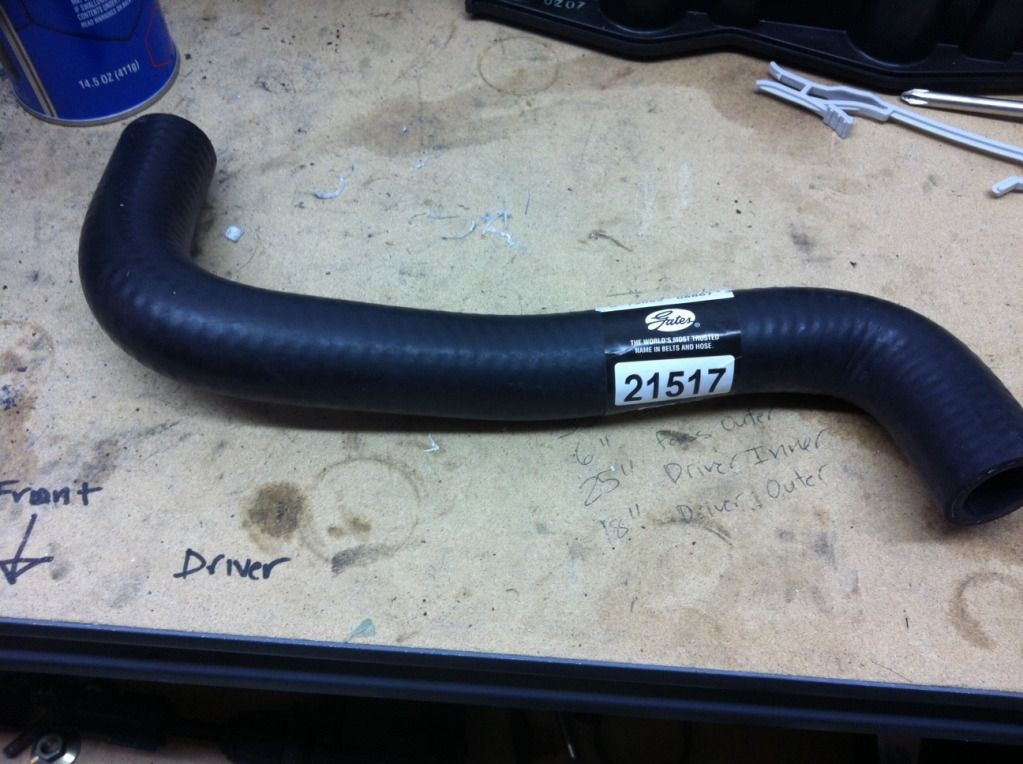

Today I finally installed my ashspec turbo inlet pipes and could not find a way to mount the recircs using oem hoses.

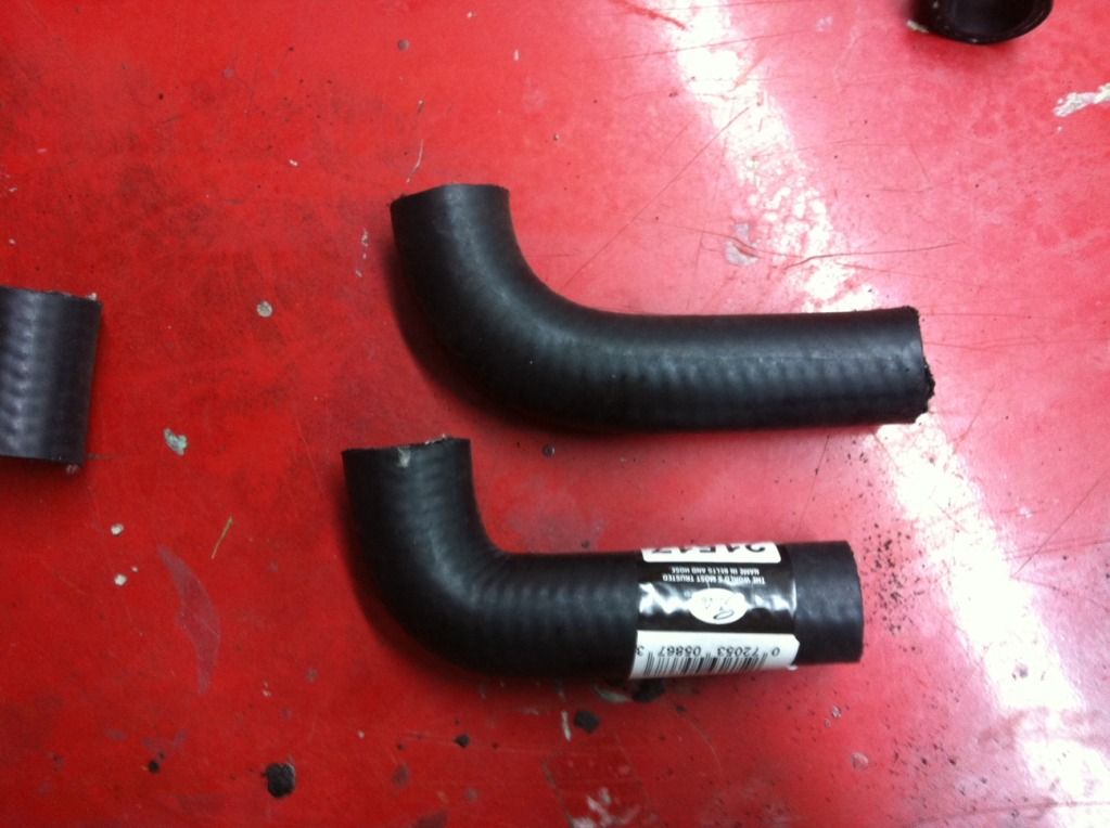

I went to O'Reilly's to pick up the gates 25253 hose that was recomended on this forum for the plumbing of the recircs. I didn't like the the flexibility of the hose...didn't seem capable of the tight bend I wanted. So I took a look through their hoses in the back and found what I think works well.
Gates 21517(about $16):
The two bends arent exactly the same from side to side but pretty close to being 90 degrees. After cutting in half and trimming the other ends a bit I had exactly what I needed for both recircs.

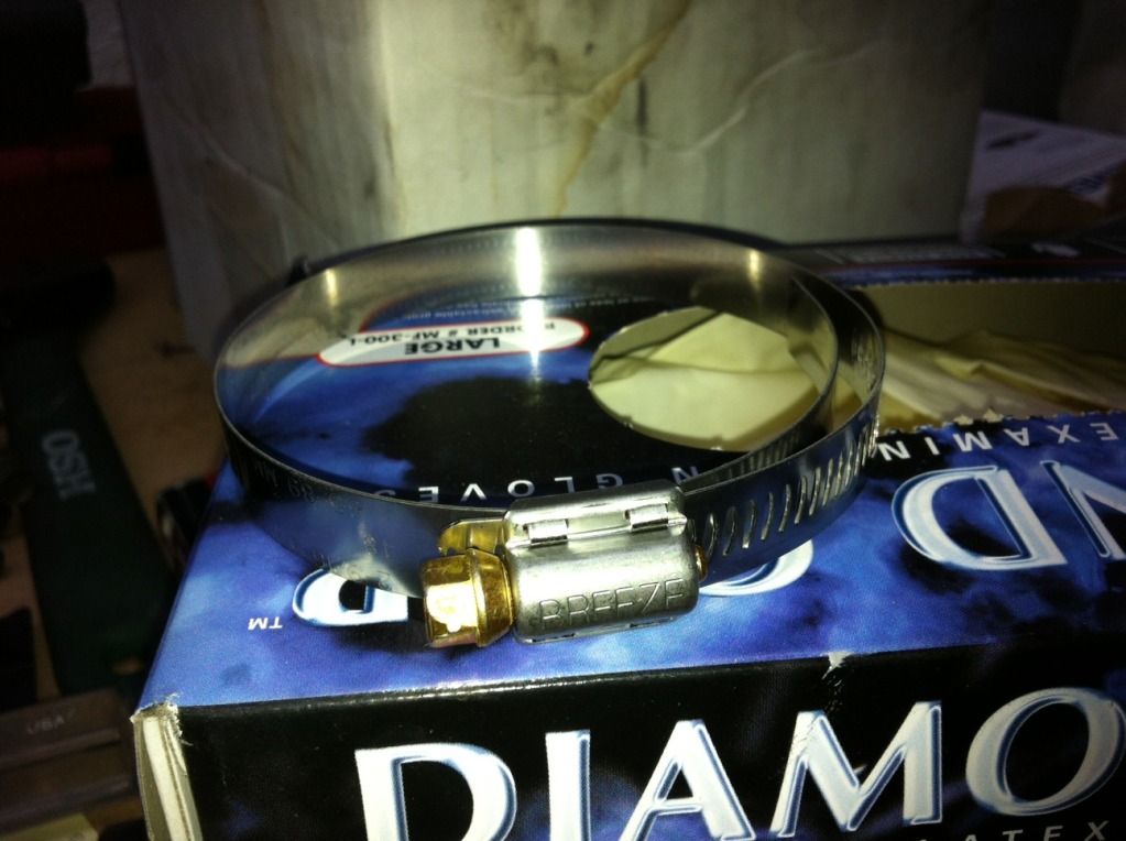

Bought a ton of these Breeze clamps that have a extra long smooth band on the inside that prevents the couplers from getting chewed up. I'll be changing out the normal worm gear clamps that come with all of the ashpec pipes with these.

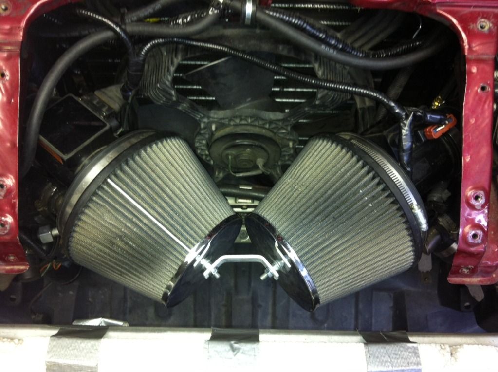

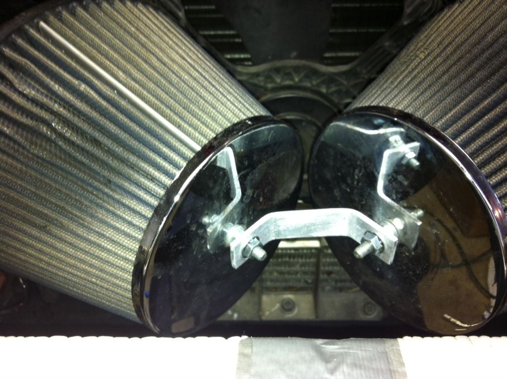

Made a little bracket to keep the filters spread and prevent rubbing of each other.
