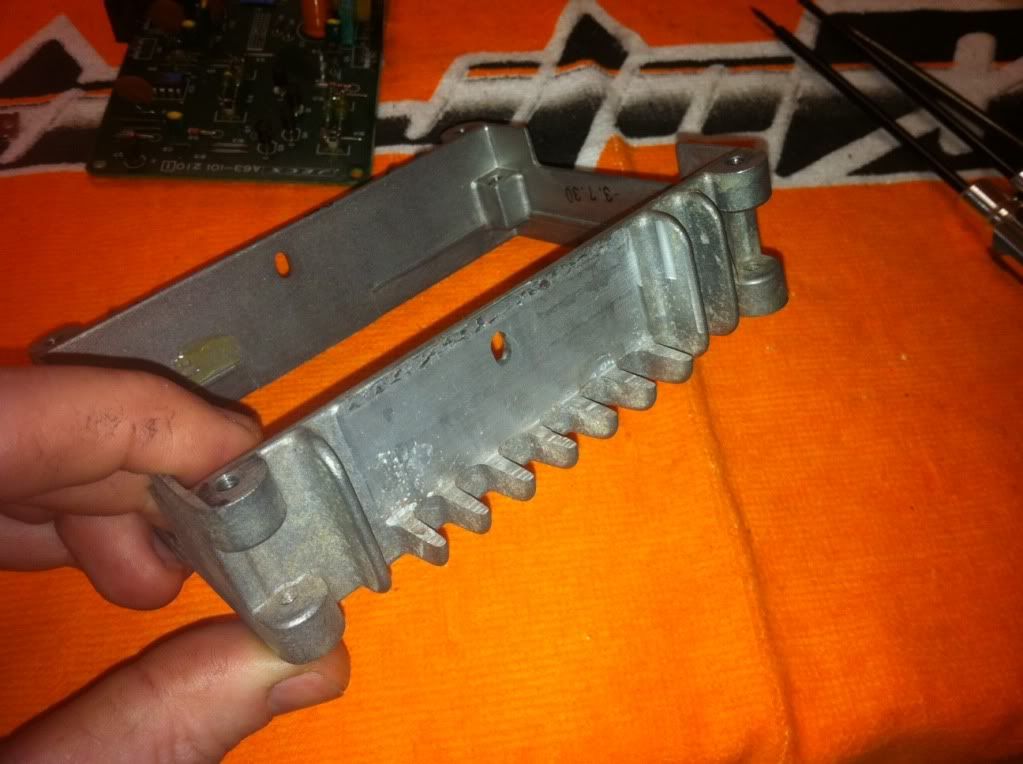

Message Here you go guys, this is how i mounted and setup my twin 400's for my single turbo E85 build.

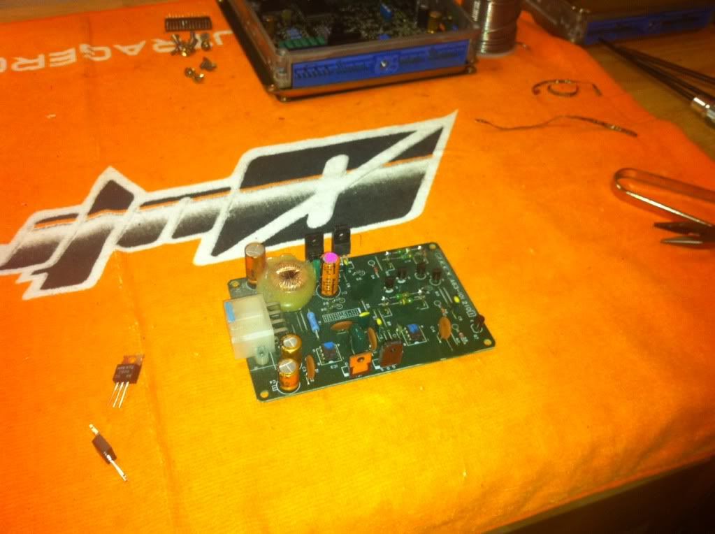

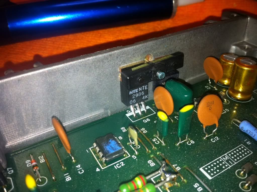

Also included are a few shots of how i changed out the fuel controller transistors, the old stock transistors will pull around 20amps. at this amperage the transistors will run on the hot side.

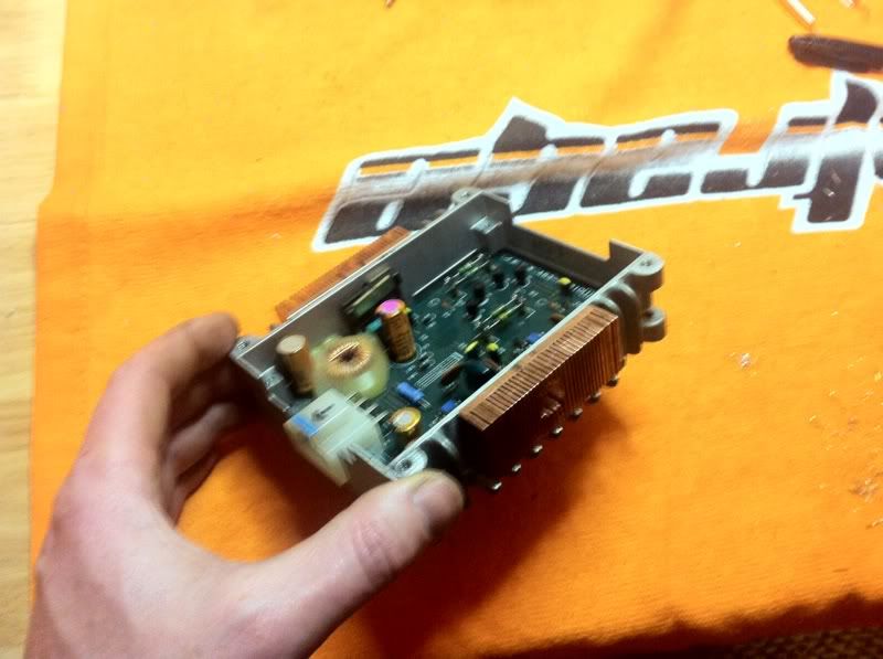

Nissan designed the aluminium case that houses the circuitry to act as a heat sink dissipating heat from the transistors.

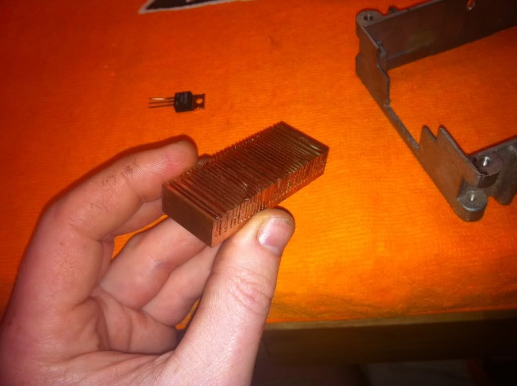

I basically machined the old fins away and installed huge solid copper heat sinks on either side (way over kill)

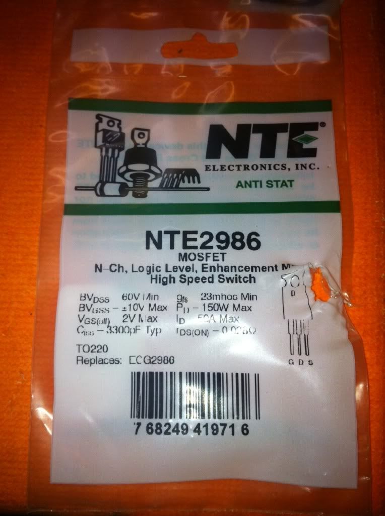

I then proceeded to install 50amp transistors.....good to go for the 400's
