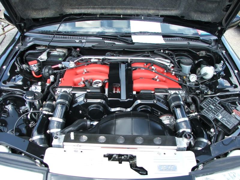

My 2.5" IC piping install and recirc modification.
Woody75 (Denver)
23:17:24 08/05/11
Nice work on the recircs. I don't have external oil cooler
zgene4
23:32:52 08/05/11
nozzles>
zgene4
23:47:00 08/05/11
We're doing them @ 45-degrees now.
Ash's Z
12:43:09 08/06/11
Or like this Ash...lol
Zski
12:46:10 08/06/11
I like the new angle! More direct path into the TB. -
Mr.Stacy
16:57:42 08/06/11
Nice, but you can't polish a turd. The Snow nozzles are
zgene4
17:08:59 08/06/11
Yeah, I'll be using the boost reference ports.
Woody75 (Denver)
09:51:52 08/06/11
My SZ pipes are modified the same way. I agree, the
zgene4
11:00:12 08/06/11
That's my only concern.
Woody75 (Denver)
11:24:57 08/06/11
what threading do the Aqua Mist nozzles require?
zgene4
11:51:40 08/06/11
Pretty small.
Woody75 (Denver)
18:40:53 08/06/11
Can the aquamist nozzles...
90GoldZ
20:52:57 08/07/11
No, they use a 1/8" hose. Snow uses 1/4"
Woody75 (Denver)
22:45:35 08/07/11

Very clean! I'd copy you but I have the ashspec inlet pipes
Wright (Ca)

Good job... have you fitted the IC ducts & fascia back on?
vorpalZ
08:56:20 08/06/11
I dont have massives.
Woody75 (Denver)
09:43:11 08/06/11

enlarged throttle bodies too ?
TTkeeper
11:13:50 08/06/11
I have the Stanza 60mm mod.
Woody75 (Denver)
11:22:10 08/06/11
What are the ports on the EGR block offs for? (n/m)
thumper
11:36:26 08/06/11
Vacuum signal to recircs would be my guess. (n/m)
zgene4
11:53:47 08/06/11
Correct. (n/m)
Woody75 (Denver)
12:17:37 08/06/11
