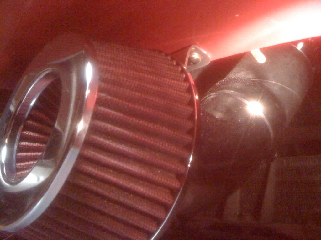

Here's a photo taken of the Mock-up phase of building the Dual Ram Air Intakes (yes I used a cardboard Mailing Tube for the mock-up)Notice that the Parabolic Section Velocity stacks are not installed yet (see the chrome ring on the front of the air filter?):

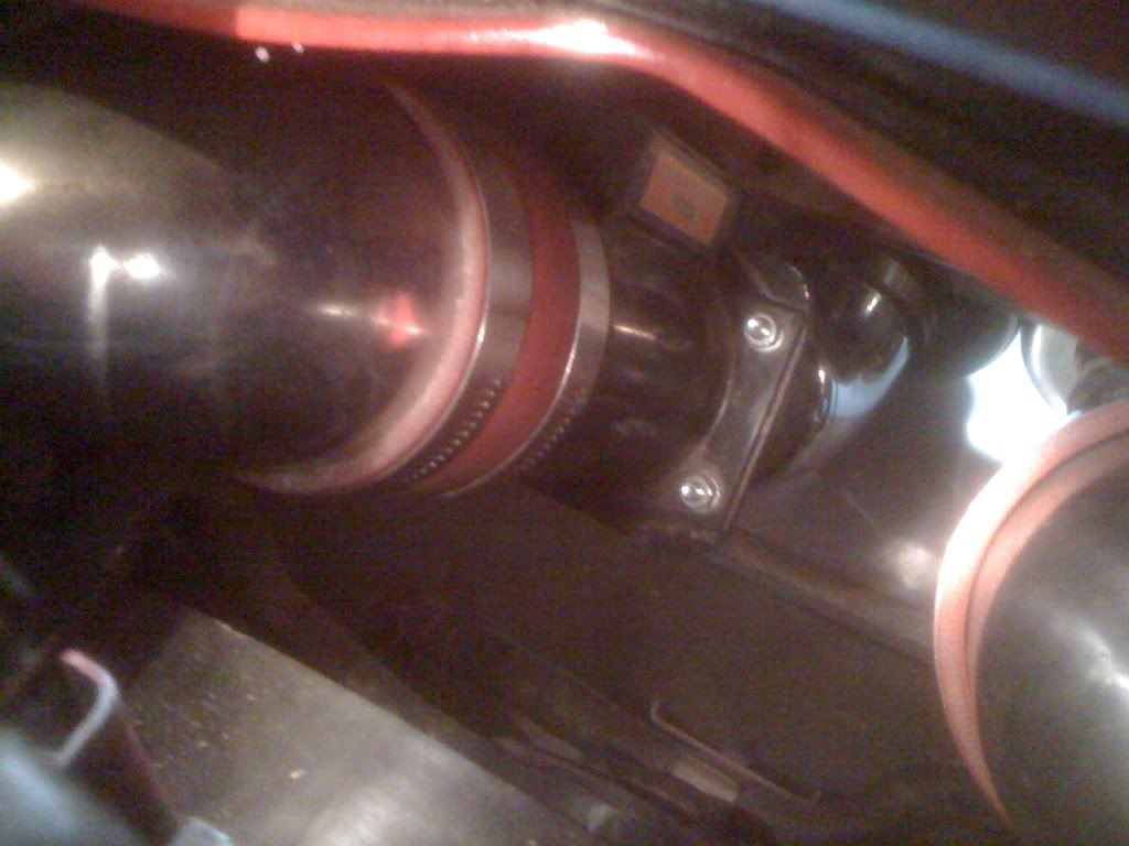

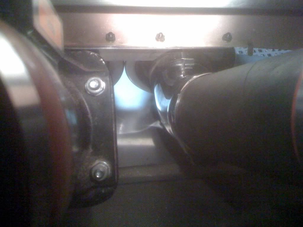

Here's a shot of the LH intake mock-up with the MAF installed,
You can see the honeycomb stiffened Horizontal Closeout panel in this picture also:
Both sides mocked-up:

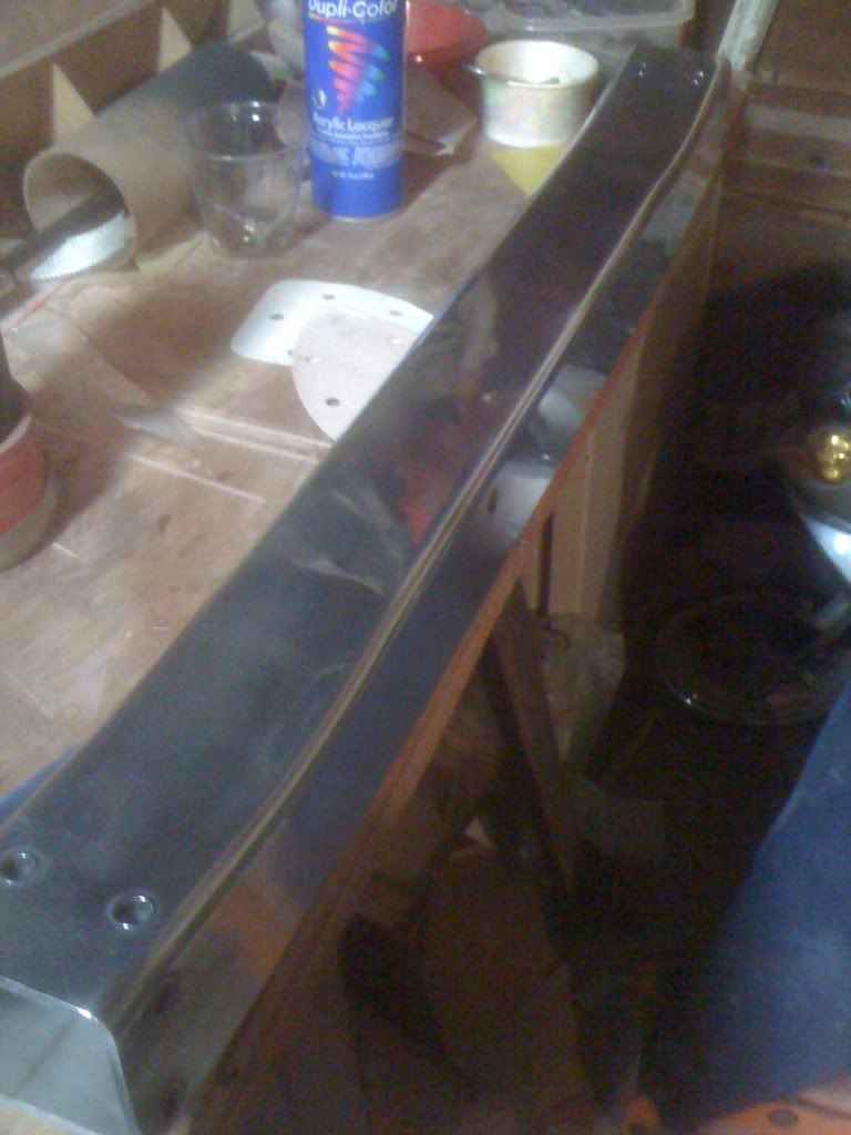

Polished front bumper:
