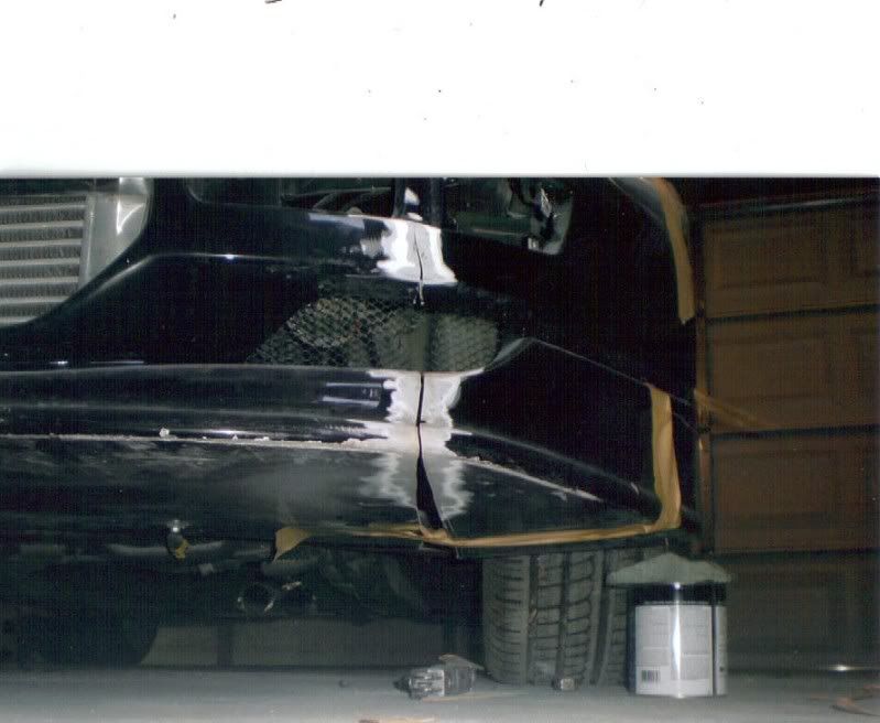

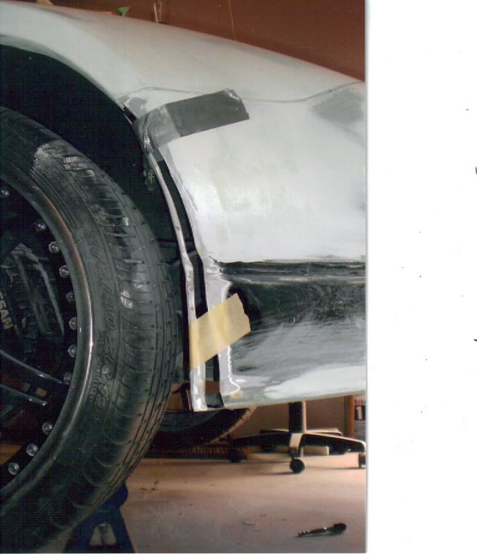

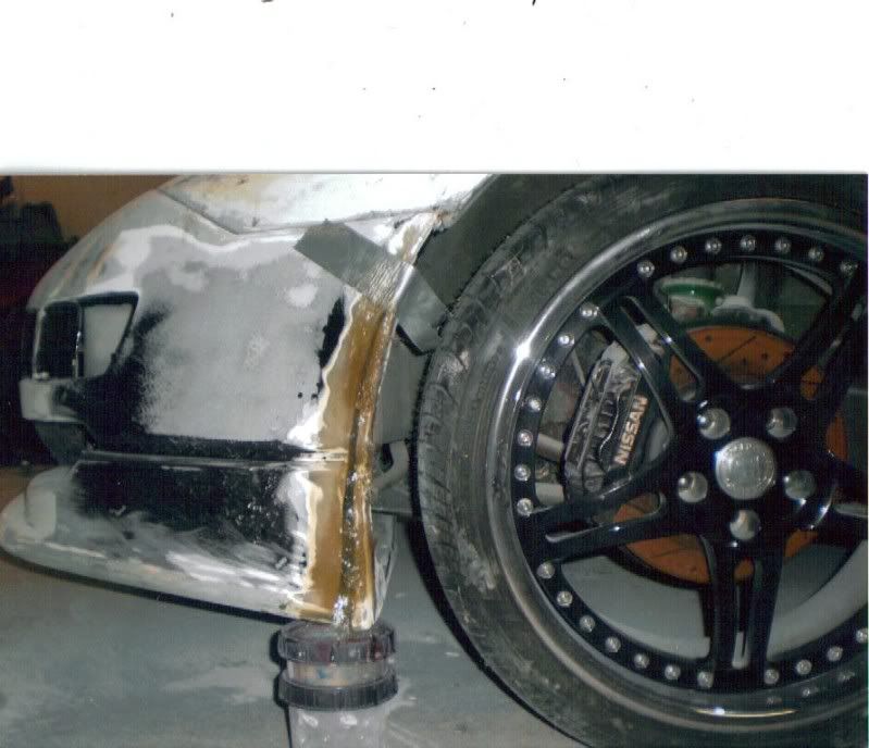

Message Here are a couple pics that I got sent to me..
I apologize about the quality.. they were regular pictures, which I had to scan..

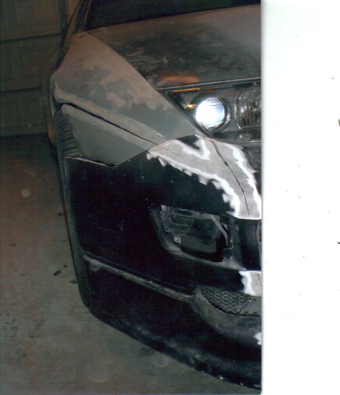

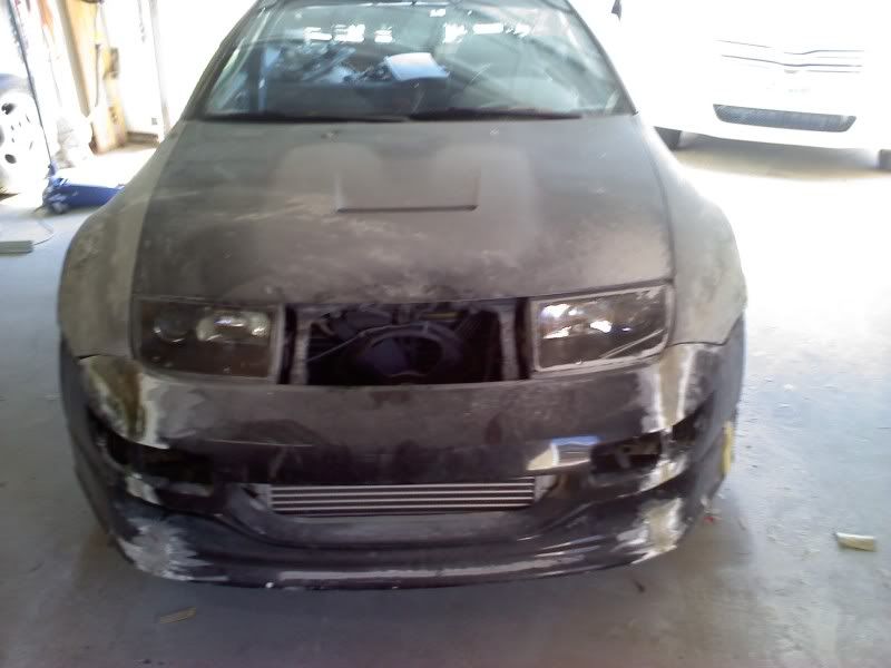

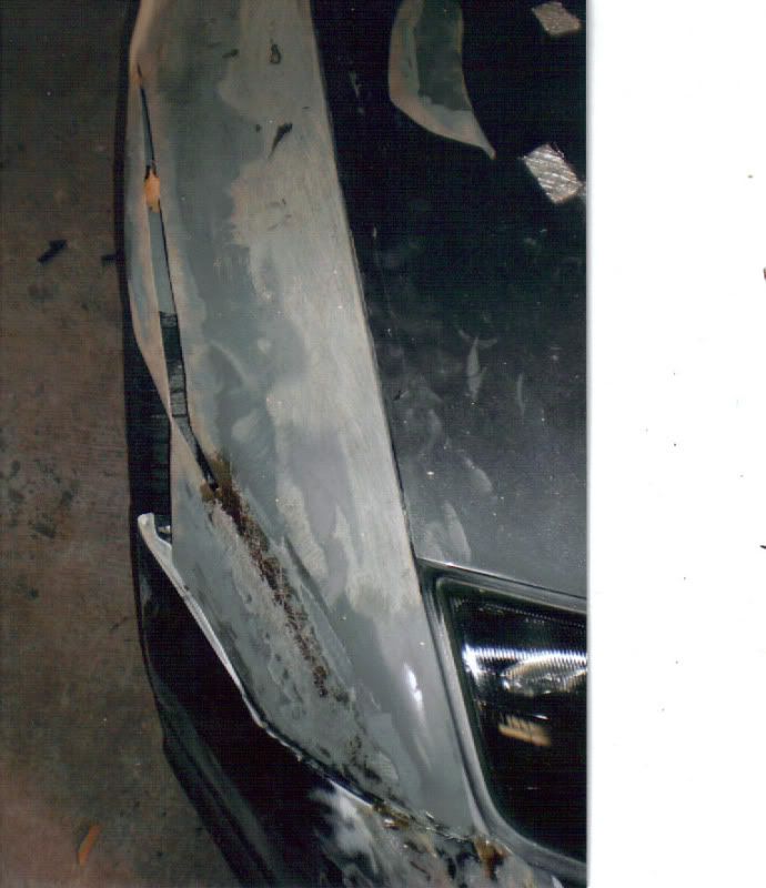

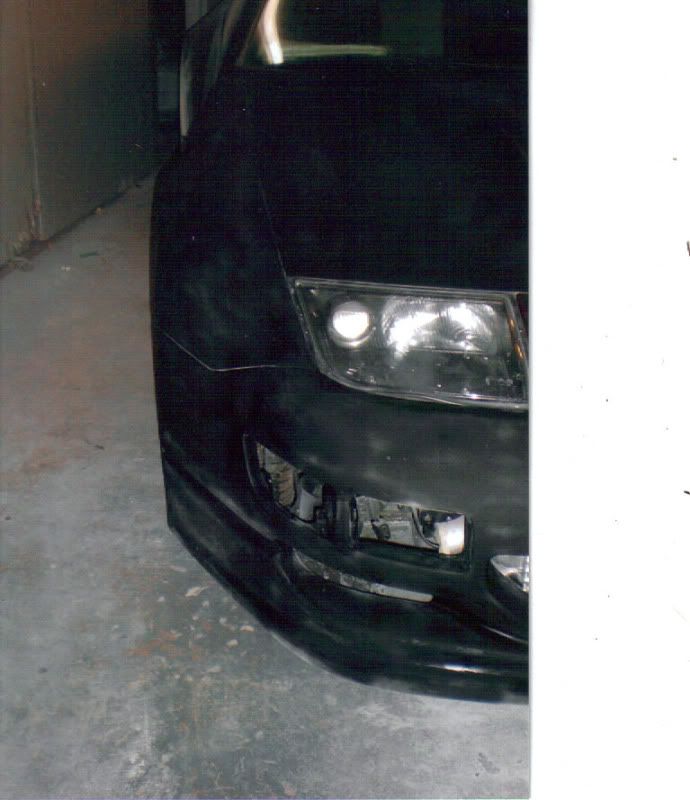

These are some pictures of the front end being widened. I have the Escort FRP front fascia and SPL style 20mm wider FRP front fenders.

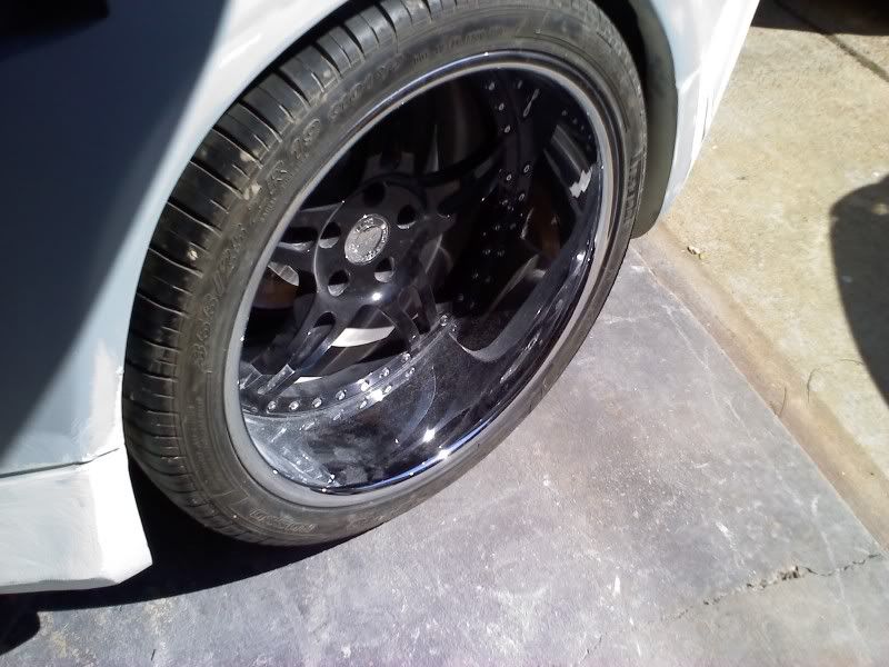

The front wheels/tires are
275/30/19
19x9.5" wide
+24 offset

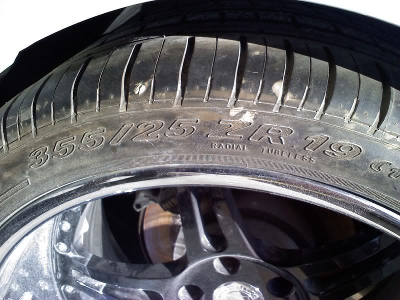

Rear wheels/tires are
355/25/19
19x13" wide
-24 offset
Both are Pirelli Pzero Rosso tires

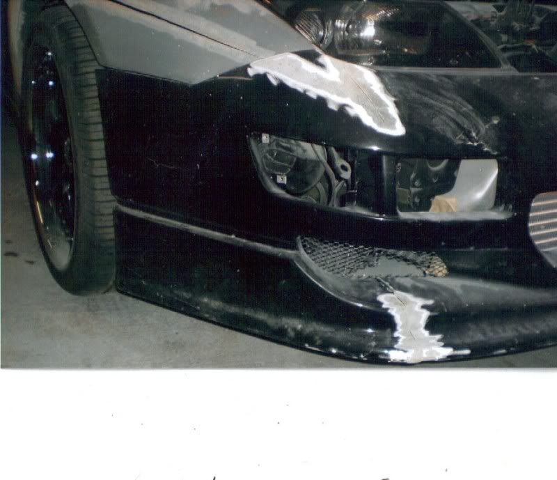

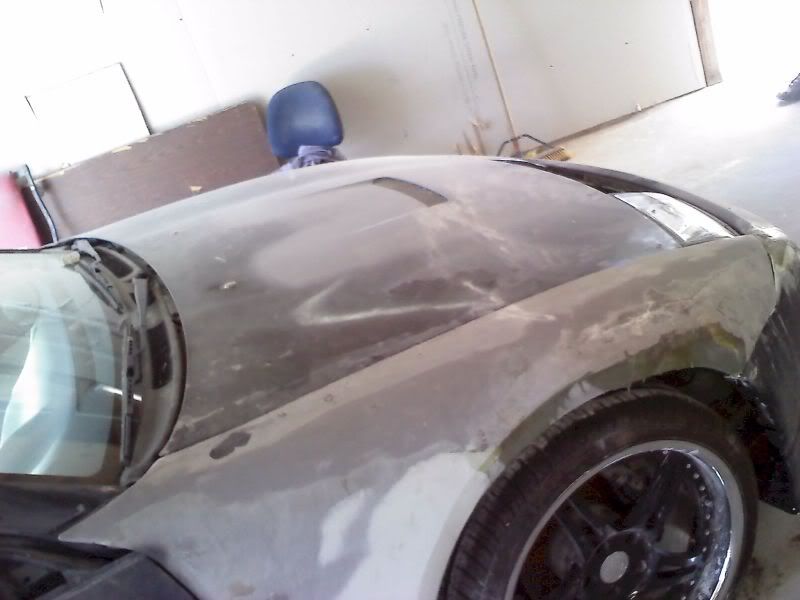

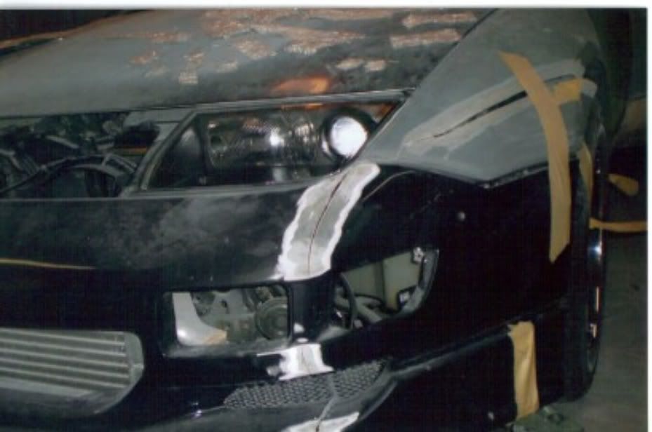

I got the fenders cut and modified to match the wheels flush.. The front fascia was also cut to match the fenders so there isn't any weird looking lines or transitions.
I believe the front is about 1.5" wider per side. The SPL style fenders alone were 20mm wider~ 3/4"... then it got modified a bit after installing those.
When I make a trip back to look at it.. i'll get some good pictures.
Please excuse the brakes.. :)

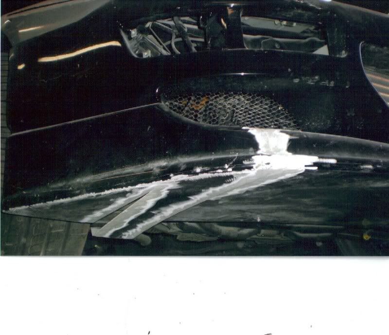

Since the Escort front fascia has the bottom diffuser/undertray, all this needed to be cut as well.. then reinforced and sanded smooth.
These pictures really do not show much detail.. When I last saw the car in person.. It actually looked very good..

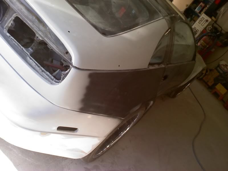

The rear was pretty much done (all metal), however; I have made some changes and need to go down and install my rear camber arms to make the rear wheels sit completely straight so we can get a better idea and re-do the rear again..

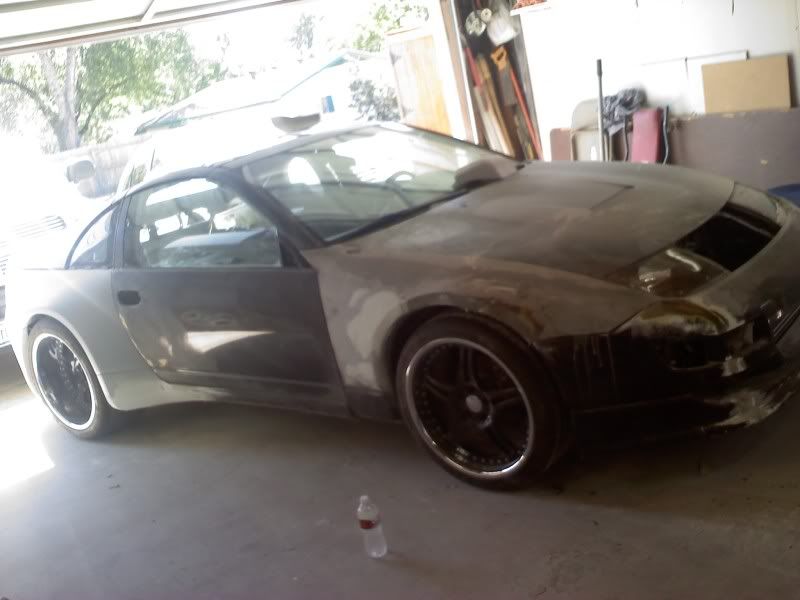

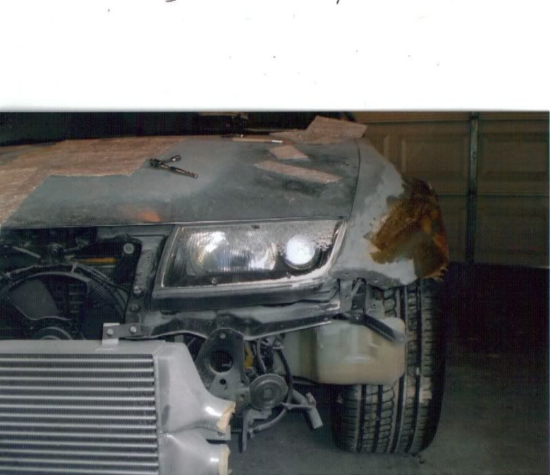

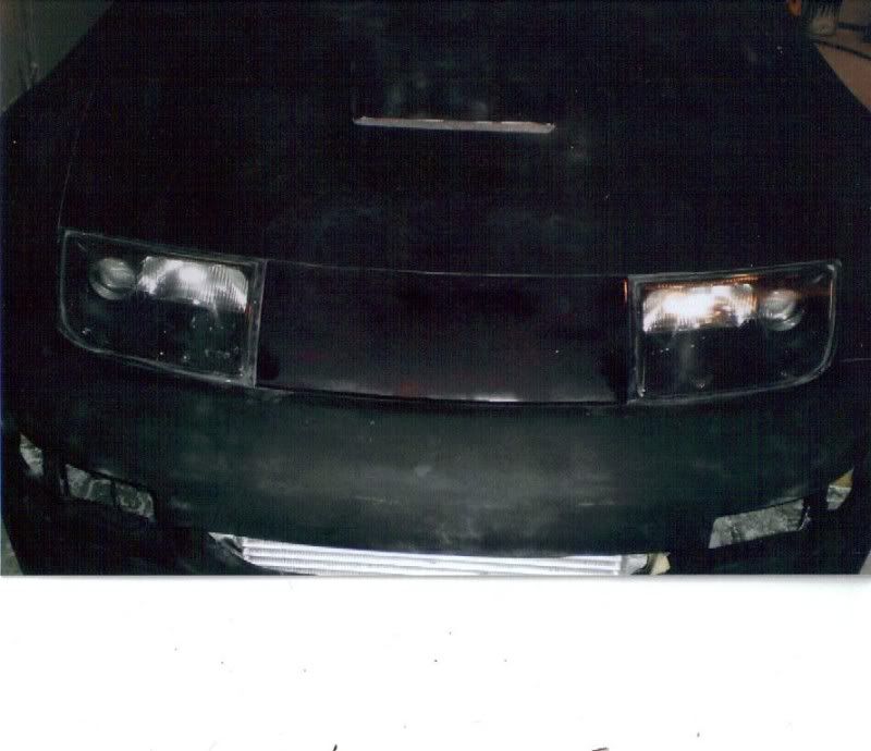

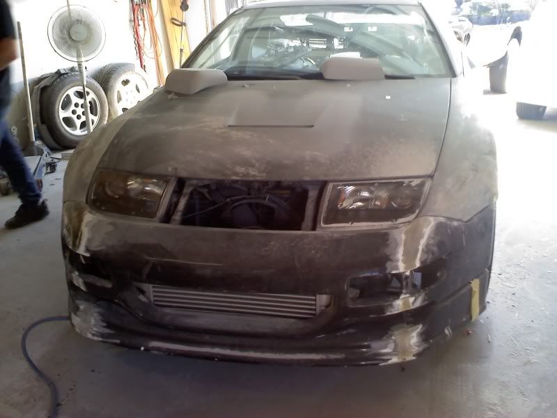

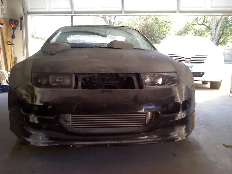

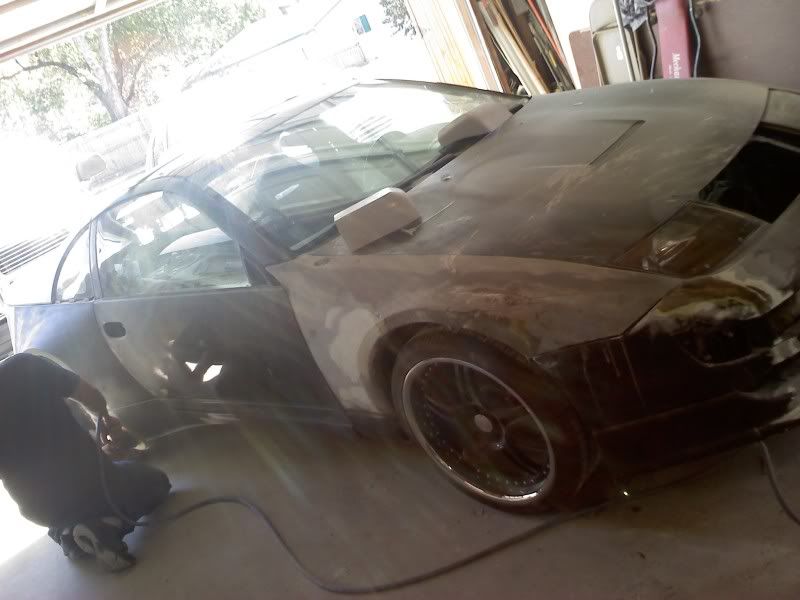

Here are some other pics I have of the car that I took with my digital camera and are alot better quality.. this was while the front end was still in progress.
The hood was custom done by the guys who did "SpeedyZX's " hood . Its a stock aluminum hood that is modified. I also had the windshield wiper nozzle holes welded shut.
