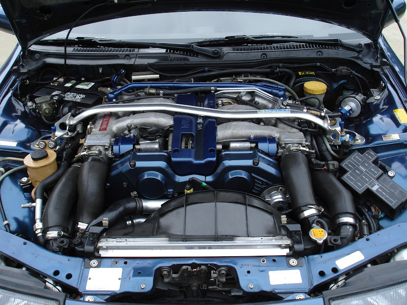

At this point my blue Z can't wait for it's new heart.

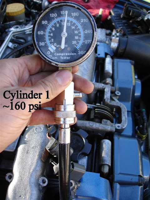

The engine started up and ticked for a min and then sounded smooth. I compression tested the engine as soon as I got it running. Awesome! 160-170 on every cylinder. I drove it with cats on for a awhile and it was burning oil.

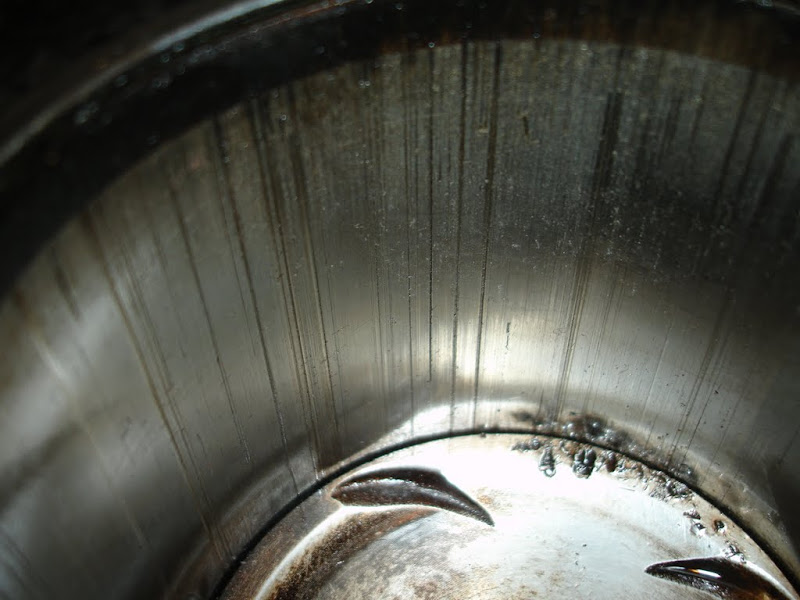

I pulled the engine again a week after I installed it. Dissembled the engine and removed the heads.
Every cylinder looked normal until I looked at cylinder number 1.
Funny because only a few days prior I compression tested it and it was right on spec.
I sent my block and heads to a local machine shop. I had the heads checked and the valve guides were all bad so we replaced all 24 and another set of valve stem seals and a multi angle valve job was done. The block was fitted with 88mm wiesco pistons etc.

My engine is back in and is running great with no smoke.
I'm happy!
