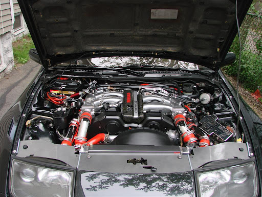

It fits perfectly and secures my Koyo radiator without issue. I used some slit 4mm silicone hose between the pieces and the car to prevent any chipping.
I did not use the two holes on the wing pieces. You're supposed to drill into the cross bar and put some screws in those holes. I didn't bother and it's plenty secure. I think I read a horror story of someone years ago who did drill and went too far and hit their headlight harness. No thanks.
