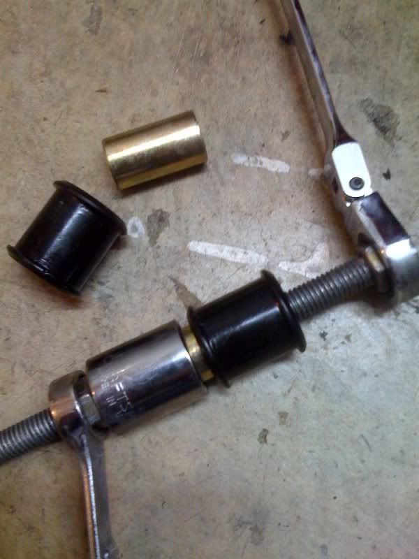

Message Basically the es bushings(control arm ones atleast) are surprisingly hard to install. They always slip to the side while trying to press them in. To help them keep their form install the inner sleeve half way into the bushing. Then use something large enough to fit over the inner sleeve to press on the bushing (I used my 1/2" sockets). Once you get the large lip of the bushing started remove the metal sleeve and press the bushing all of the way in. Then you can go ahead and re-install the metal sleeve the rest of the way.
This is the method I used to press the new bushings in.
