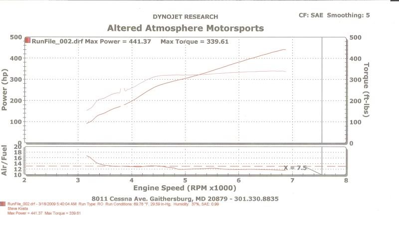

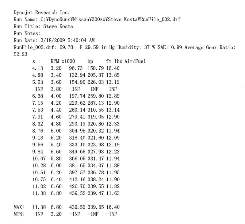

Message This is the first time I've ever had my car on the dyno. I guess the results are ok since there's a lot of room for improvement. I need to get the timing covers off and adjust the cam gears first thing, and am considering having the chip retuned by Specialty Z or someone. It looks a little bit lean and this was done on wastegate pressure of 15 lbs, EBC off.
Also I'm definitely going to the BDE sprockets when its 60k time. That alone should make a decent difference across the board. My cams are zeroed right now.
