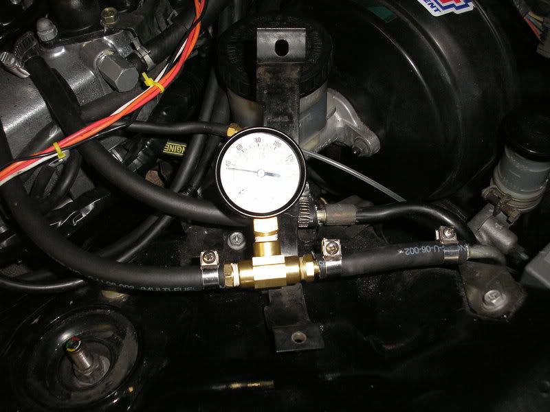

Message So I have been trying to work out some kinks now that I have the swap completed and I wanted to check and make sure my pump was feeding enough pressure. After finding that fuel pressure testers are around 60-70 bucks at the auto parts store, I decided to make this little piece for about $13.

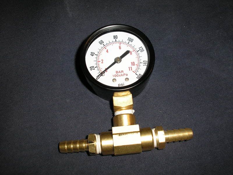

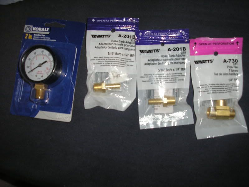

It consists of...

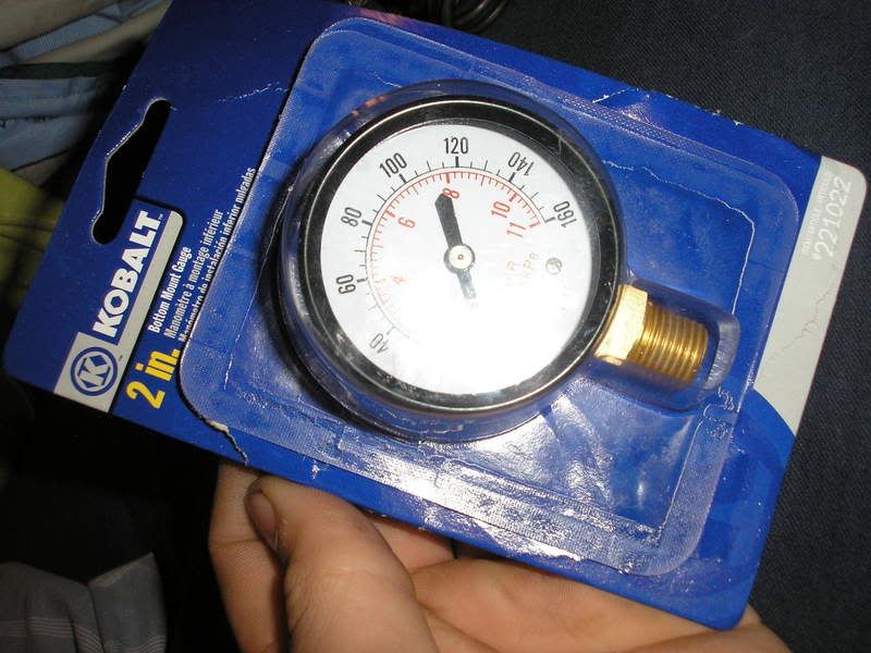

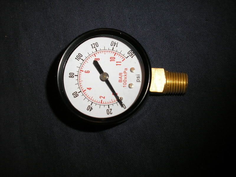

1 gauge (found in the air compressor section of lowes) It has a 1/4in NPT fitting
2 5/16" Barb x 1/4" Hose Barb Adapters (found in the plumbing section)
1 1/4" Female Pipe Tee (also found in plumbing section)

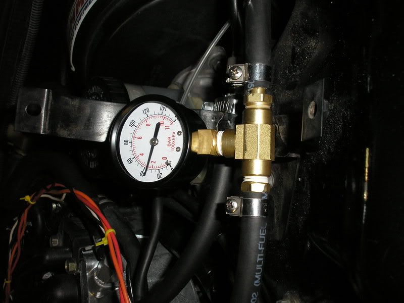

Heres the pictures of the parts and setup. I put it in place of the fuel filter to run my test, but say I were to leave it in all the time, would I place it before or after the fuel filter? My guess was after but just wanted to make sure.
