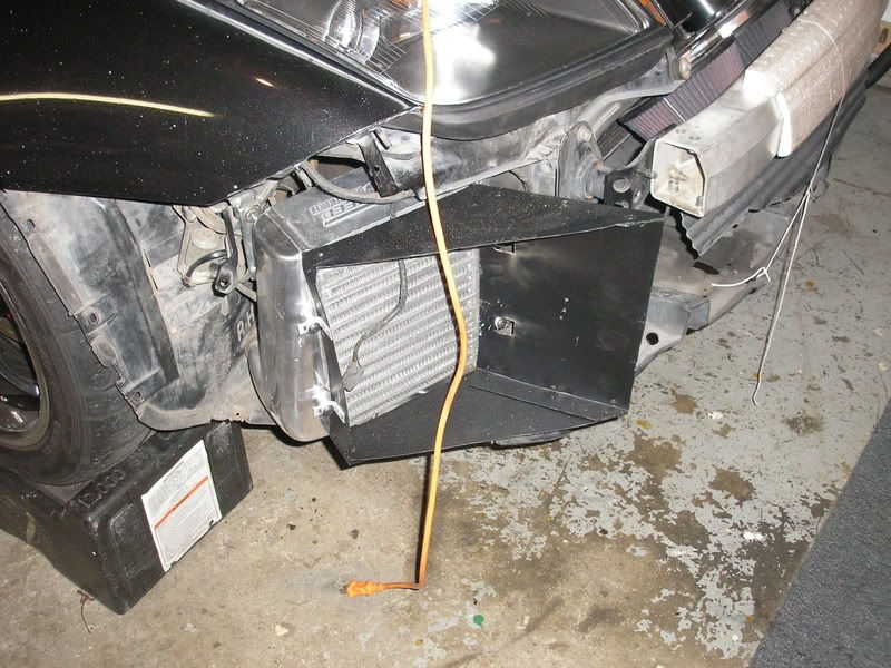

Message but it should be pretty straight forward when looking at the rear mounting point which can be seen in the pic, I just used a quarter inch thick piece of metal about 3" long with some holes in it to mount. The ducting I mocked up in cardboard and then made with sheet metal which I rivited and painted.
