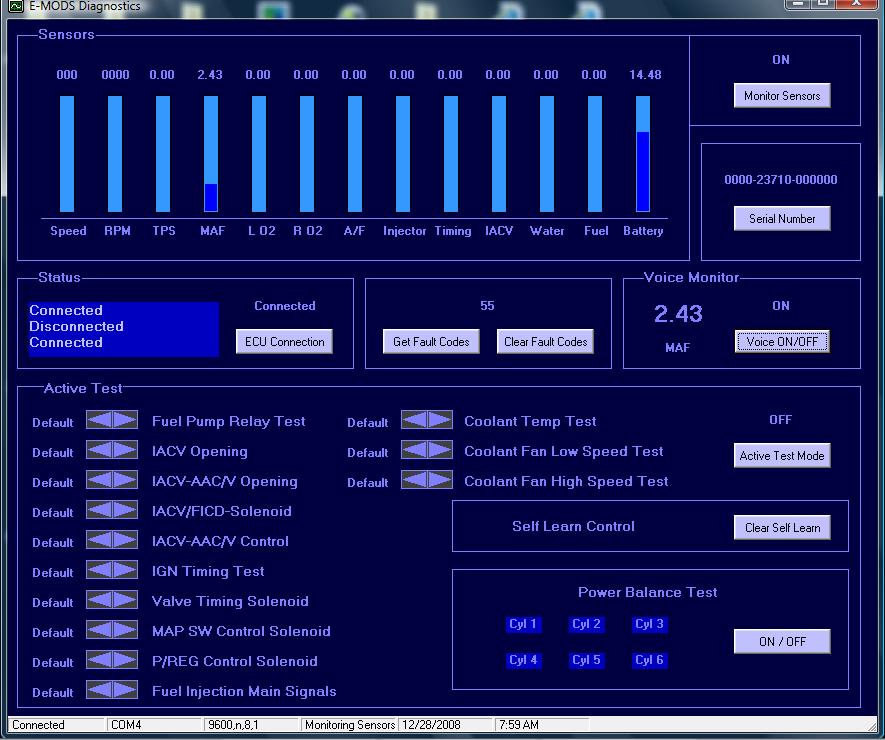

Message Off and on I have been working on creating diagnostic software for the Z. I have an ecu on a small workbench next to my computer for testing. Due to it not being in a car and not seeing all the sensors I can only show it working for a couple of things at the moment. I connected a variable power supply to the MAF input so I can demonstrate it reading the MAF voltage in the picture below. It can also read the battery voltage. One thing I wanted to do was to make sure the software would work with either the BlaZt or the ConZult interfaces which I was finally able to do. I do not plan on providing an interface with the software.

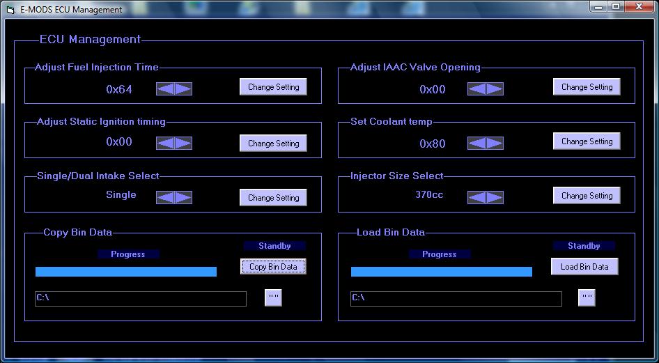

I have added some of the active tests and have also added the ability to download the bin data through the consult connector and save it to a file. I'm working on being able to upload all the necessary data which would normally only be done with a chip upgrade but without having to change the chip or open the ecu. Here are a couple of pictures of the gui.
