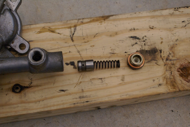

posted by fantomZ(OH)
on September 24, 2008 at 02:22 PM
I believe stock system will only send oil through the oil cooler at a certain pressure because there is a spring valve in the filter tree connection.
Here is pic of the valve:
Oil Cooler question
10:16:16 09/24/08

Hmmm..
Drk93TT
14:04:42 09/24/08
That's for the NA version. (n/m)
14:08:07 09/24/08

The typical oil cooling system on most cars is
AZHeat
15:43:52 09/24/08
this answered my questions.
fantomZ(OH)
15:47:32 09/24/08
