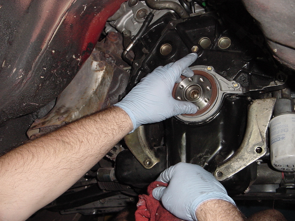

This:
Then notch the auto bushing and I used large pliers to work it out:

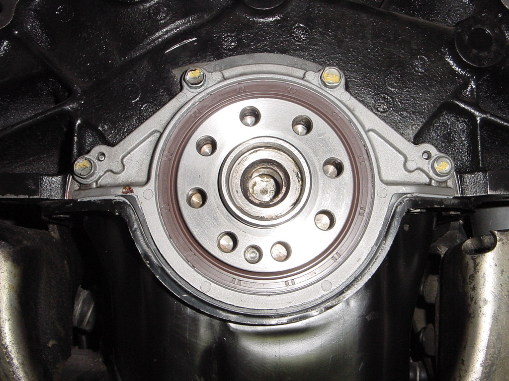

Will look like a 5speed then:
Replace the rear main seal:
Then install pilot bushing:

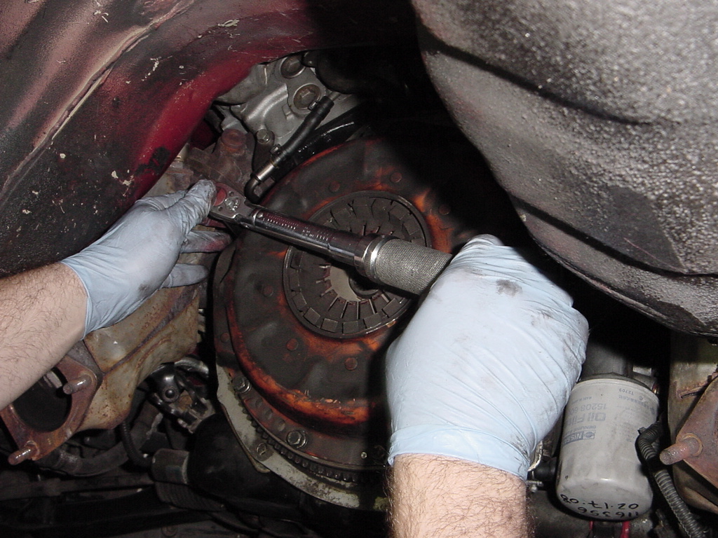

Then the flywheel & clutch:
Use all the 5speed hardware for reassembly.
