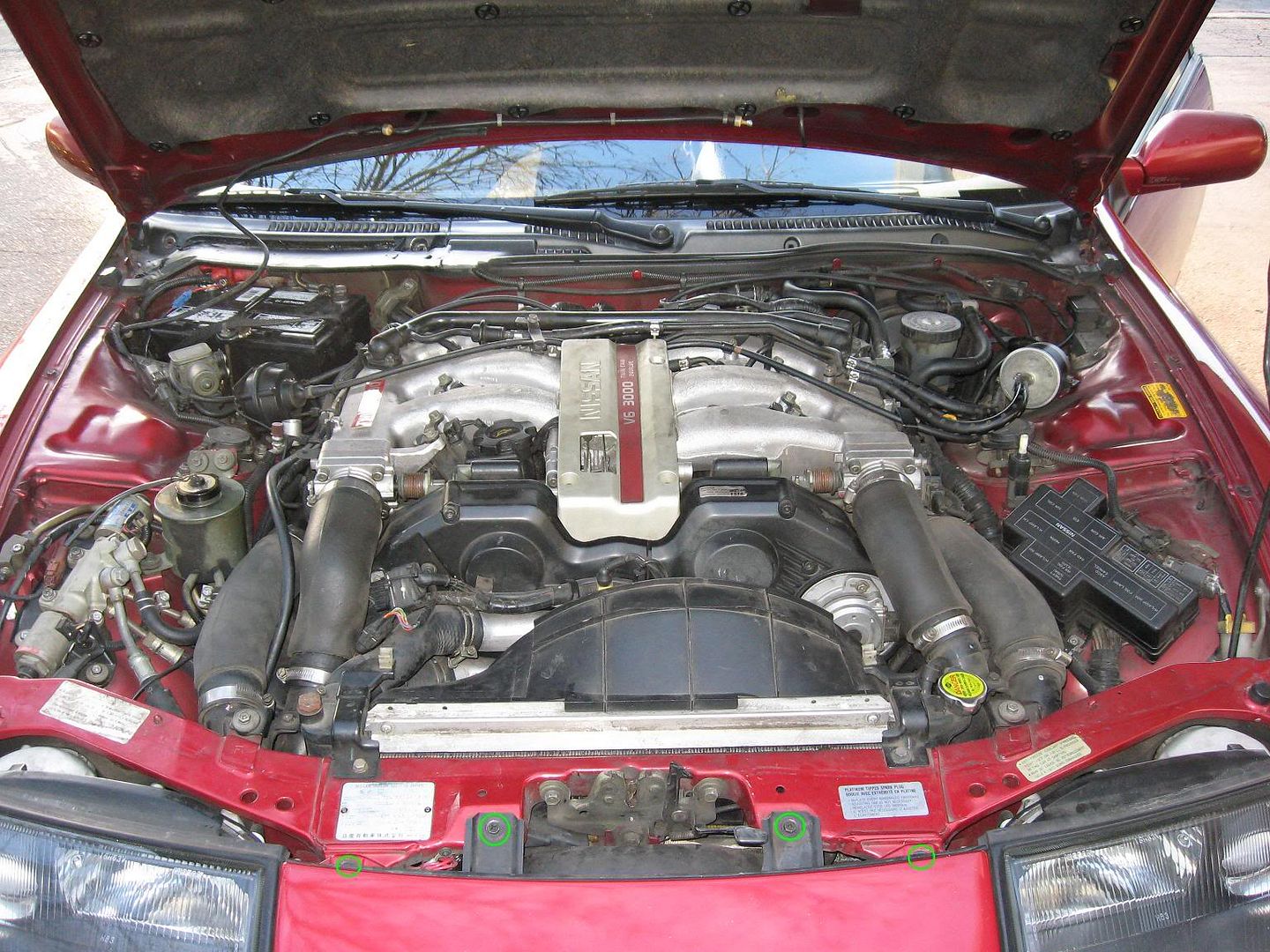

open hood, remove center bolts on top of nose panel (n/m)
550HPTT
11:49:25 08/09/08
Green circles. 10mm. -
Evan3zx(ca)
11:52:09 08/09/08
If its never been removed it should have bolts down
RedTTZ91(OK)
12:02:00 08/09/08
False. (n/m)
Barry (NJ)
12:03:06 08/09/08
3nd (n/m)
Halo Z
12:05:06 08/09/08
no, it has prongs going in, you just lift up.
rufflez
12:05:48 08/09/08
Well Hell, The only stock one I had was 2 years ago
RedTTZ91(OK)
12:37:06 08/09/08
Stock or aftermarket - still doesn't change the way its
07:03:03 08/10/08
Don't lose the little spacer things, they come off easy :( (n/m)
