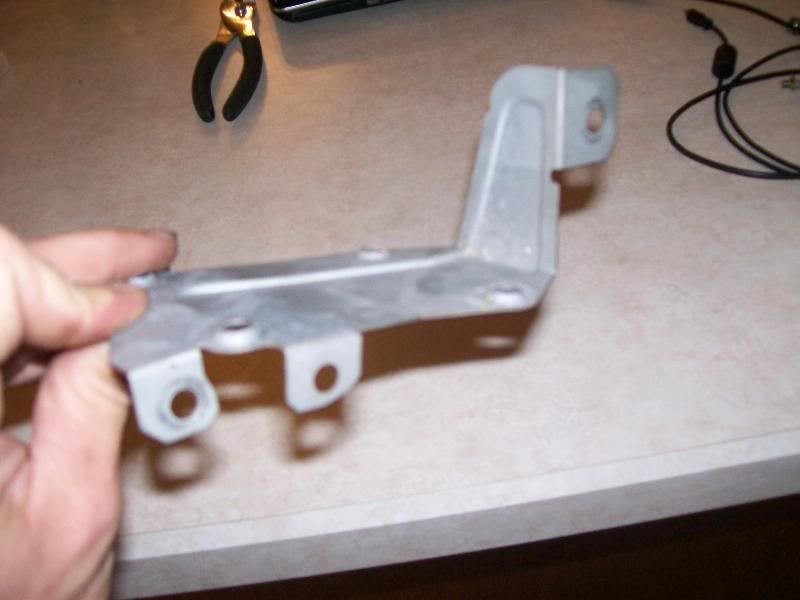

First I grabbed an old bracket that I mentioned above
I bent the inside mounting tab down, then later grinded it off.
I than flipped the mounting tab to the far right over to the left. After those steps it should look like this. But you may need to grind down the new made mounting tabs a lil so the timer can fit up to the hole, as you can see I did.
