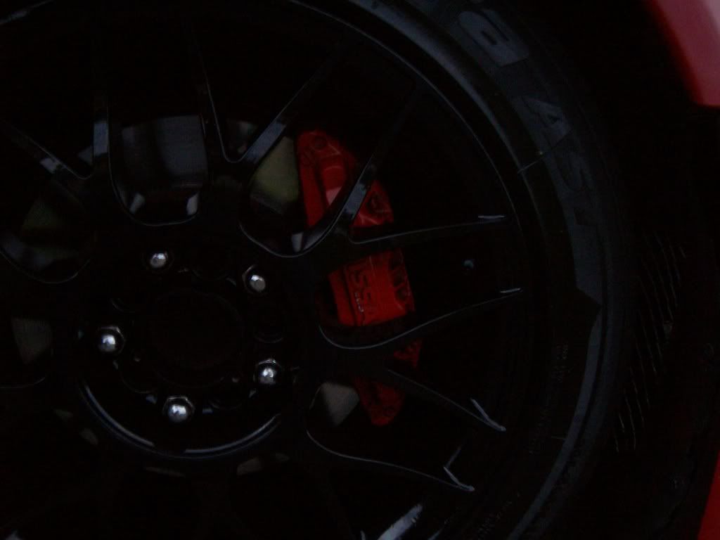

I have always wanted to do that with the 19s on. Painted the Enkies black (the reason I had the 19s on the car again) and they look a ton better.

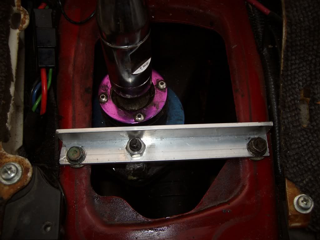

Since the last time I have made a post on here I installed the rear upper control arms as well to correct the camber. Turned out great, hooks a LOT better.
Last but not least after going through 2 shifter linkage mounts (both used but in good shape)I decided to make my own simple one. I figured it would give off a LOT of in car noise from the transmission but its completely quiet. The only noticeable difference is a clunk sound when you change gears because of how its bolted directly to the body of the car. It shifts a ton better now though. It shifts really smooth now at 7000-7500 unlike before. I sealed the hole around the shifter up with this really neat industrial thermal reflective material. It works great. No air or sound gets in through there, looks decent and is there to stay for a while given the tar like adhesive. Over all its a nice change, height adjustable, you can throw small rubber bushing to somewhat give it the same properties as OEM and you can always switch back to the original OEM one with ease.
