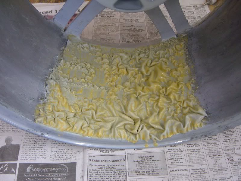

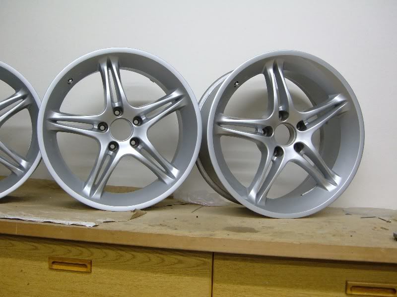

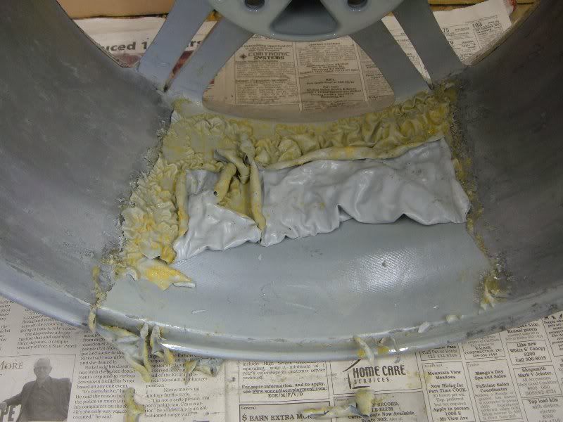

Message from hell if there is one. I used Klean Strip Aircraft Remover.

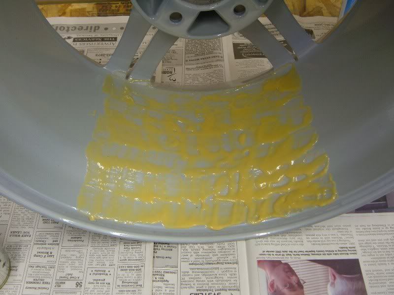

This stuff is good but if you are not gettiing the results you want regardless of the product, put the stripper on extra thick like this:
And don't hesitate to wait for it to work, like even 3 or 4 hours. Results like this are about as good as it gets AFAIK:
But regardless of similar thickness of application and time waited, results do vary a lot in my experience.
