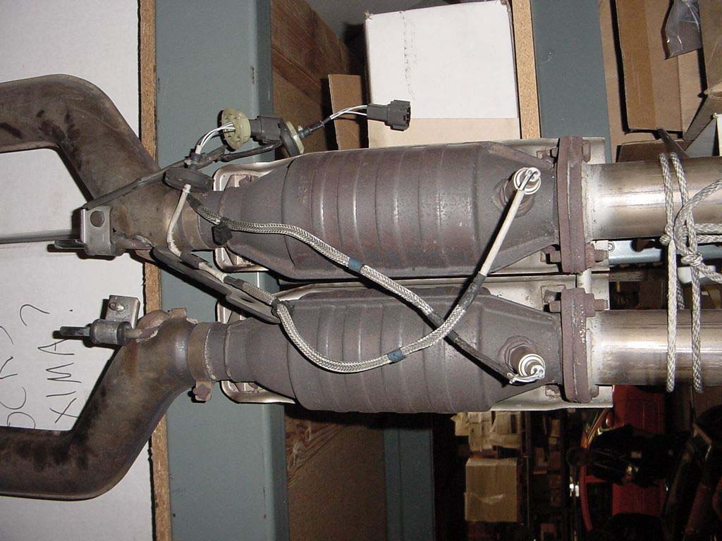

Message He has 4 02 sensors - the OBD2 system measures the in and out reading on the cats. Test pipes will cause a CEL since there is no difference between the 1st 2 vs. rear 2 readings.
The path of least hassle is for him to stick w. his stock cats. Add down pipes & a cat back.
