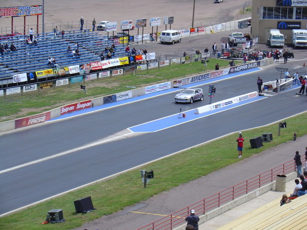

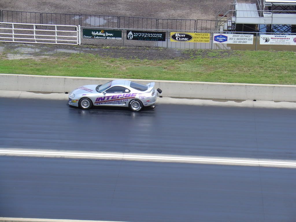

Although Titan Motorsports say that the problem occurs mostly in higher gears, there have been people who have broken their axles/diffs while launching. This is an MKIV Supra with a broken axle:
The launch.
The car then moved from side to side. As soon as he shifted into 2nd gear, one of the rear axles was destroyed.

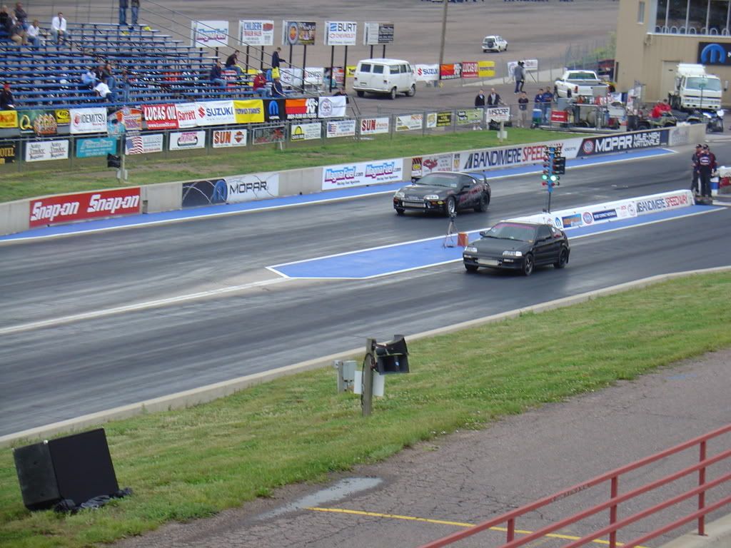

Both the silver and black Supra (pictured below) belong to Saad Saad, one of the well-known Supra guys. This event was certainly not his best, because after breaking the axle on the silver one, he broke the rear diff on the black one shortly after launch, in 1st gear (this one was a mess because there was oil all over the start line). This took place during qualifying. That same day he bought a used axle outsourced by Joule for the Silver Supra. After installing it, it turned out to be a bad axle and he asked Andrea (from Joule) for a $250 refund. Both of his Supra's supposedly put out 1000+whp (I am sure that the black one does). Here's a picture of the black one:
