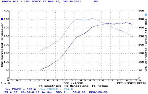

    I spent a lot of time reading stuff on the web about hp vs. torque. I think I have it all figured out now. Although I could be entirely wrong. :-)
    Here's my current dynochart for my mods:

    3. Find the torque peak value, most dynocharts supply this number. Mine is 356.8 in this chart. BUT I want to maximize pull in each gear, so I'll want to start each gear around 3500rpm. That's the front of my torque 'peak' which stays pretty flat across to 4800rpm. Now we want to work out the gear ratios to put us at 3500rpm after each shift.

    3. Gearing is a multiplier for torque, so even if the torque isn't as high chart wise towards the end, the gearing makes the mechanical difference & results in maximum acceleration. I'm just going to run down my chart so you can see how the process works, oh, here's the dyno chart again:
    Here's how it works out in a chart:

    4. 3.21 0000(000)000.00 is nothing, literally, but the next chunk is the first shift point: 3.21 7200(220)706.20 -> 1.93 4327(348)671.64 at 7200rpm, the chart shows 220ft-lbs of torque. OK, I know, it really doesn't... think interpolation for a sec. :-) I'm going to multiply the torque value by the gear ratio:
    220 ft-lbs * 3.21 gear ratio = 706.2 ft-lbs of output shaft torque
    5. Now we use the gear ratio finder from above to determine where this shift point will land us in the next gear:
    nextRPM = shiftRPM (gear2/gear1)
    nextRPM = 7200(1.93/1.30)
    nextRPM = 7200(.601)
    nextRPM = 4327RPM
    6. At 4327 RPM we see the torque is 348ft-lbs. Multiply this by the gearing:
    348 ft-lbs * 1.93 gear ratio = 671.64 ft-lbs of output shaft torque
    This is significantly less (34.57ft-lbs) than the amount of power we shifted from. Why shift when the ground is still feeling more force then in the next gear? But, we ran out of RPM to work with, forcing a shift into the next gear.
    For the next gears there's a lot of trial & error. I wrote a script to do most of the math for me, but it can be done on paper with a little more time. :-) The easy way is to start graphing the torque from redline back in 50 RPM measurements. These numbers can be used through all gear readings, just use different multipliers for gearing. Keep doing the math until you find a shift point where the output shaft torque is the same or slightly less in the next gear or as close as possible. The first shift had a 34.57ft-lbs difference, the rest you can hit very close in the next gear. The shape of the torque curve will determine how close you can get.
